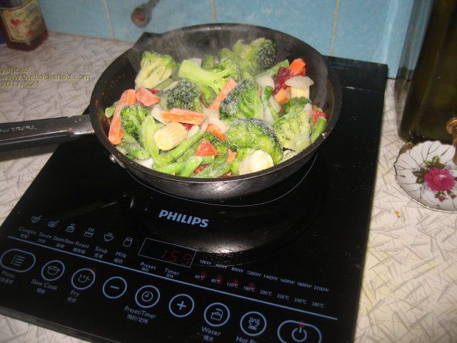

In the time it took me to grab my camera and take this photo this induction cooktop was already burning these frozen vegetables with the control set on 1200 watts, maybe 15 seconds, 20 seconds.
with it cranked all the way up to 2200 watts it will damn near burn water.
And that is what has really surprised me, I was prepared for it to break and stop working and I was prepared for it to struggle to heat a big pan, I wasn't prepared to have stuff instantly burn the second I stopped moving it around. There lies the problem, this little cooktop has 8 power settings and so far I have only been able to use two of them
400watts and 800watts.
the 100 watt setting is too hot for a gentle simmer with a lid on and it is too cold with the lid off.
The other 5 high power settings need a pan with poor induction to waste some power and dampen the heat down. That is essentially why these things dont work, a good cooktop is infinitely variable or at least has enough graduation to seem like it is.
I have noticed that the restaurant grade portable induction units are very similar to a laboratory hotplate, they are dual mode, they have very fine power control AND they have a pair of thermocouples to cook by temperature
one senses the bottom of the pan and the other can be placed in the top and these I suspect are driven by some PID thermometer code. The are also over $1000 bucks!
So these things may be technically more energy efficient than an electric hob stove but there are other ways of cooking that can do a lot better. I might try it with an induction wok and see what it does with that.

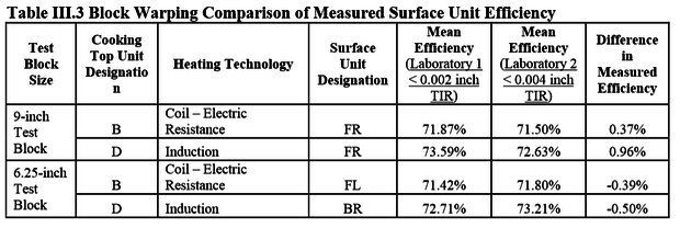

I really doubt if they are much more efficient.
I did a lot of googling on their true efficiency recently and of course there is a lot of advertising spiel from the sellers of induction cookers.
But reputable scientific testing doesn't seem to back this up.
I believe they are about the same efficiency as the resistance coil.

Without knowing more about what the actual lab tests did it is hard to comment.
In our last house we had a conventional electric hotplate cook top. When you put a pot of water on to heat there was a lot of heat radiated from the hot element and there was the additional step of the heat transfer from the element to the pan. In our new place we have a 4 zone induction cooktop. The heat is obviously generated directly in the base of the saucepan and the end result is the contents heat amazingly quickly.
From a practical point of view the heat lost from a conventional hot plate is far greater as you have a hot plate glowing red hot, radiating in all directions. In the induction case the heat is generated where you want it - in the pot. The cooker surrounds are only hot - boiling water hot - directly on the contact point.
The speed of water from cold to boiling in the saucepan suggests that the induction unit is better than a conventional cooktop.

This is an interesting experimental comparison -
DEBUNKING THE MYTH THAT INDUCTION IS MORE EFFICIENT THAN ELECTRIC COIL
Seems like for extended cooking, coil is more efficient,
whereas induction is faster and more efficient than coil for quick cooking tasks.
  Quote  efficiency isn’t everything. Induction still means quicker response, faster heating for short tasks, more accurate temperature target and timer controls, easier cleanup, and better safety since the glass doesn’t heat up as much as the coil.
On the other hand, coil is usually much cheaper and works with all type of cookware (not just those with magnetic bottoms).
I think coils would be more economic overall because they are so simple and seem to last me decades,
compared to the complex electronics of induction.
