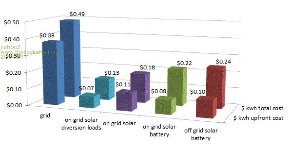

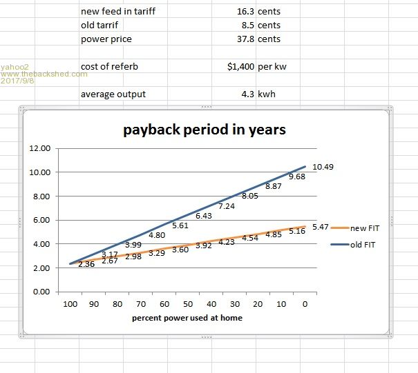

I was having a poke around at the new Energy made easy website and noticed that one major retailer had followed the lead of Enova and lifted their feed in tariff base rate to 16.3 cents.
Had a phone call this morning from someone asking if they should think about fitting more panels so I have made some assumptions and plucked some very rough numbers out of the air. We have to factor in what happens with renewable energy credits for upgrades and compliance with Australian standards changes since the original system was installed etc etc.
I would say if there is electricity that can be time shifted to the 10am to 4 pm zone that is normally imported then a reasonable amount of that sweet moola can remain in our hot little hand.
I wouldn't over-panel only to chase the $250/year/kw installed FIT if my power needs were already catered for, it equates to a maximum of 2.1 cents per Kwh reduction in the power bill.
PS the average output is low for my area because of the orientation of the remaining roof space available and some difficulty in matching panels.

Thats interesting thanks Guys,
I can only see what is being offered to the South Australian market on the SA power network.
I was looking at the non timed plans and some of the current offers from AGL show
38 cents (domestic peak)
22 cents (controlled load ie water heater)
fit
16.3 cents
supply charge
83 cents per day
I have had a look at a few others and their controlled load varies from 15 cents to 20 cents and the feed in tariff from 11 cents to 15 cents.
The other thing to keep in mind is that these plans are only fixed for a 12 month term so we need to be in the right frame of mind to put a few hours in once a year and look at a few prices and make a call or two and ASK. Sometimes there are discounts available that are not published.

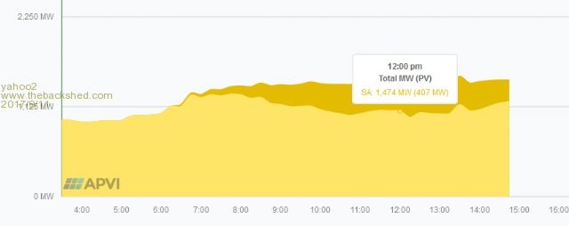

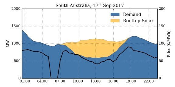

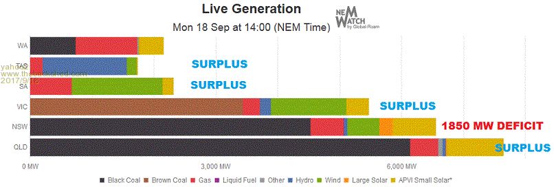

This is exactly the situation that I was thinking that Oztule's "artificial cloud" would really come into its own. It is that feed in limit that really stops people doing anything.
This is why I say that having a vocal and active community is important, its not the price that hurts, its the sneaky little restrictions. I have taken a couple of companies to task here about their policies and they eventually back down and let us install oversized systems provided we limit the export.
The trouble is the stuff I have used adds several thousand to the price.
I have had a play around with an old hot water service diverter and found I can get a signal that tracks the amount of power exported so that we can "hard limit" the power exported but still have a shedload available for behind the meter use.
If Ergon kick up about that we could go off grid with a tiny battery and a big inverter during the day and use a contactor to switch to the grid when power is not available behind the meter.
