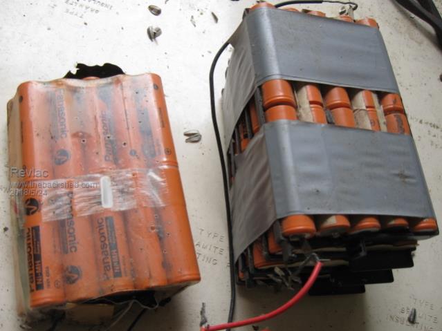

Well I have these Panasonic cells that were thrown out, apparently they get replaced after a certain time even when they are still good.
I have read many times that, many cells arranged in parallel will be less than the rated total amp hours compared with a single large cell or series arrangement.
But that really doesn't matter as we will work with the cells we have just don't expect the full amp hour rating.
(I hope that makes sense)
The one on the left is 24v 20 X 1.2v cell's
The one on the right is 12v I made up with 5 banks of 10 cells, total of 50 cell's they are a bit tired by now and will get used to run the electric fence soon.
I think it would be worth finding out how much amp hours is still available.

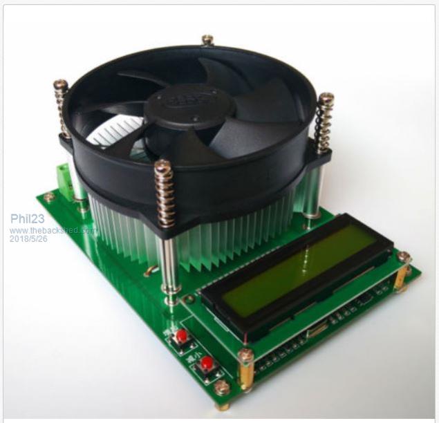

  Revlac said   I think it would be worth finding out how much amp hours is still available.
One of these is not bad for measuring capacity.
This one is a bit primitive, current is set with fine & coarse Pots.
Minimum voltage can be set etc, not perfect, but works.
It's well worth knowing though that there are others about that are more sophisticated, but most are fake copies of what was a very good unit.
I've got two of them also; their firmware is dangerously flawed.
After they disconnect, they will reconnect again when the surface voltage rises,
But, they reconnect at full load, 10A or more, whatever it can draw & then doesn't disconnect at all.
They will then stay connected indefinitely after that.
Managed to melt some hook-up leads here with one; testing a 9 Cell Li-Ion laptop battery I planned on robbing.
Vaguely recall I was pulling a bit over an amp from them & had the cut off set to 8.9V.
It was in my office & I watched it periodically, & heard the finish alarm, checked & wandered off.
Came back a couple of minutes later to burning & dripping insulation & just lightly burnt my palm ripping the wires off.
Anyway, one above, while a bit primitive, has none of the flaws of the fakes, which are well discussed in many places.
Phil.Edited by Phil23 2018-05-27

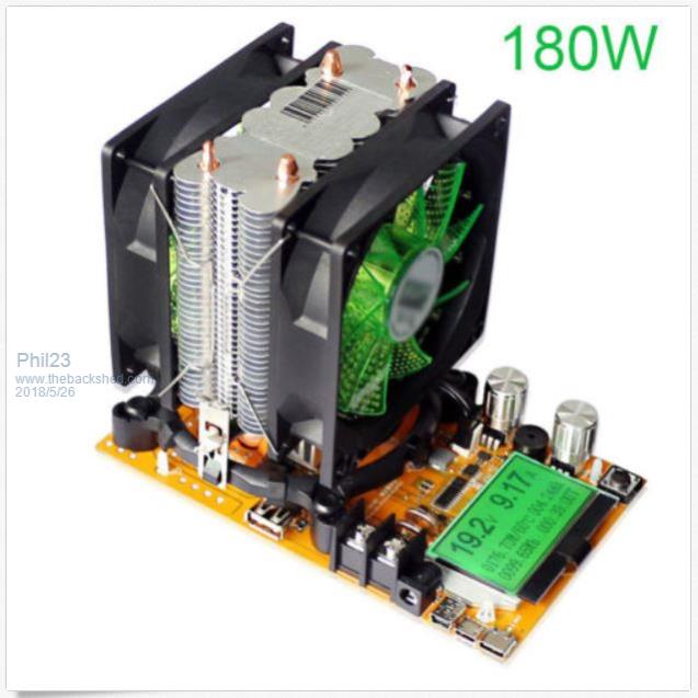

Should add, this is what the fake/faulty ones look like,
And, when I just search eBay for that image with, "Constant Current Electronic Load", I noticed that there's a few more variations available now; maybe some of them will behave Ok.

That battery tester looks pretty fancy, I never thought of doing it that way.
