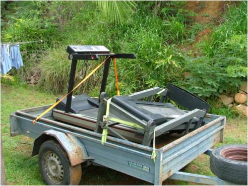

Visited the local recycling center ( dump ) today, looking for anything interesting. There were several electric treadmills, so I had a closer look to see what was worth grabbing. Most of the cheap models had a simple AC 2 or 3 speed induction motor, but I did find one with a DC motor and one with a larger induction motor and VFD ( Variable Frequency Drive ). Picked them both up for $30 the lot.

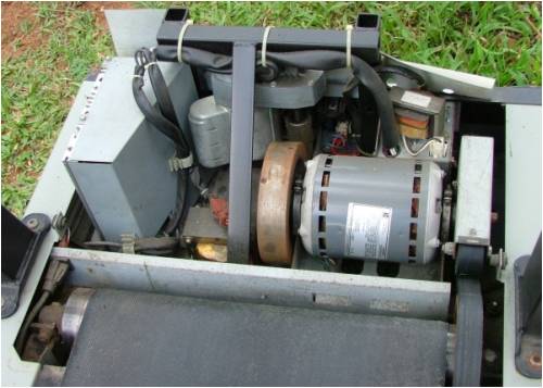

Below is the drive of the larger treadmill ( weights a tonne, just getting the thing off the trailer was a workout! ). AC induction motor, no HP or watt stamp. There's another motor in there on a jacking screw to tilt the treadmill up and down.

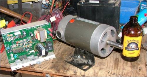

Here's the motor out of the treadmill. Removed the flywheel and fan. Shaft diameter is 16mm, casing is 105mm diameter and 180mm long. Two pole. Spin in the lathe shows 24v at 460rpm, so it should work ok on a 12v system.

That DC motor is nice indeed. What does the nameplate say? (RPM, current rating, temp. rating, duty cycle, etc.)
The controller can always come in handy too. Not big enough for an electric car à la Oztules, but perhaps an electric bike? Or to control a spindle motor on the CNC machine? Or a PCB drill controller? Or... 1001 possibilities, really.
In the future I will have to keep an eye open for treadmills, it seems. I've let a few pass me by, but a DC motor and controller could always come in handy sometime, even though I have no direct need or use for one. BTW, does that other treadmill have a single-phase or 3-phase induction motor and VFD?

The nameplate says 4000rpm, 180v, 1.25hp.
I managed to get it working with its controller, a resistor had gone open circuit. There is a opto-isolator I can feed with a PWM to control the motor speed, I'll put together a little 555 circuit with pot to drive it.
I'm thinking about making my own F&P test bed. The motor has a belt and 1:3 pulleys, so I'll fit the larger pulley to a F&P shaft to reduce the treadmill motor speed by 3. Add a pony brake, a couple of meters, and I'm off.
