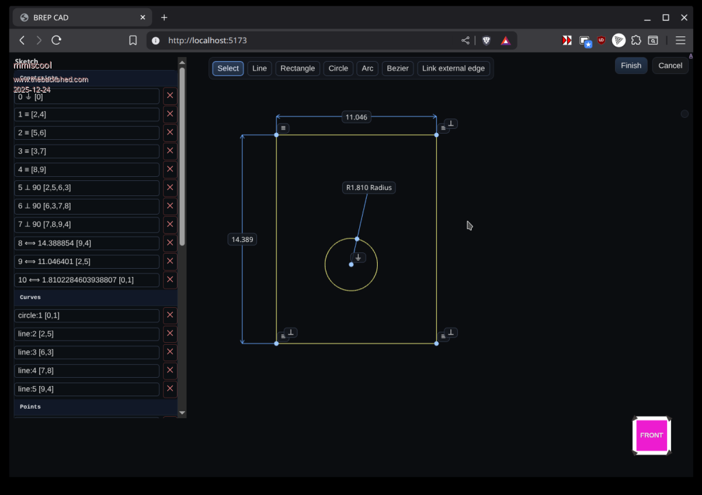

Sketch-based workflows (extrude, revolve, sweep, loft)

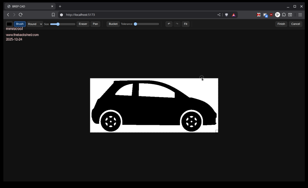

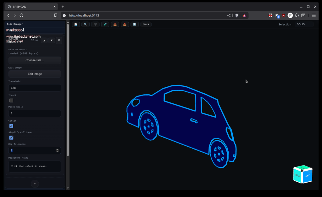

Image-based workflows (heightmaps, 2D image-to-face tracing)
Mesh import + repair

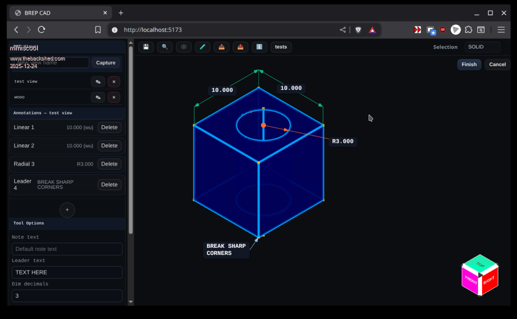

Assembly modeling with a constraint solver
PMI / annotation mode for manufacturing communication
