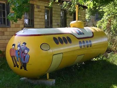

I agree with mac46,you need a pressure vessel not a plastic tank. Burying it will just postpone the rupture and make it a bigger boom when it happens.
If you are serious about this it is worth doing some legwork and sniffing out some cheap tanks, the reason I suggested large LP gas Tanks is they are the biggest buyer in the market and sell with the lowest margin, they are identical to an air receiver tank built on the same production line.
I have seen NEW tanks sold for the price of the steel, a qualified fitter can add extra outlets and a mobile pressure testing service will ticket it for 10 years. It will be tested to 500 PSI rated for 350 PSI and setup for 250 PSI. The only downside is they are heavy, you need something big to get them off the truck.

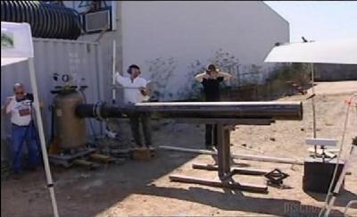

The professionals use air in three stages high pressure tank 250 PSI, low pressure tank 80 PSI, vacuum tank. You transfer air between the tanks to do the work and run your turbine pumps to fill your high pressure tank and evacuate the vacuum tank (between the tanks in a closed system).That way, only a small amount of fresh moist air enters the system , which means your lubricant is not degraded and the air motors don't seize up.
This works great until you buy a plasma cutter or build a chicken gun.

I love that yellow submarine; can't top that one!
