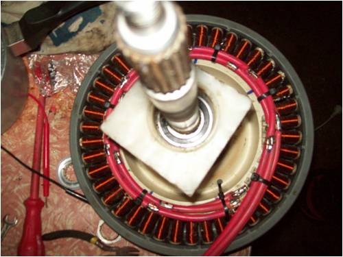

Posted: 09:03am 21 Mar 2011
Photo of first finished Star Configuration F&P generator.

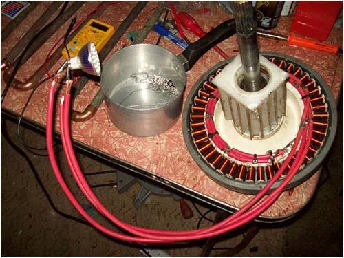

Jaffasoft
Joined: 03/11/2010
Posts: 102
Posted: 01:00pm 21 Mar 2011
Just finished number two on midnight.

When I have to solder thin wires together I always 'tin' them individually first. This shows right away where the wire needs more cleaning.Only when each wire is nicely tinned all around do I twist them together and do the final soldering.
Its important that there be no solder blobs on the individual wires or the twisting together is not easy.
Practice makes perfect with this soldering task.
BTW, the blobs of solder you saved in your pan will not work well for soldering wire since the flux has disappeared. The blobs might be useful for pre tinning some thicker wires, do use a resin stick (looks like a felt tip pen) to put flux on your work first.
