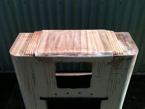

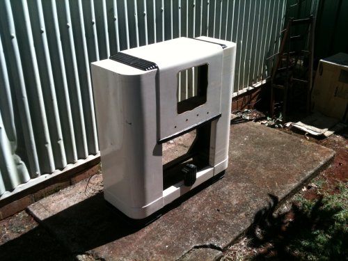

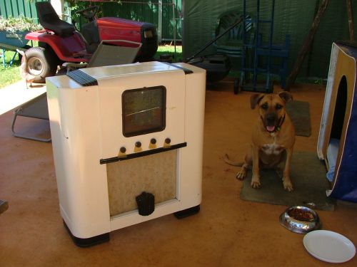

As part of my "Get to know your new home town" adventures, I called in to the Toowoomba tip shop to see what they had. They had the usual furniture, scrap iron sheets, etc, and a old valve radio that caught my eye. A quick inspection looked promissing, the internals were still in place and the timber was in good condition, so its been kept dry all these years. They had $200 on it, but I managed to talk them down to $180, squeezed it into the back of the car and drove home.

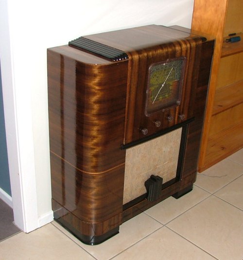

Unfortunately someone has painted the cabinate cream at some time in the last 70 odd years. These radios usually have a beautifull vineered timber finish, like this radio from my growing collection.
So I'll have to strip the paint back and see what condition the timber is in.

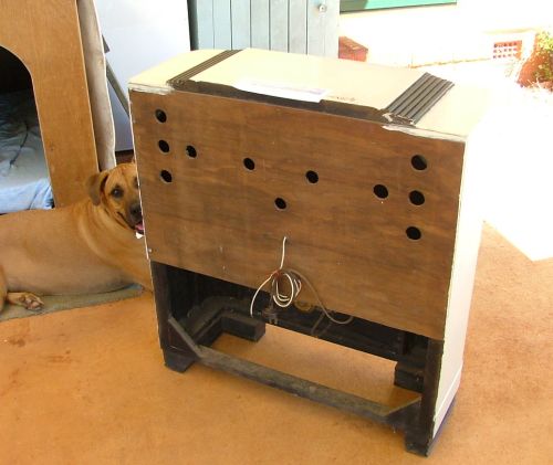

The back shows the cover still in place, a good sign its been taken care of.

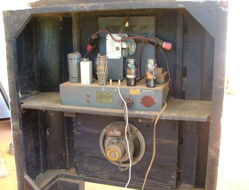

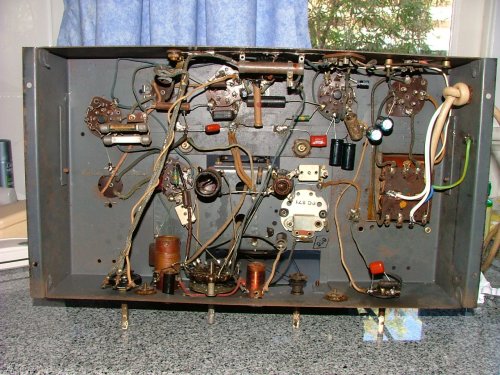

Cover removed, looks in good condition. All valves are there, and there is very little rust on the chassis. The speaker in these radios forms part of the high voltage filtering circuit, it uses a electromagnet instead of the permanent magnet, and the electromagnet coil acts as a inductor to filter out the AC hum on the DC supply.
In a few weeks I'll look at restoring the circuit. I've collected and fixed a few old valve radios, its fun to see a old radios working again. The valves are usually fine, but many of the caps need replacing and the whole thing realigned to get it working like new. This one has a original power lead, so that will need replacing.

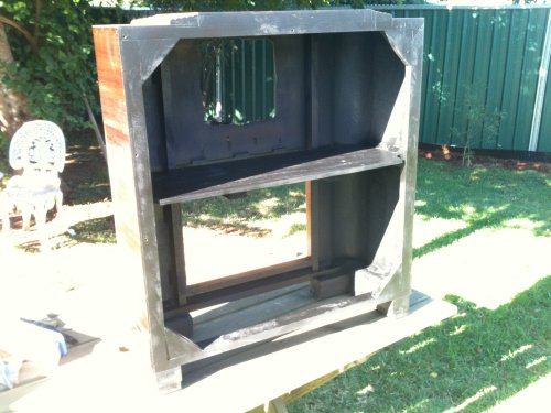

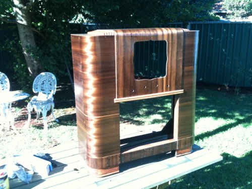

I've started the restoration. Removed the speaker, chassis, speaker cloth and dial glass.
My brother's a cabinate maker/builder, and he's suggested I do the following. Use paint stripper and a plastic scrapper to remove the majority of the paint. Then metholated spirits and steel wool to remove the remaining. Wash down with water. Its working a treat. There's 3 layers of paint, the white with black trim you see, then a cream with green trim, and finally the original clear laquer.
The original timber looks in good condition so far, makes you wonder why it was painted, fasion I guess.

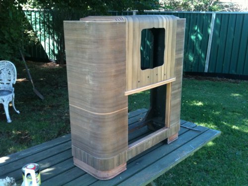

Had some free time today so finished off de-painting the old radio.
And its first coat of varnish. Tomorrow I'll sand it back, paint the black trim, and add another coat of varnish. Its starting to look good.
I also re-sprayed the interior flat black.

Posted: 03:31am 16 Apr 2011
Its alive!!!!
Finished off the timber cabinet, 3 coats of gloss varnish. In hindsight, I think a satin/semi-gloss would have looked better. In my first posts I mentioned I thought it was a shame someone had painted it, but looking at the finished product, I think they did the old radio a favour, cause the timber has been well protected over the last several decades.

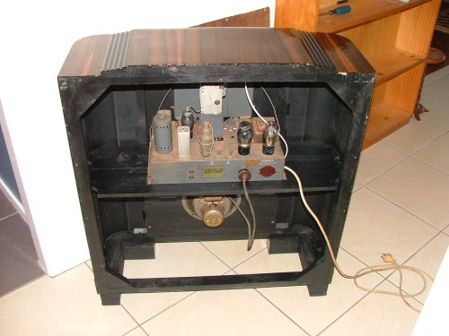

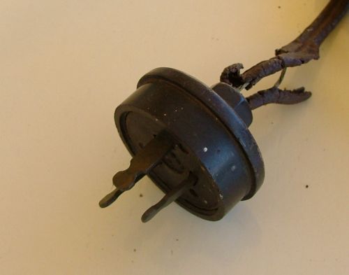

Now to the chassis. First tested the power transformer for open circuit windings or leaks to ground, all OK. Removed all valves, replaced the power cord and powered it up, being very careful, there can be several hundred volts inside these old radios. The transformer outputs measured OK, 6.3vac for the valve heaters, 5vac for the rectifier valve heater, and 600vac across the HT output. Let it run for 5 minutes and turned it off, unplugged the power lead, and then felt the transformer to see if it was getting warm, a sign of shorted windings, all OK.
Tested the speaker, remembering is uses an electromagnet so there are 4 wires, all good. Thats the hard to replace bits all tested and working OK. Next I blew out the dust and oiled the dials and switches.
You can still source 2nd hand valves for these old radio's, but as a rule, the valves are OK, its the capacitors that need replacing. I replaced about 8 caps with modern day parts, matching the values as close as I could. The main filter caps were 8uF at 600vdc, I ended up connecting two 22uF 450vdc caps in series to get a 11uF 900vdc cap as their replacements.
Yeah I know, tying a knot in the power lead is not an acceptable method of anchoring the power lead, I will fit a cable clamp, promise
I did find one valve, a 6U7, with a tiny crack in its side, about 10mm long. I think the vacuum inside was still intact, so applied some varnish to the crack, fingers crossed the valve is ok, but I dont think it would last long with continued use, the heat/cool cycles would cause the crack to grow and the valve to fail
I tested the chassis on the bench, it worked! Needs a bit of a fine tune though, but my cro is packed away, and I dont have a RF signal generator anymore, so I decided to leave it as is for now. Besides I would prefer to replace that 6U7 first. The valve line up was an 80, 75, 6V6 6K8 and a 6U7. Controls on the front were Tone, Tuning, Band and Volume.

Changing all the caps is a common practice, but if the radio is working OK, you really only need to replace the power supply electrolitics. Usually there are one or two of them, 8uF or so, 450v, in a chassis mounted can. If these get a bit leaky they will stress the rectifier valve and the mains transformer, causing them to overheat. The other caps in the radio can affect performance, but if you happy with the radio, leave then in place until they cause a problem.
But if you can, make a note of the cap values ( uF and V ). Cockroaches will eat off the capacitor labels given a chance.
Its also worth while checking the mains power lead, and making sure the chassis is earthed ( unless its one of those dangerous models with a live chassis ).
