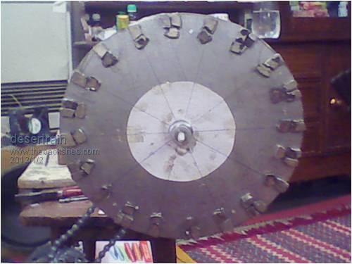

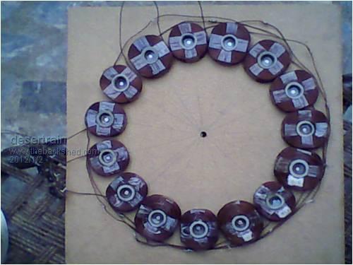

This is the old toy stater 15 coils, 110 turns per coil, 19 SWG (3 phase) Maximum voltage=30 volt.
Old toy rotor with solid hard drive magnets stacked on to each other.

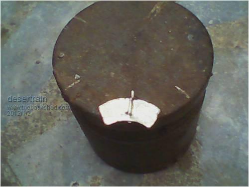

A Hard Drive Magnet

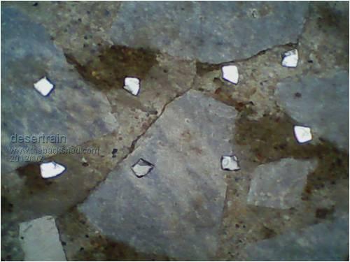

Broken Magnets.

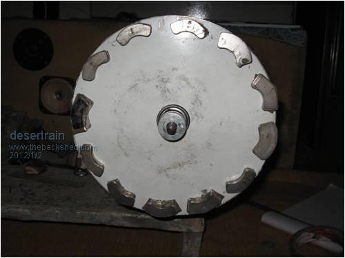

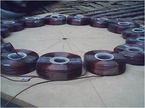

New Stator with 15 coils, 210 turns per coil, 18 SWG, (3Phase) Maximum voltage = 90 volt. (looking for 220)
Side view of coils on statur
the new rotor with three set of broken magnets N - S - N - S situation

I remember thinking it was good that you broke the magnets in half. Some of the rare earth oxides in hard drive magnets are highly toxic if the dust is breathed in to the lungs. They can be cut wet with an angle grinder to prevent dust and the grinding waste can be buried where rusting will make it safe.
