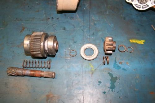

The plan WAS to use a landcruiser starter motor and the flex plate and ring gear from a toyota 4runner and mount it to the other side from the winch handle.
That would be a pretty neat solution but it is a bit of engineering work and heavy duty wiring that would be prone to corrosion.
I decided a bit of lateral thinking was in order there has to be a better way to do this with gear that is portable and we have laying around.
the winch is a three speed with 22 mm hex drive heads for the winch handle so I am thinking I might try an impact wrench.
I reckon one of the new high power cordless impact wrenches or a half inch air wrench driven from a 40 litre air tank driving the 10:1 reduction gear would be just the ticket.
I'm not sure that it will work but it is worth a shot.

Yep you are right,
I tried my cordless rattle gun on a 3:1 brake winch I have on an Auger at home. Worked great at light loads but it started to hammer and slow down at higher loads. I will try a big 1000 ftlb air wrench but I think it will be worse, they seem to spin faster and hammer sooner.
Looks like I am back to the starter motor.
I am looking to design something that is elegant, compact and removable. Thoughts of right angle reduction boxes and planetary gears....hmmm
I have been trying to avoid modifying the pinion, I should just build one like Tinkers with less reduction and get it working. Fishing is ultra high priority, fancy engineering can wait till I get some inspiration. and tasty whiting!

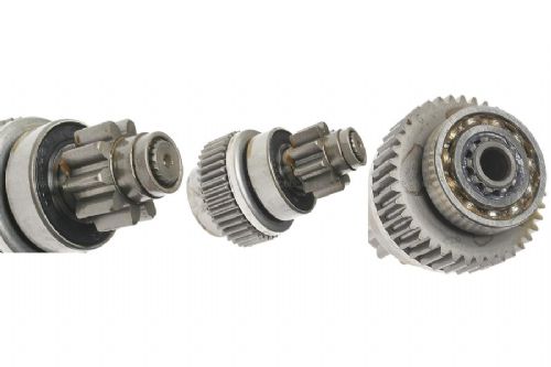

I am building up an engine for a Hot Rod project, and stumbled across some very interesting geared starter motors.
These use a permanent magnet 1.9Hp motor that is much smaller and lighter than a traditional direct drive starter motor, (4Kg versus 13Kg in my application) but the internal gearing of 4.4:1 produces far more output torque for much less battery current.
Could also be useful in a 12 volt winch application.

That is the reason I was going with the landcruiser starter motor Tony, what you are looking at is identical to that but with a custom casting, the 2.5 Kw reduction starter has been very popular for the old big block Chevy's for years.
Denso have been making that reduction starter for some time now it is very reliable and has heaps of grunt and is an off the shelf replacement part for every cruiser model right back to the sixties.
Don't quote me on this but I think they make a version that will take an end plate adapter so that the Denso starter can be fitted to some really oddball motors.
The only downside is the imitation starters are flooding the market now and they are hard to pick from the original, as usual the quality is poor.
Its funny, this all started with someone asking me if it was possible to build an electric crank handle for old cars and stationary motors, I thought it would be an easier build to start with the winch before tackling that one.
I know I can buy the pinion and gear, so I might see if I can modify that easily before I go all out and build the complete unit.
