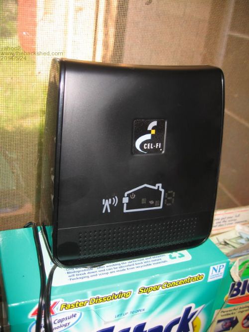

Well, I finally got my hands on it and set it up for a test run.
Because I have no signal at all, I am not using the internal antenna's, I have plugged the external antenna that I mentioned in the last post into the base station.
This has given me three bars of signal on the base station in my office. From there it is wirelessly linked to the repeater unit. The idea is to find a spot for the repeater that still gives a good wi-fi connection but is far enough away to let the mobile phone frequency power be cranked up to the max.
I have plonked the repeater in the laundry (easiest convenient spare power socket), the power output is between 7 and 8 from a possible 9 in this position, I had to use the flash to get this photo so the numbers are not visible.

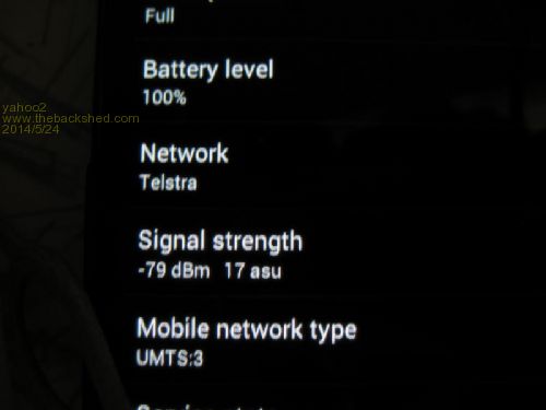

So here is the result, a smart phone that I have never used due to its poor signal reception at the best of times is working flawlessly within a 130 metre radius of the repeater,
DATA
ping time 163 ms
download 2.4Mbps
upload 420 kbps
SIGNAL
That is as good as I have seen standing next to a phone tower, the signal strength (dbm) is not overly high but it is consistent and stable and so far I have not had ANY voice dropout at all I am not sure about the ping time, I am more than 50 Kilometres from the closest visible tower and the Telstra server in my region is a bit of a plodder, it seems a bit optimistic.
The asu on this phone is a combination of signal strength and quality, 17 out of 25 is exceptional, I assume this means it is pretty clean with almost no interference.
The external antenna on a 30 foot tower gives me an added bonus, I can use the phone the other side of the base station without it cutting out, so positioning the base may not be as critical as I first thought.
I am a bit stunned, I didn't expect it to be this easy or work this well. Edited by yahoo2 2014-05-25
