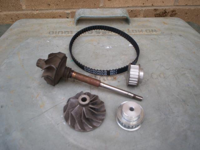

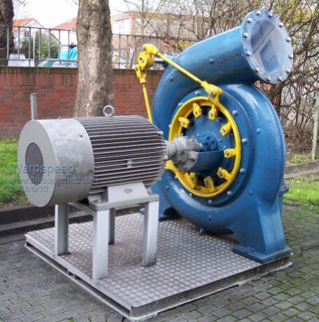

Posted: 01:40am 10 Jun 2018
Jet/pelton wheel is simple, but I wonder if something a lot more efficient might not be possible.
Problem with a Pelton wheel is only one pair of buckets are producing useful torque at any instant. Thats fine, as long as the water head pressure is quite high which may sometimes be difficult.
In a real full sized commercial hydro, the answer is the Francis turbine which uses a snail shaped housing and a very carefully shaped turbine wheel which produces constant torque from every blade all of the time. They also commonly use guide vanes to adjust speed and torque to match the load. Here is a fairly small example of a Francis turbine fitted with guide vanes:
Now the really interesting thing about all of that, is that the internal geometry of a Francis turbine, is identical to the internal geometry of a turbocharger exhaust turbine. They essentially do an identical job.
A lot of R&D goes into development of turbo exhaust turbines and the shape and fit into the housing is about as perfect as is possible. Not only that, the turbines and housings are made of stainless steel alloys and will not rust.
Turbine housings are available in a wide variety of sizes with different nozzle areas (A/R ratios) which can be interchanged to match the head pressure and flow you have available.
An even better solution to finding a suitable exhaust housing A/R by trial and error, would be to use guide vanes similar to a real Francis hydro turbine. A variable vane turbocharger turbine would be ideal, as its already all there...
Should not be too difficult to pack the bearings with waterproof boat trailer wheel bearing grease, and fit some toothed pulleys to drive the alternator.
It would be a case of removing the aluminium compressor wheel (on the left) which has a smooth bore, with a toothed pulley (on the right) that can also have a smooth bore in the same position on the shaft. There is a left handed nut on the end of the shaft which tightens if the pulley tries to slip. The whole job looks to be fairly straightforward requiring only simple tools.
