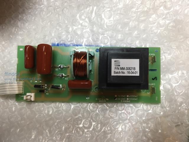

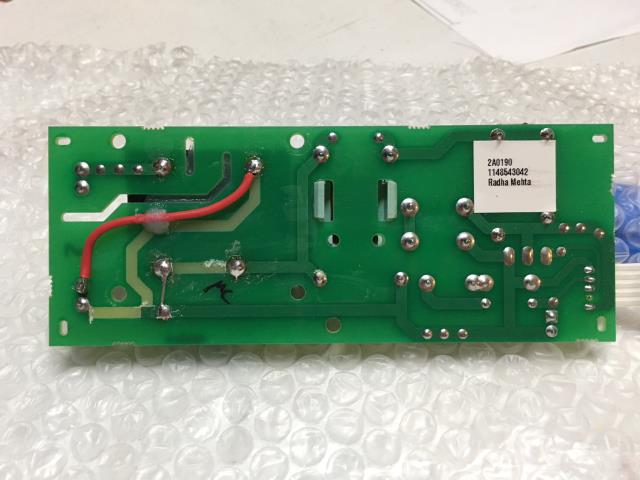

Posted: 11:10pm 22 Jan 2019
A common fault on modern Gallagher units is the transformer fails. Unfortunately There’s no off the shelf drop in replacement available.
There’s a guy that retro fits a transformer from a different unit for them. His name and company name are eluding me at the moment.
The photos are one of the units we got back from him. The pin out on the replacement transformer are different hence the cut tracks and jumper wires. if it turns out to be the transformer you might be able to use the photos to replace it.
