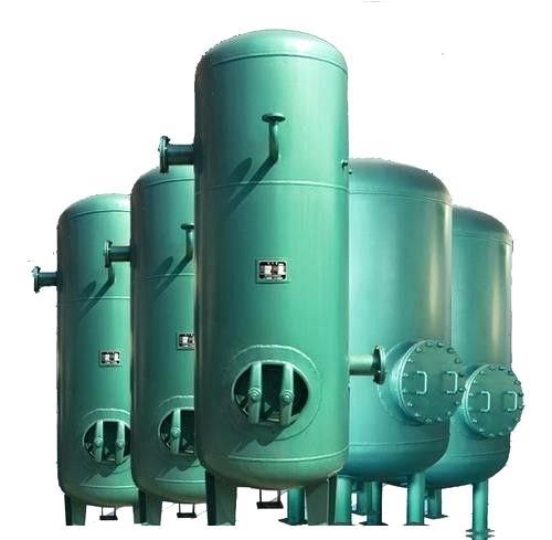

One very effective way to silence a stationary engine is with a LARGE expansion chamber filled with fibreglass wool. You need something with very thick heavy steel walls, say 6mm thick.
Something that works really well is an old compressed air tank/receiver. These are incredibly heavy and usually have a removable inspection cover. Stuff as much fibreglass wool as you can into the tank. Fill it right up !
The pop-pop-pop of the exhaust gets muffled really well, and the thick steel walls prevent the direct sound from escaping. A restricted outlet, say a short length of three quarter inch water pipe, will just hiss, without any sound escaping at all.
There will be a drain outlet at the lowest point to allow condensed water to drain.
If you are patient, something suitable and pretty cheap will show up on e-bay.

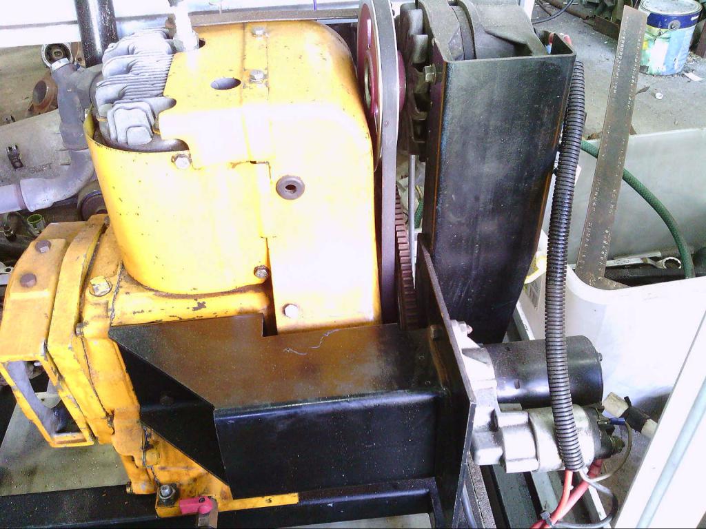

Posted: 01:25am 11 Aug 2019
I bought this for fifty bux on e-bay, 12Hp Wisconsin with a 240v generator, not working because of a missing carburetor but otherwise complete.
So I pulled it to bits, found it had been completely rebuilt, still had the cross hatch hone marks in the bore, but had an oversized piston fitted with standard sized rings so the ring gaps were gigantic. It was terribly hard to start because of the ultra low compression.
Anyhow, fitted an ignition coil and Bosch igniter, tachometer, electric start and a 12v alternator to it and raised the compression ratio. Also a massive steel compressed air tank as a muffler.
I planned to eventually run it from natural gas.
But its rather noisy and no simple way to fix that as its air cooled.
Its now quite a nice machine, starts first push of the button and runs well.
Diesel would be better, but as natural gas is so cheap and comes in an unlimited quantity and requires no refueling, that has to be best of all.
Next attempt might be a small water cooled diesel converter to spark ignition and natural gas.
What do you think ?

Posted: 02:47am 11 Aug 2019
The ignition part was easy, the Wisconsin originally used a magneto with fixed timing.
I just used the original points to drive a Bosch igniter module, no problems at all with that. A carby I bought on e-bay gave perfect air fuel ratio mixtures straight out of the box.
I was planning to use a model servo actuator for the carburetor and a microcontroller as a more accurate rpm governor. Only ever finished the mechanical actuator part of that.
Anyhow, if I removed the diesel injector and fitted a spark plug, it should be easier to start and eliminates all the injector/pump problems.
You are right about the heavy induction pulsing being a problem, but the same problem exists with carburetors. Its just a matter of fuel calibration.
