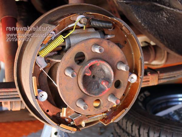

Thought I would throw this one up. My daughter in her wisdom has purchased a mid seventies vehicle and being dad I thought I would at least make it as safe as possible. I checked the front drum brakes and saw that they were nearly worn out so along with some other parts I took a sample of the shoes to the brake shop an purchased some replacement shoes. All went together Ok but although the drums rotate on their own they lock up when I tighten the wheel studs. Any help with this issue would be greatly appreciated.

Sounds like they are not the correct shoes or you have fitted them in the wrong way.
If you tighten the wheel on and they lock up then it sounds like they are getting jammed against the drum itself, thus locking it all up.
Is this what you mean when you say "tighten the wheel studs"?

This is what I am familiar with (pic ripped off net)
What are you tightening to cause a lockup?

A picture of your brake would be helpful.
I always did mine one side at a time because of the multitude of different ways that they could be installed.

But front brakes are much simpler. It sounds to me as if the wheel cylinder pistons are extended, which they will do as the brake shoes wear much thinner.
Try forcing each piston back into the wheel cylinder bore, by applying some leverage from a screwdriver. The pistons should move smoothly, but take considerable effort to move. There is a very faint chance that one or both pistons may be rusted or jammed solid, but its unlikely.
Be aware though, that pushing the pistons back will force a lot of brake fluid to go back up into the master cylinder, and it may overflow. So put something underneath to catch any overflow. First remove the cap on top of the brake fluid reservoir, otherwise the returning fluid will have nowhere to go and that may stop the wheel pistons from moving back far enough.
With both the pistons pushed back, that will move both brake shoes inwards.
New brake shoes will be a lot fatter than the worn ones, and will simply jam if you try to replace the drum without first pushing the pistons back.
Replace the drum and wheel and it should all rotate freely.
The brake pedal will now hit the floor when you first apply the brakes. That is to be expected.
Pump the brake pedal a few times, not too quickly, but make sure the fluid level in the brake reservoir does not drop too low. So after each couple of pumps, top up the fluid if necessary.  The brake pedal should come back up to its normal working height, and job done

The new shoes are going to be larger than the old ones, simply because the linings are unworn and much thicker.
The drums are going to jam unless you make allowance for that.
Can you take a photograph of your brakes with the drum off ? Or perhaps if you can tell us the exact make, year, and model a picture may be available on the internet.

These front brakes are so simple with two shoes two springs and the pin retention. I spoke to the brake shop and there advice was that the new shoes had too much lining and even though the adjusters were fully back there was not enough clearance. This has been rectified by grinding about 1mm off the shoe at the point where the shoes fit into the slave cylinder slots.
