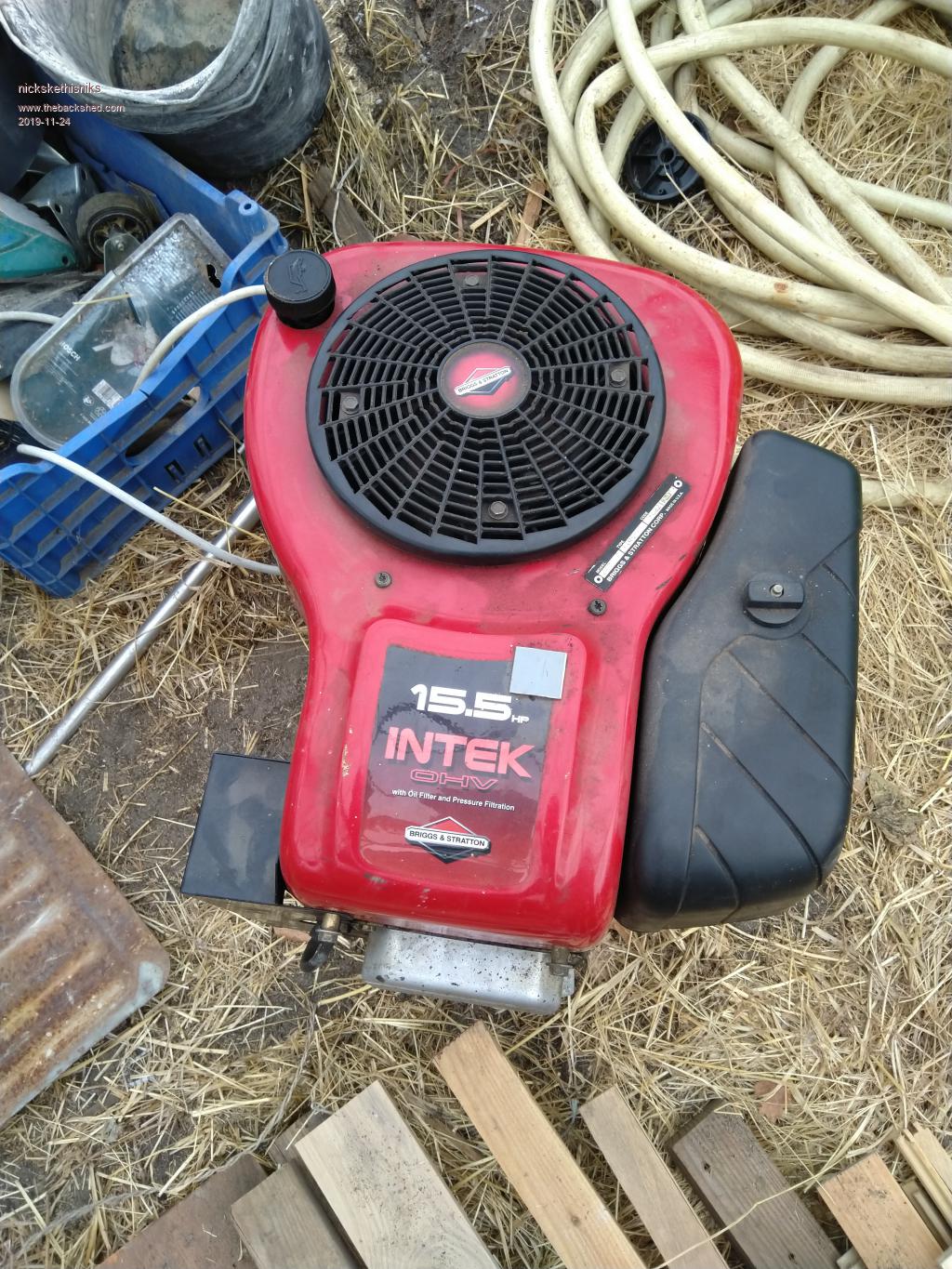

I found out I still have a motor laying around...
I forgot it completely, removed it 2 years ago in an attempt to convert my lawnmower to electric. It already has a charging coil and electrical starter

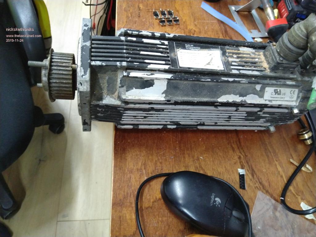

Just tested the ac synchronous motor, it likes more to be loaded on all the 3 phases the same way, no vibration then. When spinning with a powerfull cordeless dril, I fed the rectified sinewave in to a heater, that gave me 500w. So not bad.
It would cost me about 100€ to buy the right timming belt and puleys. And a weekend of time to weld somekind of frame and put it together.

That looks like an 8mm pitch timing belt.
Many overhead cam car engines use 8mm pitch belt and gears.
Typically 24 teeth on the crank and 48 teeth on the cam.
Should be able to scrounge something very cheaply from an auto graveyard.

Saw the Pic and was thinking exactly the same thing. I have a collection of Timing gears and Idlers off cars.  They can be very strong. Takes a lot of energy to actuate the valves on a quad cam engine turning 6K rpm.
Belts are usually better at higher RPM for the load they can carry but I think they would breeze this in. Belts are changed pre maturely on cars anyway so what would be replaced for automotive use would probably give you hundered more hours use in this setup. You can easily tell the condition just by looking if the writing has worn off and if there are any cracks on the back or missing teeth. They are really shot when they get to that but generally they are worn but not damaged.
The other thing you might get cheap from Vehicles is the Micro V or flat multi rib belts.  You should be able to get a variety of pulley sizes from different cares, just check if they run 6 or 8 groves. On 2 Pulleys with a tensioner, these things can turn 20HP without much trouble.
Being a vertical shaft engine, you'll have to turn the motor the other way as well.
You could tension the belt conventional with a slotted and pivot mounting point but these days idler tensioners are on everything and not even expensive to buy new off fleabay. That way you always know the things are going to be right and don't have to worry about adjustments.
What is the rating of that Motor? Doesen't look very big and is an unusual layout.
Running a 15 Hp engine on that motor  even if you gear it up 3:2 looks like it would  be pretty severe over kill.  Perhaps you could find another larger motor cheap at the scrap yard?  I see them all the time at my local place and often there is nothing wrong with them.  Easy to check with an ohm meter anyway and if you can get them for a few euro above scrap value, you won't pay very much.
I would also look at putting a car muffler on the engine and getting a header made to suit. The OEM mufflers are terribly restrictive for packaging and silencing purposes and do nothing for engine cooling or fuel efficiency. A car Muffler will not only give the thing a quieter note but also let it breathe better and run cooler.
The main noise you will get with one of those engines is mechanical clatter.
Not easy to do much about on an air-cooled engine but double open surrounds will help.

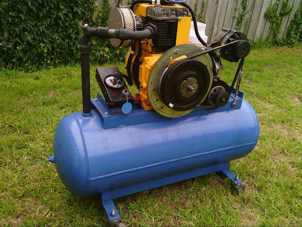

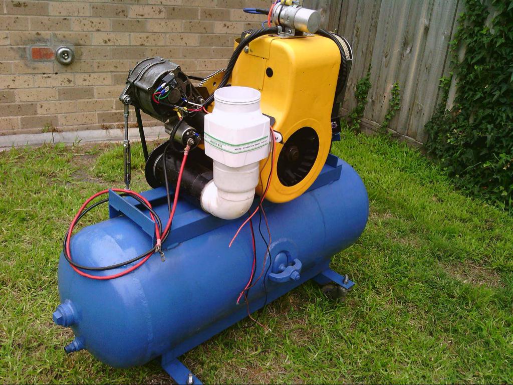

If you really want to make a small engine run quietly, one way to make a very efficient exhaust muffler is to use an old compressed air receiver tank stuffed with fiberglass wool.
The steel in these will be at least 10mm thick, and no sound can escape through the walls. There will be a removable inspection plate through which the fiberglass can be installed. These things are heavy, this one weighs just over 90Kg, but it reduces the exhaust noise to just about zero.
This looks like an air compressor at first glance, but the big blue tank is actually the exhaust muffler.
Still not finished yet, but I have had it running.

That's a Nice setup Tony. Is that your Wisconsin engine?
Is that a treadmill motor you have the Bilge blower drawing through?
I use the exact same setup with the turn buckles for belt tensioning on my setups as well. Also car belt  tensioners can be good as they are virtually self adjusting and take up the belt stretch.
I Took a big tank like that to the scrappy last week. You are spot on, I think mine looked around the same size and was about 90 Kg as well. That's why I dumped it, too dam heavy for what I wanted it for.  Mine certainly didn't have the inspection port like yours though.
One thing I have worked out is you only have to get the exhaust as quiet as the engine.
I'd say that engine would be pretty easy to quieten the exhaust on with a car muffler if one didn't want to utilise the tank as a base like you cleverly have.
I'd pretty much bet you'll get a fair bit of noise from that paper filter ( would be a lot worse if it were a 2 Stroke or a Diesel) than you would with any decent Muffler.
The lister company had plans for Gravel Pit exhaust which from what I have seen Vids of, are pretty much silent.  You bury the exhaust outlet in some Chunky rocks and then fill around  them with some smaller ones that still leave escape paths for the gasses.  Seems to work very well. I saw some guys in the UK running the exhaust through a generous size plastic Pipe  under their garden beds and then up and out through a smaller outlet with a small Muffler. The idea was the larger pipe provides plenty of Muffling area slowing the exhaust down and the heat makes the soil warmer in winter and the plants grow better. Plastic pressure pipe is cooled enough by the earth not to melt or collapse.
The exhaust in most engines given a bit of attention to is probably going to pale into comparison with the noise from the engine itself.
Not come across an aircooled yet  that doesen't emit mechanical clatter and 2 strokes can be a lot quieter in that regard than anything else.

Yes, its a 12Hp Wisconsin, it runs at only 1,200 rpm to keep the noise down. All of the noise now seems to come from just the external moving parts, which is not a lot. Measures as 47 dbA at six metres which is the standard test distance for generators.
It drives a 2Hp treadmill motor, rated 180v and 10 amps to 3,000 rpm. I fitted a 12v e-bay "bilge blower" to force some serious cooling air through the treadmill generator. That bilge blower is rated 270CFM at 12v, and it pushes a measured 100 CFM through the treadmill motor.
You are right about only having to make the exhaust as quiet as the engine.  This is probably less, but its also the nature of the noise. Anyhow, pretty pleased with how this has all come together from junk I already had.
Still putting it together and still a lot more testing and mucking about yet, but it all looks quite promising so far.
Eventually plan to get a natural gas carburetor for it so refueling will never be needed. Final step will be to get it to start and stop all by itself whenever the battery gets a bit low. Its all a bit over designed really, but its been a fun project.
The gravel pit idea is something I have not heard of before, and should work well. Another trick is to feed the exhaust down a storm water drain.

That looks like a good setup Tony.
I have used old gas cylinders and even an old HWS for a muffler, (for six litre diesel generator) works well and cost nothing.
Saw an old powerhouse diesel engine once, massive thing with underground muffler and was half full of water, not sure if it was supposed to be.
I have 2 of those engines 9hp each, one has the points on the side of the block the other has the old impulse magneto and was easy to start, also have a V4 that has a great sound but wouldn't run on LPG because of the waste spark would ignite the gas and backfire, it can be fixed, some engines are ok with it.
After reading your post I saw inside one of those silenced diesel generators, all the inside was lined with that sound proofing wedge foam, which seems to be cheap enough to sound proof a small gen set.
Could end up that quiet you might forget its going.

I had thought of making a kind of small alcove in one corner the garage lined with that sound absorbing material. Its difficult, because totally enclosing an air cooled engine is not going to work. A water cooled engine would have been much better for this, but I used what I already had, that was part of the challenge, to do it at minimal cost.
Its not obvious from the picture, but the short shiny section of exhaust is a slip joint to allow for a bit of expansion and movement. Also some solid rubber tires, with a bit of give, take up any small unevenness in a concrete floor, and prevent any vibration from being transmitted through the ground. Without this, a solid steel base tends to rock and walk around due to the vibration !
In my case, this heavy tank makes an ideal rigid base to bolt down the engine and the generator. Its all rather large and heavy for the small amount of power it generates, but as a stationary never to be moved around generator, that does not matter.
Underground mufflers are nothing new, and fairly common on some of the very ancient very low rpm stationary diesels. One or more interconnected brick lined underground chambers is supposed to be very effective.
Another way to do it would be to bury a section of large concrete pipe stuffed with old car tires, and a few heavy baffle plates along the length that have only a smallish hole. That works on the same principle as a gun silencer. If building a new home, it would be quite practical to bury something like that under a lawn or the driveway. If made from concrete pipe and old tires it could be buried and then forgotten about.
The basic idea is to make each chamber fairly large compared to the volume of exploding gas you are trying to silence. Then have something in there that absorbs the sound energy as it echoes around and beats itself to death. The real secret is to then have a relatively small final exit passage for the exhaust to escape. The escaping exhaust will be almost a steady constant flow with absolutely minimal pulsing, with all of the higher harmonics totally suppressed.
Edited 2020-02-21 06:27 by Warpspeed

Hey tony, have you got a photo of the other side, just wondering how to did the pulleys.
Edit, i'm in the twighlight zone, when I first looked there was only one picture, now I see both sides.
