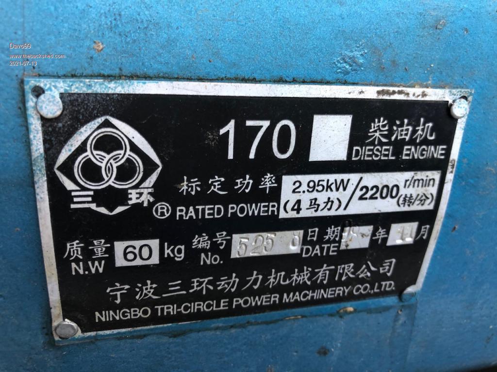

I have 4 water-cooled China Horizontal Cylinder engines and they aren't great either.
The sizes of those range from 2.5 Hp to 12 and there is not much difference in sound.
The quietest is the Listeroid as it is flat out at 600 RPM but it is very unbalanced and I have not been successful in calming it down. The thing defies all efforts to stop it tearing loose and bouncing away bar being  bolted  to large concrete slabs.

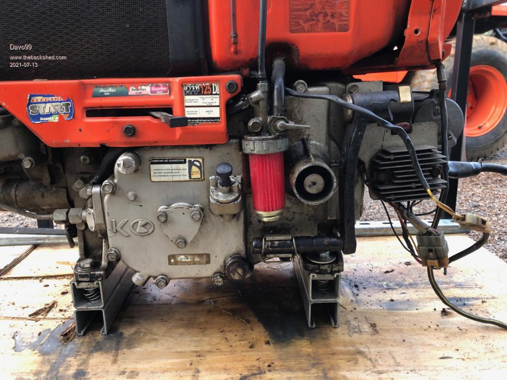

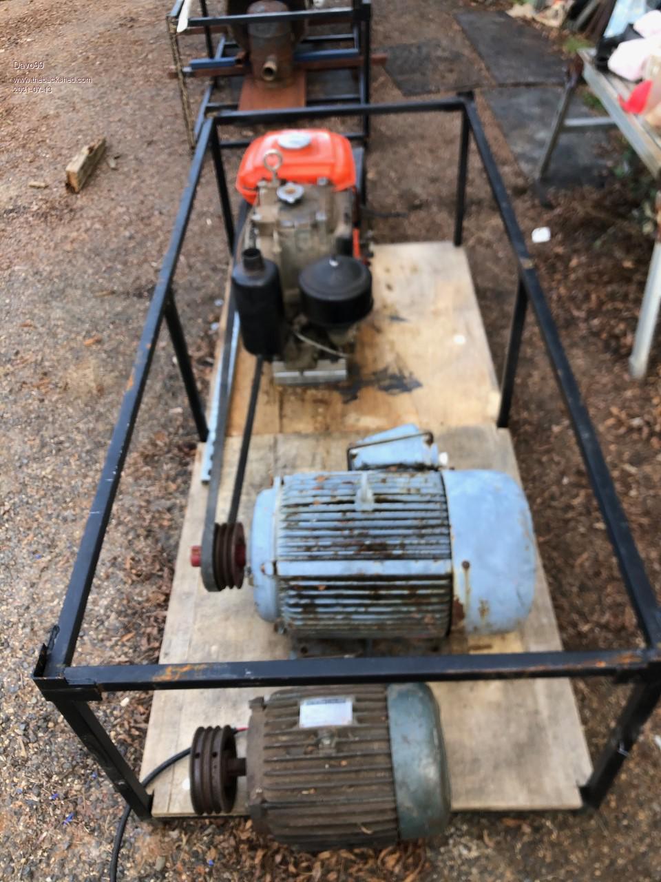

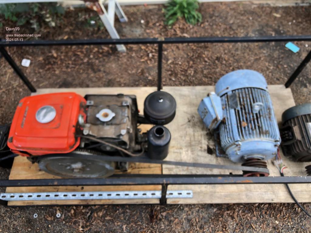

I went out Foraging this afternoon and found some steel  frames with plywood bases. They were at the local mower shop  and probably had  small rideons or garden machinery on them.
Made of 20mm steel square tube they are 1800 long, 800 wide and about 480 High.  Plenty of room in every dimension bar height. I didn't even measure any engines till I got home and found I'd really like about 800 High to allow for a thicker base, engine mounts and decent clearance.
There were a pile of the things down there that were stacked up so I'll go down again tomorrow and get another then I can extend just weld a couple together to extend the height and cut down the length to what I need. Probably a bit on the wide side but I'm not going to worry about that.
The frames are slightly raised so I can easily get the forks on the tractor underneath to move the thing but I'll probably try to put it on castors as well to make it easy to move on pavement.
I also picked up some nice pallets.  Plenty of decent slats in them, only softwood but should be OK for attaching to the frame to make sides and a lid.  I'm thinking of having the top lift up and the front fold down for easy access but still to figure best way to go about the front.  Might go down and pick up a few more of them tomorrow as well to ensure I have all the slats I need. Will just about be the right height as well, Might get away with not cutting them down at all with a little overlap at the top and bottom.

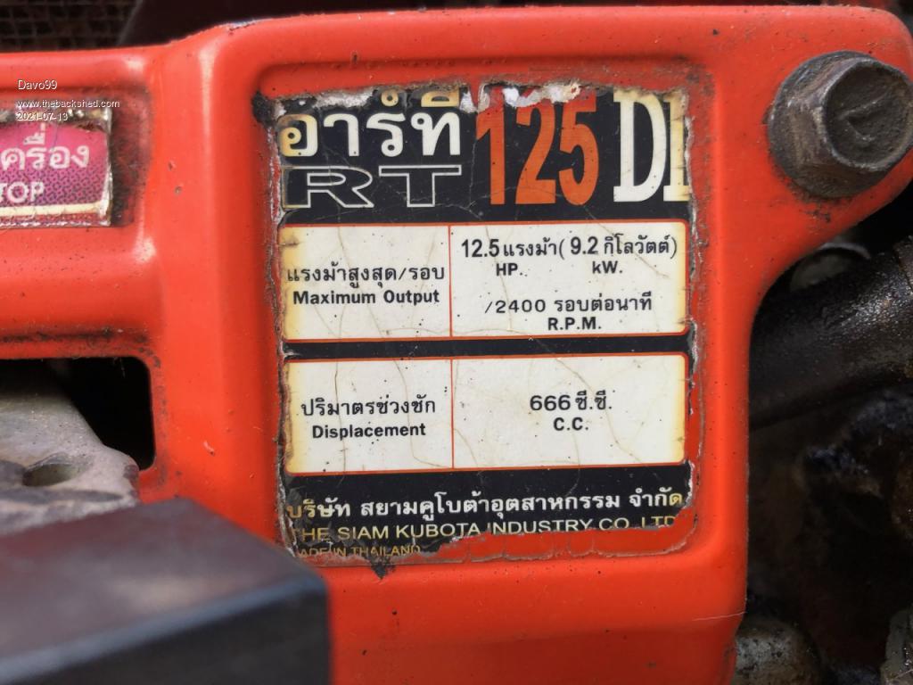

I'm still in 3 Minds as to how big an engine I'm going to need. I really think this place wants about 10Kw available to heat it properly in the cold.
That would mean about a 6 Hp engine to get the heat directly from and to use with the electricity which could be used to run the AC.  I sort of have a gap in engine size there between 4 Hp and 12 Hp.  The 12's are big buggers and with the suitable Motor, are not going to be light or small. The 5 Hp with the 4 Kw motor would be a lot more compact but Might only do 6 KW of heat.  There is a 7.5 Kw 3 Phase motor near me that  I could probably get cheap enough and would be good for about 5 Kw electric generation but would also over clock the engines I would want to use.
I have a 10 Hp water-cooled Diesel but that thing has no electric start and I can't even crank the thing over fast enough on it's own to get it to spin through compression. Putting an electric start would not be easy or compact I don't think.

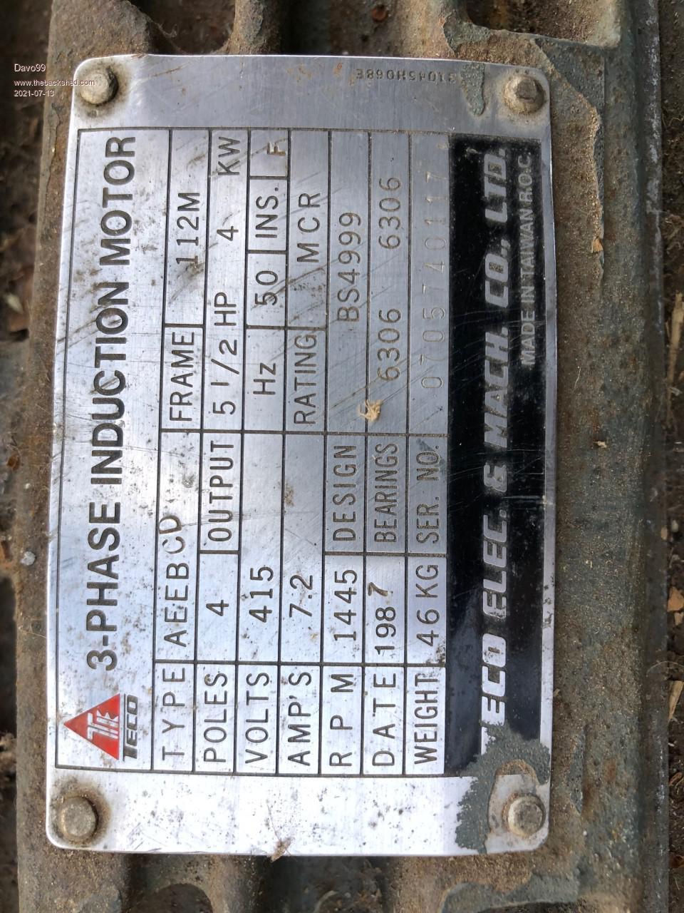

Went out yesterday and got another steel Rack.  With the two of them stacked, I probably have enough headroom for a Lister in there.
Also managed to pick up some more Ply and some more pallets.
Not sure which way to go now. Sure be a lot easier to cover this with just ply but If I do it with the pallet slats there may be a bit more soundproofing. and it may also look a bit more decorative than the plain play.  Be a hell of a lot quicker and easier with the ply as well.
Went back to bunnys for for screws and things and saw they have the soundproofing insulation in stock.  I'll guarantee the fkers won't have it the day I go there to buy it as is always the case but they have it now.  From what I can see, it's really no different to the other stuff, just thinker which gives it a Higher R value.
I'll wait till I decide the engine I'm going to use and the size of the enclosure as there are 2 Pack sizes the stuff comes in so I'll work out the area and the best size batts I  will need.  I was going to spray glue and Chicken wire the stuff in place but it would be good to cover it in some sort of foil I think for neatness and so it was less likely to absorb oil or fuel spills.
Foil may add some more sound Proofing.

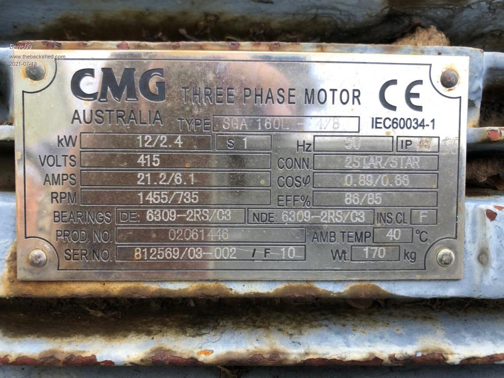

I realised yesterday that the Big motor I have is a 2 speed. That may be handy for gearing as the engines I have use 3 Bolt Pulleys which are hard ( impossible) to get in larger sizes and really too small for the pulleys on the motors which I don't want to make any smaller and have problems with belt slip due to limited contact drive area.
It's a big motor though and would be so under driven for the weight and size I'll really have to think about this.  I'll look at the 12 Hp Motor and how that will fit in the frame work.  That is going to make for one heavy setup there so then I'll have to look at the all up weight and see how portable it's going to be and if the tractor will be able to put it where I want.

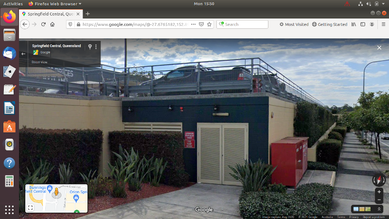

Its not uncommon to have a Genset or hydrant booster to be in a concrete box, or something close to it.
I saw this under the bunnings car park, When I used to shop at Masters next door......
First time I saw this, there was a lot of soot stains (3 exhaust outlets) before they painted it blue, And initially I assumed it was a set of generators to supply the shopping centre across the road, but now it looks more like hydrant boosters for when the power is out.
If you look at the Ventilation on the wall, they look similar to silenced gensets I have seen and not much sound gets out of them, I think that is a frame with many pieces of angle to deflect the sound and still provide plenty of airflow, there is something like that in the shed but I cant find it at the moment.
Cheers Aaron

  Quote   but now it looks more like hydrant boosters for when the power is out.
I bet that is it although there may be an emergency generator as well being 3 exhausts.
I used to play High rise Baby sitting as a Building manager.  One of the properties had 2 sizeable engines in the  basement.  One was a fire pump, the other a generator.
They had block heaters that must have used a shipload of power as the whole room they were in was always hot let alone warm where the other basement areas were always quite chilly.  From memory the engines were kept at 40o so if needed, they were able to go from a dead start to instant flat out and would have decent oil flow and not have hard starting problems.
They were fired every month for an hour and run through a test cycle. I think it was every 3 Months someone came in and ran them and certified them.

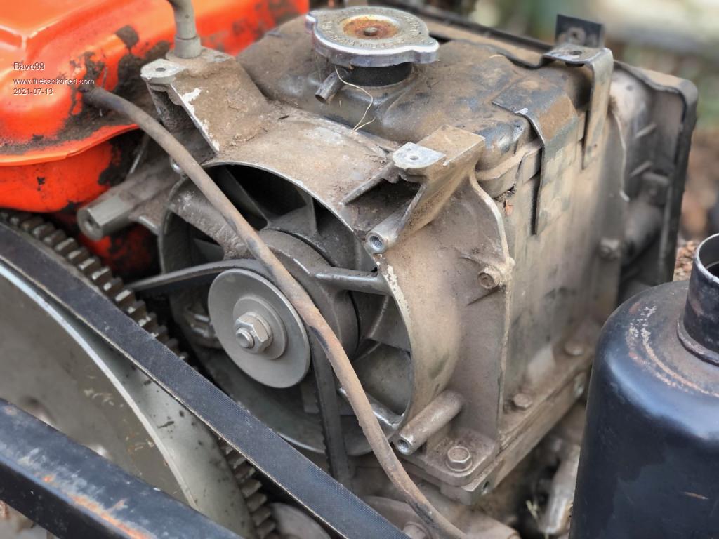

The pump engines I got were all aircooled, single cyl engines bar one. The multis tended to be 40 Hp and up WC. The little ones were not in big demand and I got them pretty cheap... which was why I bought them. Some the guy had been advertising for 2 years and my lowball offer was the only one he got. I think the 3rd one I got he rang me and said Come and get it, I know if you don't buy it the thing will only be scrap... so I went and picked it up to add to the collection of my diesel ornaments.
The Multis sold OK and usually went complete with the pump as people used them on fire/water trucks and for irrigation. I don't remember seeing any little Multi Yanmar/ Kubota sizes on these. I do have a 30 Hp Aircooled Ruggerini Twin I bought for $200. I think that one has about 23 Hours on it. Might be less.
Lovely little engine and would be perfect if it were not air cooled. Would be perfect in a little farm buggy or a cross kart or something.

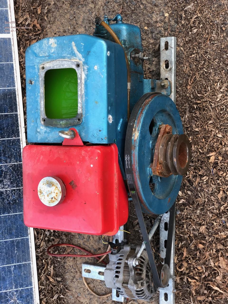

I bought a single cylinder 12Hp air cooled Wisconsin generator ($50 not going no carburetor) but the alternator was also stuffed. This was direct coupled and originally ran at 3,000 rpm, and was very noisy.
So what I did was hook it up to a tradmill motor with pulley drive, and now only run the Wisconsin at 1,000 rpm. That made a huge difference to the noise level, but its probably now only about 1.5Hp to 2Hp at that speed.
That is fine, 100v at around 8-10 amps dc is all I really need for slow charging a battery. Its only a 50Ah battery anyway.
This now also has a 60 amp car alternator, electric start, and a proper ignition system.
Just need to get a natural gas carburetor for it, but it runs fine now on petrol.
Its really all a pile of recycled junk, and cost almost nothing to put together, but pretty happy with how its all turned out.

I need to fit a starter to one of my big Chinaahh Diesels.
Not going to be an easy job on that engine though.  I don't know how anyone could Possibly crank start that beast. I have an Old Kubota with a ring gear flywheel and a starter  about the same size HP but pretty sure the Chynaah diesels are based on the Yanmar engines.
Back in my ( much) younger days, I used to do a lot of small engine repair before and after work for extra Income. I used to set the points on the engines by taking the plug out and Spinning the flywheel and hanging on to the HT Lead. You could always tell by the belt you got where you were at. The best gap was never the one specified, if I had the specs for that engine anyway.  Maybe wear or the crudeness of the system saw to that.
On engines that had a Timing plate, I used to file out the holes so I could give them a bit more advance. That used to wake them up particularly the Victa 2 Strokes.
Later on the little electronic Modules came along that replaced the points and condensor. You can still get them to retro fit and they work Very will indeed and are totally Maintenance free. I used to just put them in as part of the rebuild. They weren't much more than what the points and condensor cost but made the engines a lot more reliable and the customers never brought them back for Ignition troubles.
I have often thought of getting a Petrol engine and an injection pump and injector off a small Diesel and trying to get a petrol engine to run on diesel. Would want to Shave the head and get the compression up and need a cam that the injection pump could run off.  I think it would work and as long as the engines weren't flogged too hard, should last OK.
The gokart guys hot the 5 Hp Chynaah engines up and get 20HP plus out of them on stock crank and bearings and only change the piston to match the Lightened flywheels for more revs so I think they would survive fine at rated power on Diesel.
I might try and Drag my 12 Hp engine out today and see how it fits up in the racking I got. If that's OK I'll get out the big motor and try that then see how heavy it's all going to be.  I remembered there may be a 5 Hp up Diesel up there but can't remember if it's electric. Actually, Now I think of it, I believe it is but I seem to recall it's also an air cooled.  Bugger.  Spotted it buried the other day while Digging around. That will take some exhumation.  Also found an 8 Hp but that's Air cooled as well.
Think I should sell some of these and put the money towards an inline Kubota.
