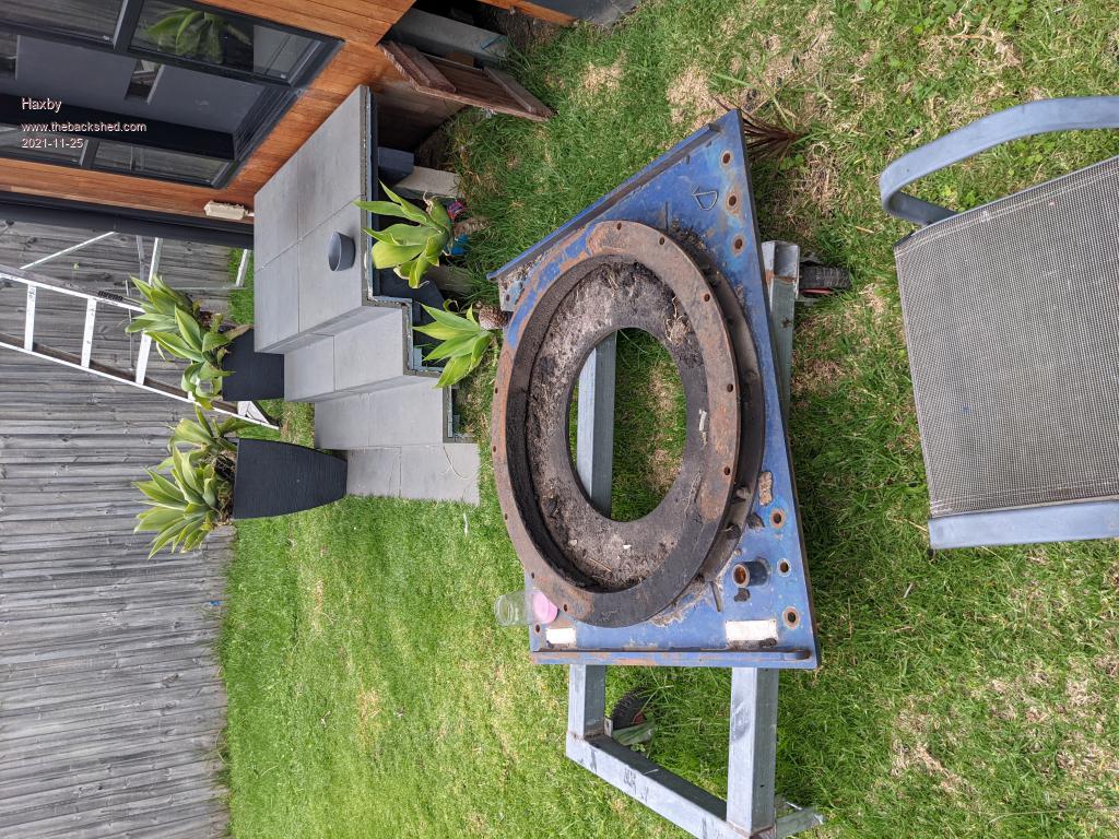

I live down the end of a skinny driveway, and it's hard to reverse the car out onto the road. Also it's hard to turn the car around at the house end due to lack of room. The solution, of course, is a car turntable!!! Can't be too hard to build one, right?
So I bought a 1m diameter bearing, a 3 horsepower 3 phase motor and a VFD as a starting point....
The bearing is courtesy of a truck coupling. This is the bit that a Prime Mover truck connects it's trailer to. I'm told it's rated for 40 tonne, so it should be plenty. It spins freely by hand.
It comes on a 12mm steel base, and is very very heavy.

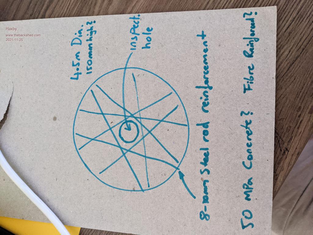

Now my original thoughts were to weld up a steel platform on top of this, and have the traditional castor wheels on the outside circumference.... but then I thought it might just be easier to form out and pour a reinforced circular concrete slab directly on top of the bearing, with a circular centre void to be able to grease up the bearing periodically. No outer castors at all, so the concrete would have to withstand a cantilever force as the car drives on top of the slab.
So my question for the group is whether there are any concrete experts here that could advise on what type of concrete to use, and what reinforcing to use. Just off the top of my head, I'm thinking 8mm steel rods running at a tangent to the centre inspection hole.
All thoughts appreciated!
Bryan1
Joined: 22/02/2006
Posts: 2300
Posted: 07:56am 25 Nov 2021
OK firstly a 4.5M diameter by .15 thick slab will break on the first test if a heavyduty rio cage isn't built and 150mm is too thin to take the load of a small car let alone a 4WD.
One would be better served fabricating up a steel turn table and heayduty one at that and outer caster would be needed. A steel fabrication mob could roll some PFC to the required diameter for the outer caster/rollers which would support the weight.
but with the cost of doing all this it would be much cheaper just to do some earth works and concrete in a round about so the cars can turn around

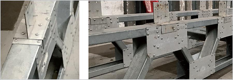

my local car wash has a turntable... just steel checker plate on the top but it has "sagged" - dips in the bed between the ribs, over the years with the constant weight. Its a steel "spider web" underneath with rollers on the circumference. could do with more ribs to  counteract the sagging
A bit like the one in the middle here  but car sized.
this PDF off their website might give you some ideas
Spin-It-Driveway-Car-Turntables-2021-brochure-1.zip
This is a nice project you got going... I would love to work on the control system... ring gear or spindle driven? sensing the stops, soft approach, monitoring current draw to detect jams etc... what fun and a practical result. Nice!
