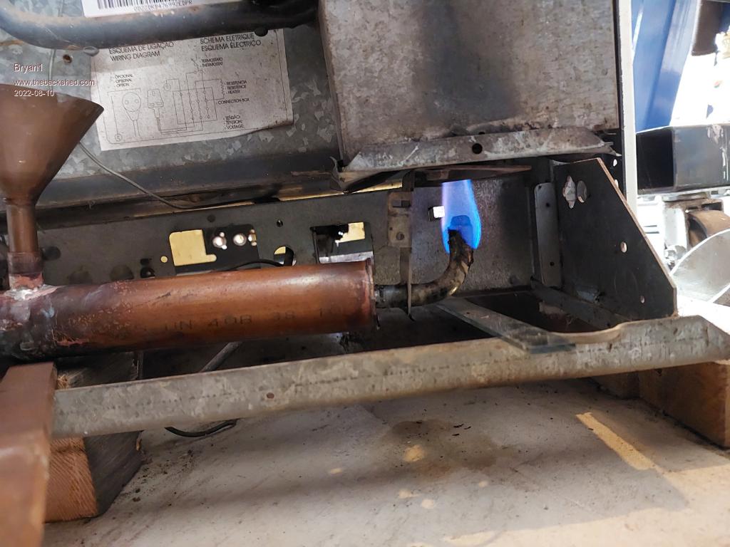

           Back when we bought the farm we bought a lpg/electric fridge and it worked for a few years then the gas reg clogged up due to dirty house LPG bottles. So this fridge has sat in my shed ever since and i decided time for a bit of fun
I do have 2 off 12 volt batteries from my '06 Subi Outback sitting on my radio circuit which has ran for close to 2 decades using those free nickel iron batteries.I went and bought a 12 volt 600 watt inverter for under $100 bucks and hooked up the fridge to see if it still works. Well the current draw on the batteries is 22.6 amps and only being 45AH starting batteries they didn't last more than an hour before going down to 11 volts.
So I thought well it is fun making burners and my moonshine being at 90% for my neutral as it does need another run to get rid off all taste. Ran it twice now and 3rd time is needed.
So the old gas burner that a weird thread that wasn't standard and a 1/2" pipe OD, so I made a 200mm long chamber out of copper pipe and put a 1/2" hole in one end to hold the burner.

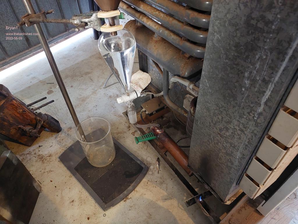

Keeping the liquid level at the right level is the key to burning a nice flame and I did find tilting the rear end up produced a much better flame and I used my separatory funnel to at first deliver a drop every 8 sec's but found i did need to increase the drip rate to about 3 seconds. Now the funnel size is 250ml and I reckon from rate of the drop it will go over night and still be going in the morning.
This is a temp setup to prove it works then I'll make a permanent setup with a drip glass window and needle valve to set the correct flow. If too much is metered it will pour out the burner and cause a fire.
I did find a copper reducer to put over the flame so it could get a good burn and in that picture is an inverted view of the flame with that mirror.

Well had a look this morning and the burner had gone out and while I had it apart to try out some air.fuel ratios silly me broke the solder joint on the burn pipe. So cleaned it up and decided mount facing down so the chamber which holds 150ml is facing down at the back. This will cause the fluid level to stay constant and I did shove some SS scrubber up the burn pipe to stop surges of fluid if I over fill it.
Well with this setup the flame is the best yet and in the next few hours see if I can get this ammonia boiling to kick start the fridge.
Edit:
Now for the flow rate and with 20 drips it amounts to 0.5ml and just now it took 45 seconds to do the 20. I have the chamber full and with the drip rate getting a slight over flow which improves the burn size by a huge factor and finally the fridge is starting up just off the moonshine
Cheers Bryan

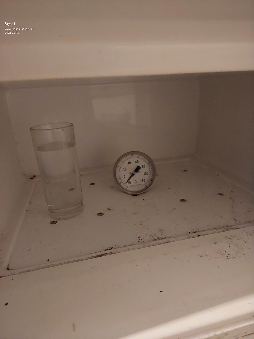

       Got the 20 drip flow rate down to 30 seconds and by over driving the burner I worked out about 1ml  minute so around 1.4 litres a day
The freezer is now down to -3 degrees and the fridge down to 6 degrees so the goal is too see if this will go all night.

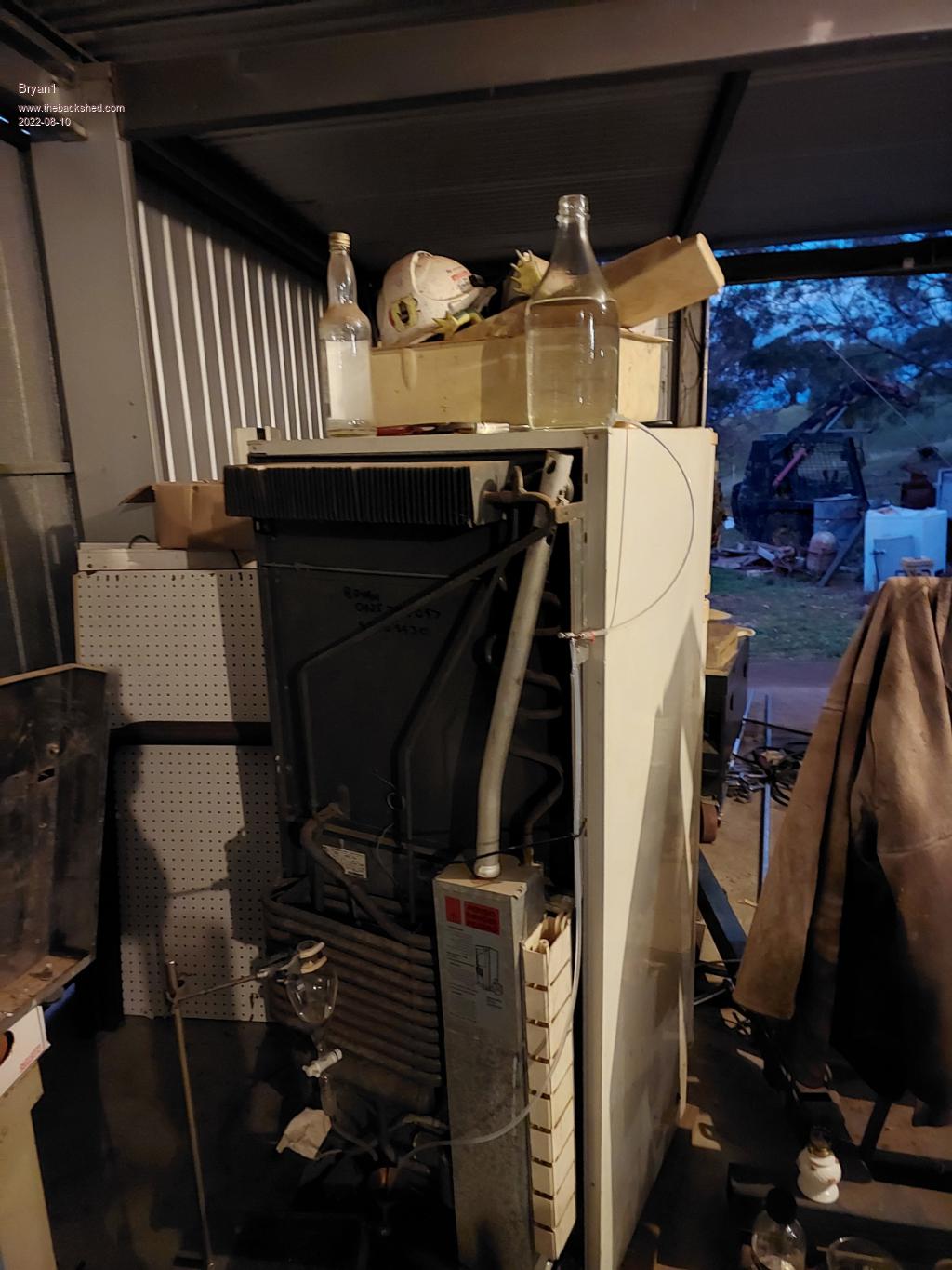

I'm making up a new permanent drip fixture and I'll use a fuel tap off a RC car and use some 1/8" teflon hose. The main hopper is a 2 litre goon bottle and I drilled a 10mm hole in and I had a rubber grommet and for a solid mount epoxied the joint.
Cheers Bryan

G'day Guy's,
           YAY got the fridge working nicely now and setup an overnight solution
It was fun connecting the RC fuel throttle and I found on one section it was only 2.5mm so got some 1/8" copper tube and screwed it into the tube and cut a silicon washer so the nut could press on it to ensure a seal.
Now getting the burner to just over run proved what was needed to kick start the fridge
and the best part
So it will be interesting to see with the new drip arrangement if it stays going over night and the level left in the 2 litre bottle.
