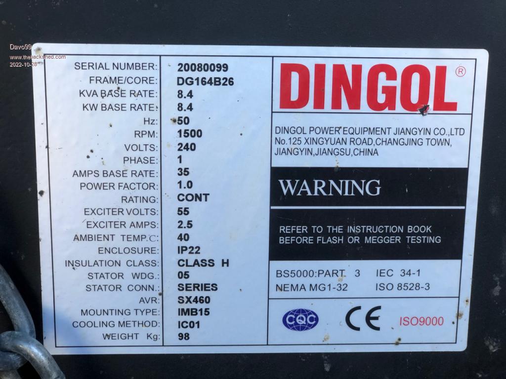

Specs on outside of the machine:

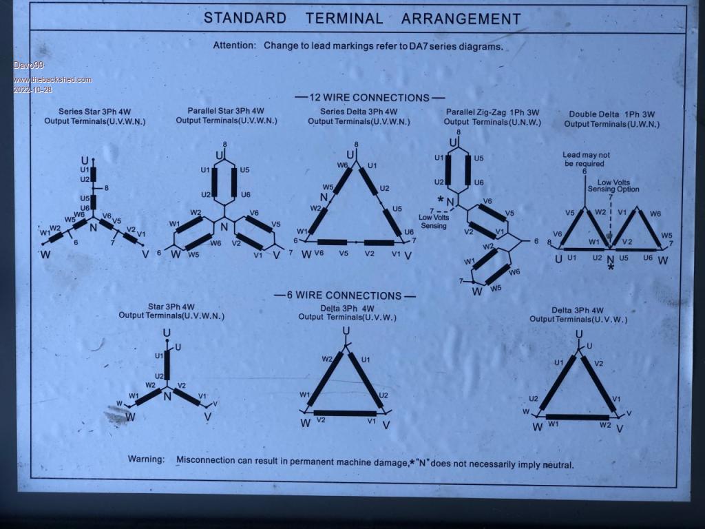

Diagrams under Dog box lid:

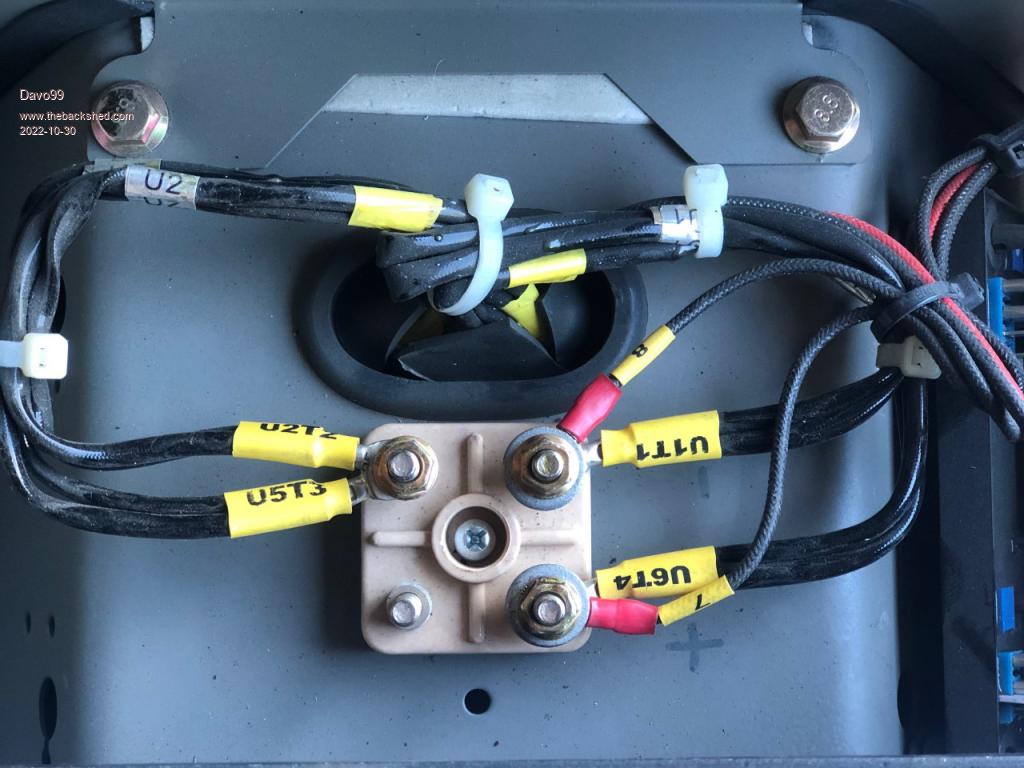

Terminals in dog box:
https://www.facebook.com/marketplace/item/232675062383765/
The thing does have an AVR which is connected.  I have no idea what the drawn on pos and neg markings are.
Previous owner said he had run and tested it but it did not do what he wanted ( although didn't answer when I asked what that was ) and I have not yet connected it to an engine.
Looking at where the AVR is it may be in single Phase atm but the marking on the leads are confusing.

Since the nameplate indicates single phase it would have been wired as Parallel Zig-Zag when it left the factory. As long as no alterations have been made it should just work.
The stator is 3 phase dual voltage. The Zig-Zag connections create a vector sum of all three for single phase use.
Make sure the wire / terminal labels match the diagram and all should be well.

Each winding produces 120V so the vector sum in Zig-Zag is:-
(120 at 0 deg) + (120 at +60 deg) + (120 at -60 deg) = 240
U and W are active and neutral
N is the sensing point for the AVR.

Noticed the terminal Block pic link was wrong.
Had another look today while getting one of the diesels that has been sitting round a couple of years running. As I suspected Injector pump had gummed up which wasn't hard to clean but putting the thing back to engage the internal throttle lever took so time and re trys.
I think the Alternator may be set up for single phase atm  but I will re check the connections and write them down as the codes on the wires are a bit confusing as to what is written on the wiring diagrams.
Going by the connections of the AVR as well as the genset itself, I think it may be correct.

The wire numbers would suggest it is the Double Delta configuration (top right in the connection options diagram) active as + and neutral as -  in your photo. If it is a three phase stator there should be two more terminals where V5 joins W2 and V1 joins W6. Don't know what the T numbers are for.
If they aren't hidden elsewhere then it is probably a single phase stator with two 120V windings and all those connection options are for a different model.
I assume 7 & 8 go to the AVR.

Posts: 3389
Posted: 12:46am 31 Oct 2022
T number thoughts.
It's a 4 Terminal block and the wires are T1 to T4.
If T2 is moved to the empty terminal a link from T2 to T3 gives 240V or links from T1 to T3 and T2 to T4 give 120V.

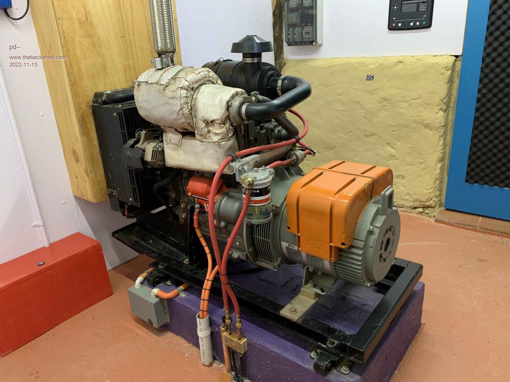

On the subject of keeping it quiet hear is what i built.
The room housing the genset is an extension onto an existing mudbrick garage
The engine bed was pored first with studs inbeded for the nisan patrol engine mounts that attach to the generators rigid frame.
the concrete slab is isolated from the engine bed using expansion gap fome.
The walls use steel studs packed with acoustic insulation " high density glass fiber "
the surface of the studs have 2mm mastic tape attached
then there is 12mm ply board
then 6mm cement sheet
on both sides
inlet and exhaust cooling air passes through a long padded box with two right angels
