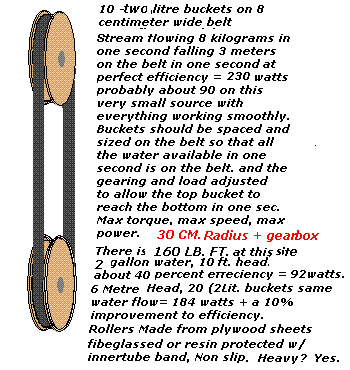

Automotive alternators are easy to come by.
and a belt speed of 3 meters per second will drive one at
540 rpm with a .3 meter pulley, No good. An axial flux
alt. should be used because of its low speed attributes.
It should be driven from an Idler pulley engaged to the
bucket belt.
