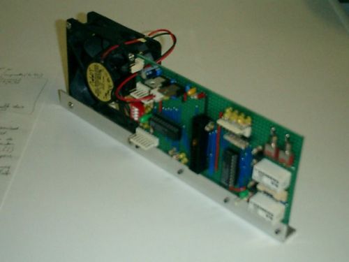

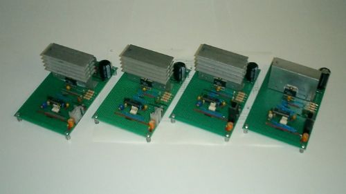

It's a basic design around the L297 & L298 (schematic stolen from Glenn's projects files, but it's a straight copy from the L297 datasheet anyway; full and half steps, 2A per phase) with some very minor improvements as more/better reverse-polarity protection and adding plenty of LEDs to indicate status of the power lines and outputs. One can never have enough status indicators in complicated systems like this.
Decided to settle for 4 channels (I really wanted to go for 5, but I only had 4 each L297s and L298s in the parts bin; that, plus the cabinet didn't have enough room for 5 driver boards).

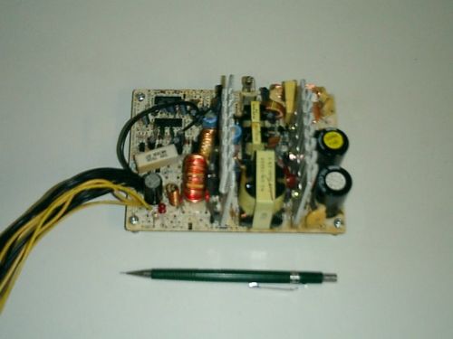

The power supply is (of course!) another Oztules-conversion job, a PC PSU modified to 24V/10A. But don't tell him... or he may want even more royalties.

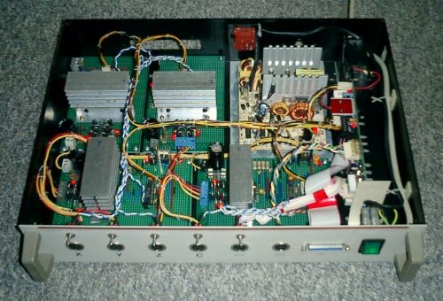

All combined and wired up it starts looking like this:

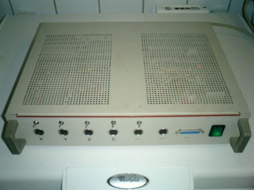

After final testing ready to box it up:

It passed all testing so far. Everything remains nice and cool (L298s, voltage regulators, computer power supply, etc.). The only things that get hot are the stepper motors themselves. Hot enough to cause burns.
Also gave the software (Mach3) a quick try-out, but my initial fears were confirmed: there are too many timing-jitter problems using this windows laptop with Mach3. The included 'drivertest.exe' software already hinted that this would likely be an issue with my configuration. Will soon give KCam a try; if that doesn't work, it will either be a dedicated PC with Linux EMC2 or some old DOS software. We'll see.

Vasi, I just counted (from memory) 43 LEDs in the device: 6 LEDs on each stepper board, one in the PSU, and 18 on the interface card.
What can I say... I like blinking lights
(in hindsight, I would have added 2 more LEDs per stepper board, to indicate direction and step pulse signals; at the time I didn't include them because I wasn't sure if the buffer IC could drive them (I even didn't know whether I would add buffers at all...); in hindsight, the 74HCT244 can take the extra load. There are step/dir LEDs on the interface card, but it would've been handy to have them on each stepper card too)
I figure they're not important in normal use... but when it's time to debug a problem it may provide a lot of immediate information at a glance, without having to resort to the multimeter or oscilloscope.
And credit where credit is due... Ron reminded me of the benefit of this (when I was still doubting whether to add them myself; guess he convinced me of something I already knew)
The LEDs also make it immediately obvious when (slowly) stepping whether the mode is half step or full step.
