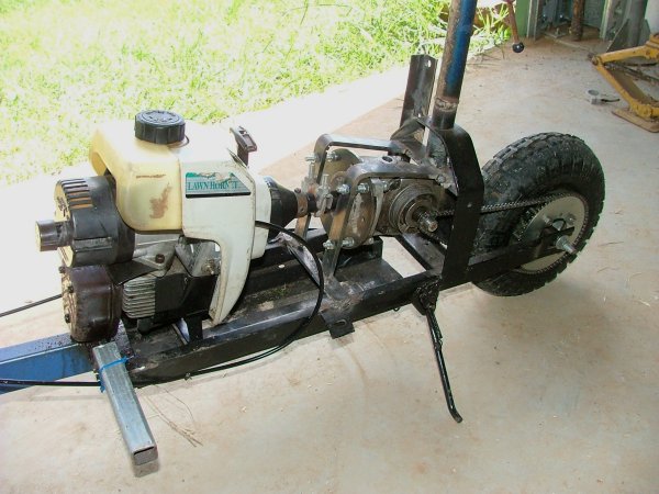

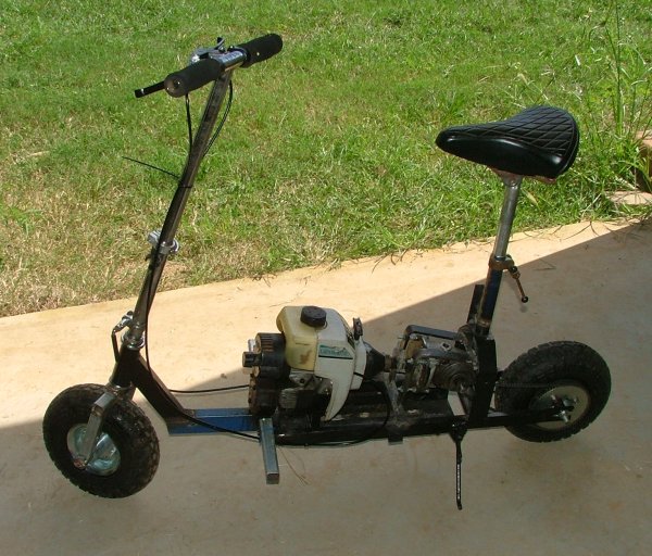

I picked up a busted electric scoota from a guy at work. He bought it for his kids a few months earlier, and one of them tried to drive up a gutter at full speed. Funny enough, it didn't like that, and smashed the front wheel and forks. So I was given half a scoota, the handle bars and front wheel were missing.
I had a handle bar from another scoota, all I needed was the hand grip speed control, and front wheel. I ordered a hand grip control from Oatley electronics, but what about the front wheel. The cheapest wheel I could find was $35. But then a mate suggested I buy a trolley from Bunnings, for $25 you get the trolley and TWO pump up tyres! Sold.
I fitted the controller and new wheel, and took the scoota for a spin. Well wasn't that depressing, this thing was gutless, and I had hoped it would have enough power to get up the hill to my place. You see I wanted a scoota so I could run down to the front gate to check the mail and take out the rubish.
OK, plan B. I had a 17cc 2 stroke whipper snipper doing nothing since I bought a new 4 stroke one. It has a centrifugal clutch, so would work on the scoota. I needed to reduce the gearing ratio more, so I used a gear box from a dead angle grinder, giving me an extra 4:1 ratio on top of the existing chain ratio. While I was at it I adapted a drum brake from the bike wreckers, the original brake system left a lot to be desired. A hand throttle was fitted and a tank full of gas saw me hooning around the yard with the dog determined to bite that front wheel.
But it still did not have enough grunt to get up the hill. I needed more power!
Plan C. A visit to the local dump came up with a 30cc whipper snipper for $25. It didn't go, but when I got it home I cleaned out the carbi, and she fired up. The new motor was fitted to the scoota with a little modification to the frame. Took it for a spin around the yard, and it sure had more power then the 17cc motor. Tried the hill, yes! It makes it up the hill, but is working darn hard.
Plan D and Plan E. I need a little more power. The whipper snippers have a terrible muffler system, very restrictive, so my next step it to build an expansion chamber exhaust system. If this still lacks power, I'll got back to electric.

Posted: 11:09am 24 May 2006
Update on the scoota.
I pulled the muffler apart to see just how restrictive it was. Inside there was a baffle plate, with 5 tiny 4mm holes. And the stinger outlet was about 8mm diameter. No wonder the motor was so quiet. I drilled about 20 5mm holes in the baffle plate, and made a new outlet pipe from some 12mm id pipe, and then crimped the muffler back together.
Boy did this make a difference. Its louder, as expected, but not that loud. A test drive around the yard felt like it had a lot more grunt off the line, but what about the hill?
I rode half way down the hill, turned around and headed back up. Well it rocketed up the hill ( as well as you would expect a whipper snipper powered scoota to "rocket" ), even the steep bits were easy.
So its now a success. I wonder what mileage it gets?
