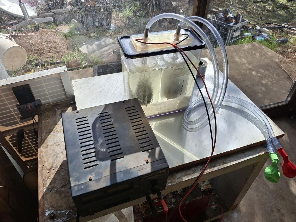

G'day Guy's
          A few weeks ago a mate showed me a youtube on water splitting which has been on my mind ever since. Now there are plenty of ways to go about this where a single outlet will give you HHO which is a very volatile mix to say the least.
So doing this on a budget where I found some whisks for $1.50 which sit inside a couple of soda water bottles and have a SS scrubber in each whisk and with the bases of the soda water bottles cut off the electrical contact can happen under the bottles.
Finally went on ebay agian to buy a 32 volt 10 amp lab power supply and sure enough the seller changed my order to a 120 volt 3 amp lab power supply. I messaged the seller within 5 minutes when I noticed the error and the next morning got a reply saying my order was corrected. Now as the 120 volt was around $30 dearer it will be interesting to see if a credit or refund is there but I doubt it. So I will get onto that after the unit arrives.
From the video I did watch he went from zero volt to around 6 volts for a 10 amp output now the whole point of this exercise is to power this straight off a solar panel where I just happen to have a spare 330 watt panel for the project.
This morning I assembled the unit and siliconed the top to keep the wires in place and seal the outlet so pic's can come in the next few days.
Now I do and ask several outlet for tubes got blank face from all but one where I got a tip to drive around the corner to a ag place and picked up 2off tractor tyre tubes got told they had puntures but they haven't lost pressure in 2 days so no leaks.
The first run I will be using balloons to check the output and see how long they take to fill.
Now to compress the gas into a lpg bottle an old fridge compressor will be used and if a higher pressure pump is needed I will just make one.
Enough for now and remember this all just fun.
Regards Bryan

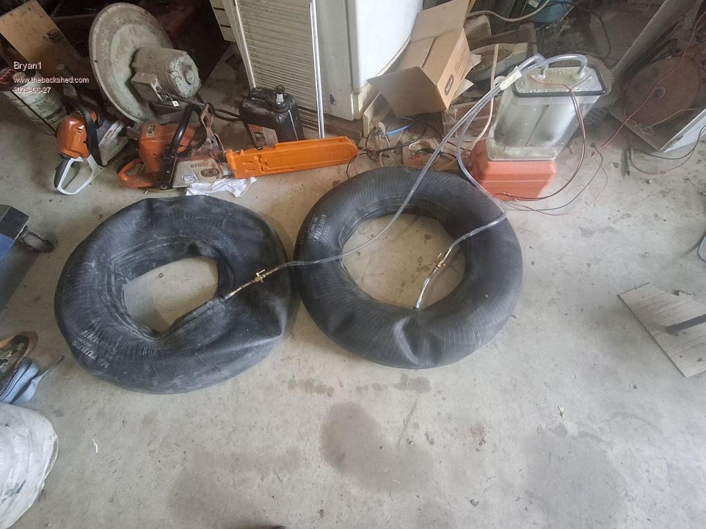

Well ran the unit again this morning and found there was a leak on the negative side under the wire, so bent the wire up and after drying the area with my heat gun put some more silicon on to seal it.
Left it for about 4 hours and ran it again where I noticed the balloons inflated pretty well straight away and stayed around the same size, I did notice the negative side water level went down to the point exposing the SS scrubbers so stopped the unit.
What surprised me was although the hydrogen balloon was pretty firm the water level hadn't dropped at all.
So the pressure of the rubber balloons is too great for the output of the unit so decided to deflate the tubes and I'll make the fittings tomorrow for them.

  Quote  What surprised me was although the hydrogen balloon was pretty firm the water level hadn't dropped at all.
The problem will be the unequal stiffness of the balloons. As the water can flow freely between the sides there can be almost zero difference in pressure between the two sides. So if one balloon requires more pressure to inflate than the other the water will move to the other side and not inflate the balloon any further.
Godoh's suggestion may be the way to go.

Now what I did fail to mention I took the balloon of the negative side first and the water level didn't raise at all it only when I took the balloon off the positive side the water level in the negative chamber leveled out.
So it does look like I may have a leak at the bottle tops and HHO is mixing above the water line so tomorrow I'll take it out let it dry and silicon up around the bottle tops.

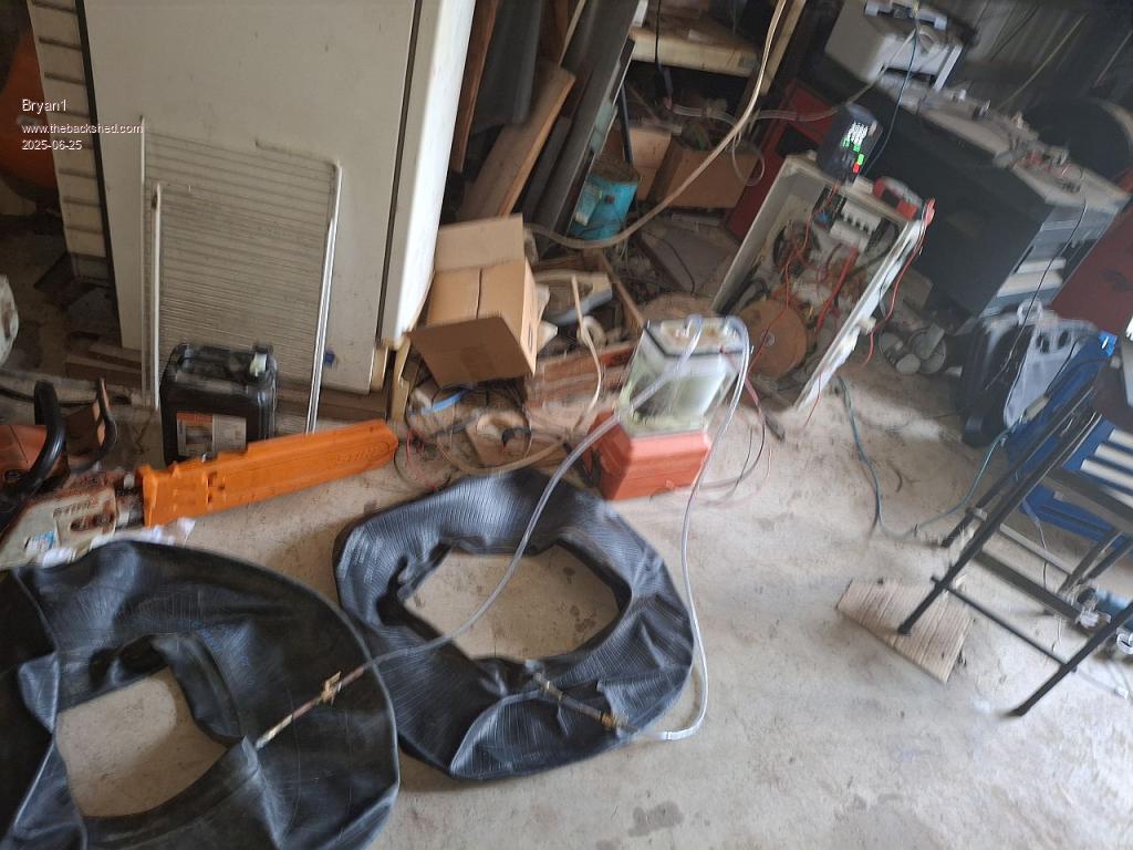

Well had 2 emails on Monday saying that 32 volt power supply had been delivered and it turned out they left it by my front gate and didn't even notify me.
So it has been thru one hell of alot rain and luckily the power supply was in a plastic bag and turning it on it works   The manual is soaked but there isn't much info so got very lucky.
Yesterday machined up the fittings for the tubes so now the job getting everything hooked up and letting the fun start.
Cheers Bryan

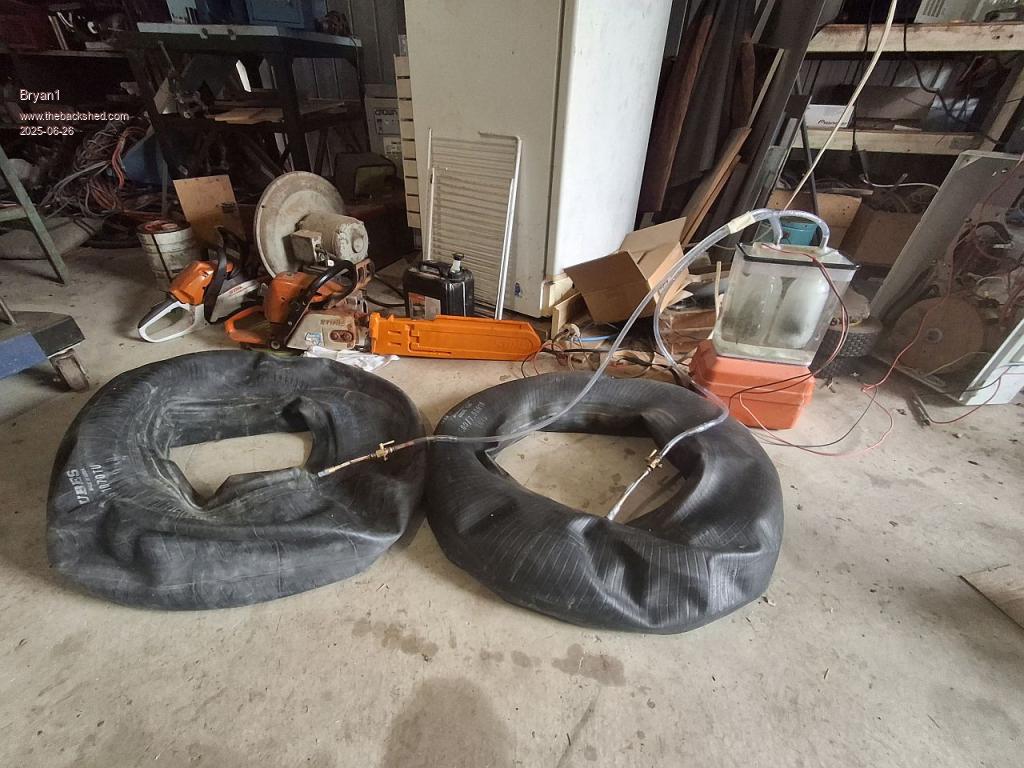

Well just came up to the shed and found the power supply was in OCP ( open circuit protection) and both of the tubes do have good signs of filling
Now what I expect is the amps slowly got to the max set point which was set at 8.3 amps so the OCD protection came in.
Now in that picture the tube on the left one can a distinct fold which now filled out and that one is the positive side ( Hydrogen ) and the other tube is is also filled out.
Just checked the battery voltage and I'd say it would of run for most of the night too and I'll run it all day today where I can keep an eye on it.
Cheers Bryan

Well been running the unit all day and just noticed the current output had dropped to nothing
Man the unit was warm so left it for half an hour and topped up the water with nice cold water. Got back running on 10 volts with a 3.451 amp current draw.
Now silly me had my wires crossed and it's the negative rail that outputs hydrogen not the positive rail. Now as we are making 2 hydrogen atoms to one oxygen atom the way the tubes were filling gave me the tip so checked it on google.
Anyway below is the output so far
So as we can see the tube on the right is the hydrogen and it is not far away from being filled   I do have some E sized oxy/acetylene bottles to use as the storage and sorted the fridge pump for the hookup, also had a copper outlet for the acetylene bottle which will make for easy filling.
Cheers Bryan

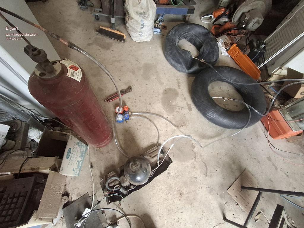

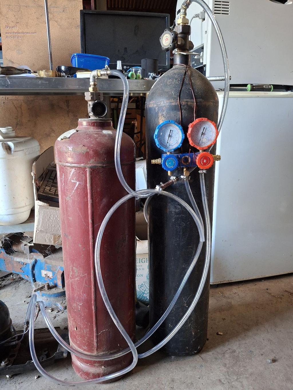

           Well decided to do the first decant just now and off the first batch got 20 PSI in the tank
Here is a pic of my decanting setup
First I pulled a vacuum on the tank using the fridge pump and used that cheapo gauge setup I got off ebay where found it only half finished. Anyway just using the ports I've found it's good for pulling vacuums and like today able to read the pressure attained.
I found the beauty of that clear plastic 8mm tube just a quick heat with a lighter then push it onto the 5/16" copper tube. Now I did find when I closed the valve on the tank the hose shot off as the fridge compressor was still going
Anyway I'm pretty happy it's only taken 2 days to do a cycle   also as the other tube is much larger I have left it and will decanter off the second run or sooner if needed.
Still a long way to go now it is looking good where for a few dollars one can make their own setup and best of all being off the grid the cost of power is zilch nada nothing
Regards Bryan
