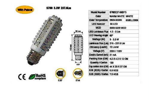

Hi Barry,
if 12 volt led `s are your fancy I have several options for you .
Have a look at the web address
http://www.hafele.com.au/isapi/online/reflections/reflection s.asp
There are several new options ,
This version is 240 volt but these are available in 12 volt DC.
There are 3.3 watts and 4.5 watts
I have samples and they are fantastic with the out put .
I run these in my house ( 240 volt ) but have 12 volt solar available .

Posted: 09:15am 04 Sep 2009
I am sorry I forgot to tell you that the 4.5 watt is equal to a 11 watt cfl globe .( 60 watt incandescent )
these are a real eye opener and of course look better in some sort of light fitting where you cannot look directly at the globe.
Beleive me they are great.

But the 'second gen.' leds are better; most of them have a small constant current controller embedded in the socket, and can often handle 8-30V.
Also, the Lumens/Watt are getting better; i would say that 70-120 l/W are good. The color temperature are also getting much better than the previous gen.; most of the better led bulbs today are available in the 2700K-3000K.
I got some led bulbs similar to the one Barry shows, but with 3x 3W leds and a temp at 2700K; not sure about the l/W, but it says 'similar to a 35W halogen'. Also, i just bought a bulb similar to the one Rep334 shows, but 220v at 8,1W with 82 l/W; excellent outdoor lighting.
