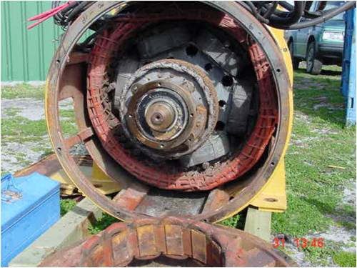

Posted: 09:48pm 27 Jan 2010
There are a few tons available in one of these if you stumble on one in your travels..... theres one outside my door actually.......
Microwave oven transformers are useful for laminates. Should be plenty of these available over there.
You need to be decent grade poor conducting steel to get the eddy currents down to reasonable levels.
Tinker, I think that that stuff and banding strip are good looking substitutes.... but are very average performers. They were tried with single disk axial flux machines before the dual rotor became common... they do still work to converge the flux.... but are very lossy as the frequency increases.
Insulated steel wire (or tomato wire thrown in a fire to rid the zinc and then left to rust in the weather) does a fair job in this application as well.... the rust is the insulator in this case
