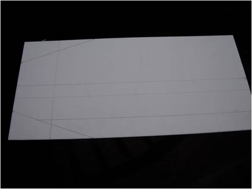

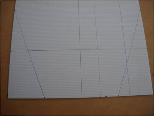

I start with a slab of 4mm Coroflute sign material; plastic corrugated
cardboard, if you will.
Next, I draw in all the cut and fold lines. This is what goes through my
head when I should be sleeping by the way!

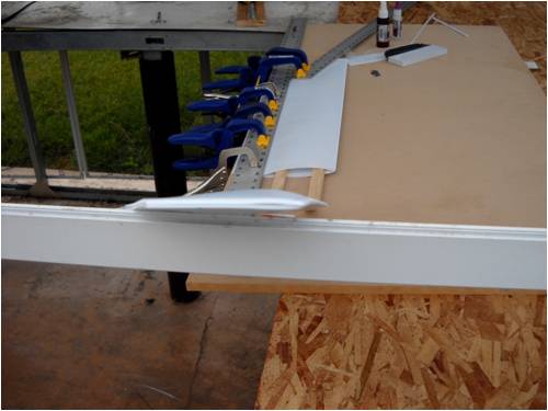

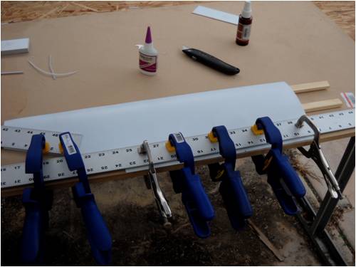

I use "Gap-Filling" CA (cyanoacrylate) glue to hold things together.
Gotta have lots of clamps. CA cures in about 2 hours. I "kick" the
seams. "Kicker" is a spray-on glue-cure accelerator. Smells lovely!

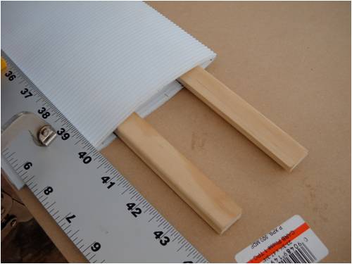

This shows the spars exiting the "root" of the wing. That's the inboard
edge next to the fuselage ("fuse"). The wing is 24" and the front spar
is 24", but it's pulled inboard 4" to allow me to "wash-out" the tip in
an effort to prevent "Tip Stall" at low speed. I use two spars because I
like to take chances and fly way, way, way too fast!

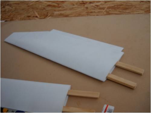

This shows one done (nearly) and one getting done. After the glue sets,
all that needs to happen is trimming the sharp corners, "kicking" the
trailing-edge seams, hardware (control horn) and paint. Note the
aileron is Coroflute also. More on that in a later picture.

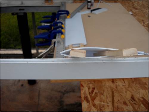

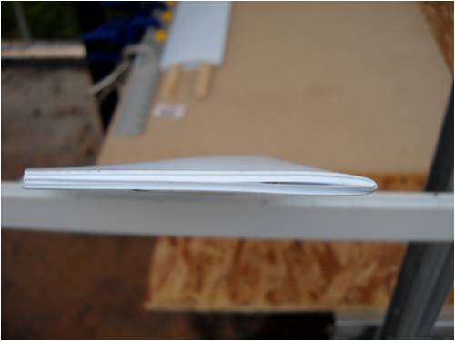

Here's a view down the wing from the root (inboard edge). There is a
slight wash-out just aft of the lower leading edge. Eipler does a trick
similar to this with their wings too; it makes them fly faster!

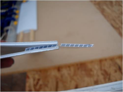

Here's that Coroflute aileron again. Note how it's made: One side of
one cell is cut out (no easy process I might add!!!) and the rest of it
"hinges" on the remaining plastic making up the other side of the cell.
This stuff can bend back and forth a zillion times and not break!
This is the wing tip. Note there is a small gap left open. This is to
make a place for more CA glue when I round the edges and do the
final clamping.

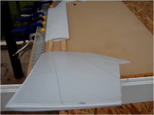

Here's a shot tip-to-root of the top surface of the new wing. It's
symmetrical-section for the most part, but I leave the front 2/3 almost
flat and wash out the front lower leading edge using clamps and a lot
of foul language!

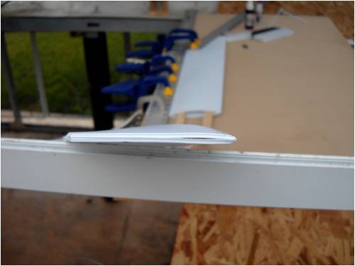

I'm trying to show that lower front leading edge in this shot. Don't know
how well it'll post; maybe just use your imagination, eh?

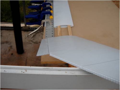

Here's the nearly-finished trailing edge and aileron. I'll trim the aileron
and make it blend with the curve of the back of the wing tip when I'm
all done; gotta make it pretty.
This final shot shows the view across the bottom of the wing. That
aileron is 14" long by the way. This plane will be anything but short on
control!

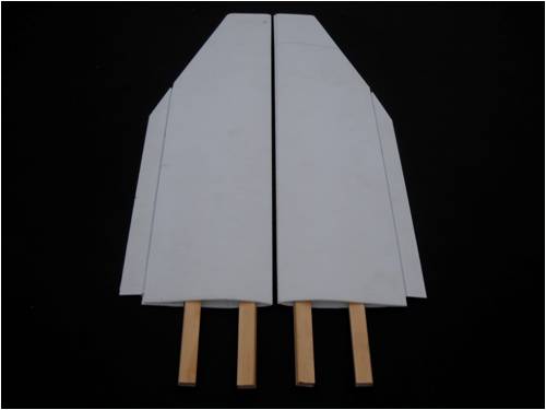

Update June 6, 2010

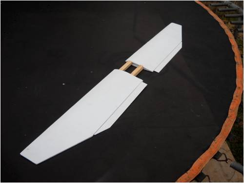

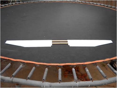

Finished the wings today. Here are the pictures:
Here are both wing halves lying side by side on the kids' trampoline
in my back yard.
Here's another view with the left wing atop the right at the center and
a little closer together.
Here's something to remember when you're scratch-building from your
head: Build a "left" and a "right" wing. They're mirror images of each
other and the last thing you need is two of one side! I only mention
this because I've made that mistake before; it happens
A little paint so we can tell top from bottom when this puppy is a thousand
feet high and some hardware then it's on to the next portion.
The fuse is next on my to-do list. After that, we'll stuff in the radio-
control gear and then we're off to test things out at the flying field.
