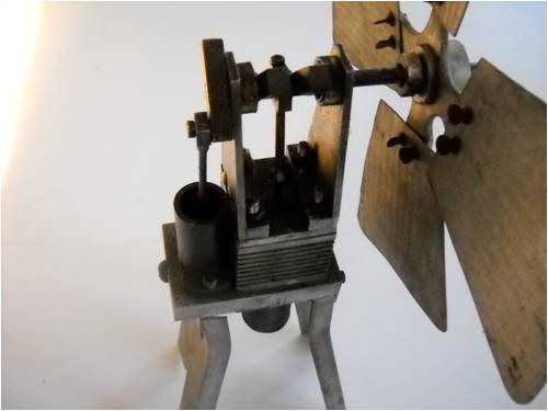

Just a quick follow-up note on Glen's idea of using a Sterling design: I've built them and if I can find a picture of the one I posted back in the day, I'l drag it into this post on an edit.
Here we go:
Note the square dark area just above the heating cylinder at direct center. There are fins cut
into the cylinder at this point and they use air pushed from the working fan to cool the air,
which was heated directly below that area. It's this cooling, which shrinks the air and "sucks"
the piston creating the power stroke.
Anyway, what you need to remember about a Sterling is that it's a "vacuum" engine. The power stroke comes from the air inside the engine cooling off 90 degrees before it is shuffled off to where it gets heated up again. As such, these engines are limited not so much by how much heat you can throw at them, rather by how efficiently you remove the heat you've added. As they heat up overall, they slow down.
I agree with you. A big ker-thunk, ker-thunk engine would be way more fun.
