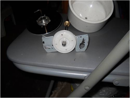

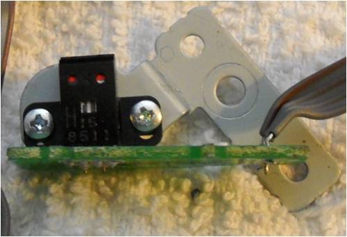

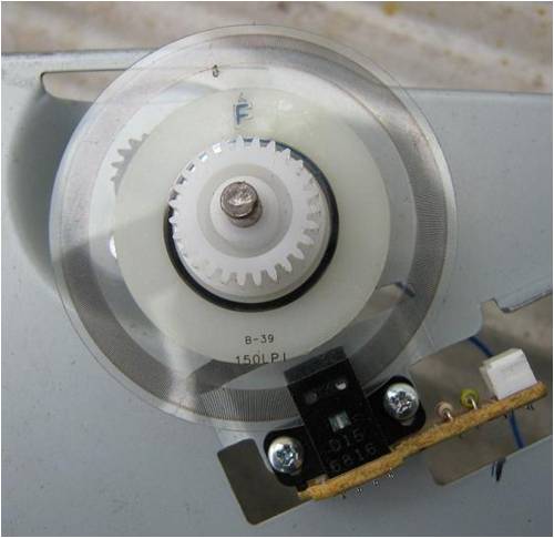

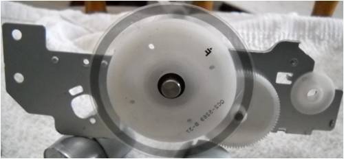

I dismantled a canon 2600 printer today it was the ink jet printer.
On the one side was a wheel and a clear plastic disk with what looks like a miniature brake caliper, would this be the octi coupler you speak of?
Could there be a pickaxe chip in this thing also? We possibly could get a picture of the remains tomorrow.

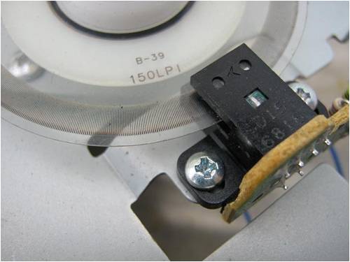

The clear plastic disc is the right part you want, and if you look carefully there is a grey ring around it, if you look through a magnifing glass you will see this grey ring is actually lots of black lines with a clear space between them.
This makes the photo interupter and we count the lines as they rotate through, over a given time period to calculate the wind speed.
The brake caliper (as you called it)or photo sensor is the laser diodes and you also require this part too.
I also used the metal bits the photo sensor was mounted on for a mounting bracket.
There is 2 laser diodes in the sensor so it can detect what direction the disc is rotated in, for this purpose we only use 1 set as it will always spin the same way.
The laser diodes work off 3 volt so by memory i used a dropper resistor.
Take a clear photo of the back side of the photo sensor board and i will see if i can figure the sensor wiring for you, as there will be a ground, 3v+ to the laser and a signal out from the photo transistor. (actually 2 signals out but we only need 1)
There will no Picaxe in the printer so you will need to source one and a 08M picaxe is all you will need (get a couple incase you fry one)

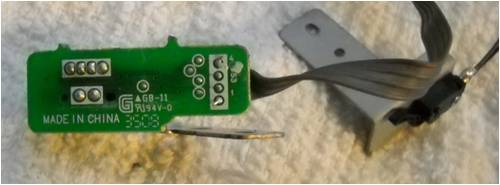

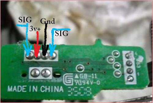

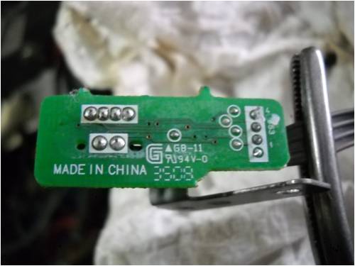

I had a look in a box of old printer bits and found these that should be simular to what you have.
Here you can see the black lines i had mentioned, by the look of the printed text it could be 150 Lines Per Inch
There is several different configurations with the wiring of the boards, here you can see i have marked the 3v+ input with a red mark and ground with a black mark and the other 2 pins in blue are signal out
Here is a different board with a different pin configuration, marked as before.
Your board might be different again and is why i ask for a photo.
For your interest there will also be a straight plastic strip about a foot long with a photo sensor at the back of the printer carrage that you might have a use for in a different project. (Linear travel)
Lots of good little sensors in a bubblejet if you look carefully.

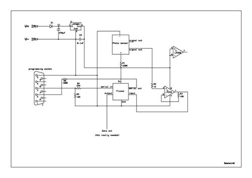

I fired a sensor up and got some values for you.
At 3 volt input they draw around 20mA so will require a 330 ohm dropper resistor for 5 volt operation.
The signal out swings between 0 volts and 0.3 volt so you will need to feed it through a Op-amp or a comparator with around a 10 to 1 gain so the picaxe can detect it.
If you want to display the data on a lcd and dont wish to use a serial lcd than it might be best to use a 20x2 picaxe instead of a 08m as the 20x2 has enough pins to drive the lcd direct.
If you would like to display the data on a computer and even record it on the PC than a 08m picaxe would do fine. ( the 20x2 will also allow for data logging)
Ok i have hit you with a few things to consider but dont be frightened off as the electronics are rather easy, and you will have a very good anemometer of high resolution when completed.
This will also give you a good foot in the door to be able to log data from the wind and your mills.
Once you see how easy it is to record data from wind speed you will find the next step of recording (logging) data from your windmills a easy step to take.
If you are happy with a wind speed resolution of 1 to 5 minutes than an anemometer with just 1 target per revolution is fine, but it is almost useless should you wish to log other data in the future as it slows up the logging rate to be almost useless.
I sample the wind speed 4 times a second with the printer sensor system.
Here is a schematic of the basic system required, this will allow you to record/display the data to a PC and it could be expanded to allow a lcd.
Pete.
Heres a download PDF or the schematic (much easier to see)
2010-12-20_182539_anemometer.pdf

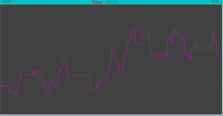

Here is a graph of windspeed at my place measured with the code above. This is a 3min time window, recorded at 1sec intervals. I have recorded data to a resolution of 1kph, but display to a resolution of 2kph. The range is from 6kph to 30kph. Breezes change speed relatively slowly, but wind changes speed quite quickly. [approx 2kph/sec at these relatively low windspeeds]
If I was to record at 10 readings/sec, then there would be benefit to have a display resolution of 0.1kph, to show a smmother graph.

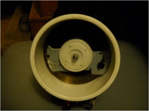

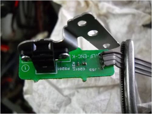

Here is isaiah's photos; they look very close to what Pete posted.
Bob

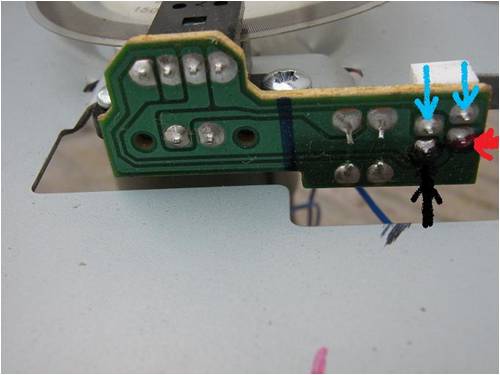

Bugger the tracks are on the other side of the board and my Chinese made crystal ball is broken, and i cant find my xray glasses.
You might need to add another photo showing the tracks.
Pete.

Posted: 08:03pm 21 Dec 2010
Maybe these will be better...
Bob

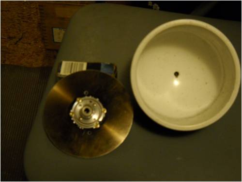

I did dismantle two old VCR's today and found 1 motor in each that has a double bearing that runs real smooth.
Some of the outsides of this motor are 2 1/2 inches,I was thinking of some sort of pvc Pipe to put it in.
The outside diameter of this motor is just a bit smaller than the opticoupler.
It may work out good but the shafts are different diameter.
I was thinking of making like paddles rather than using cups.
I'm thinking of cutting something out of pvc pipe and gluing it on to the top (or bottom) of the rotor.There was some other small motors in there a axial flux and small pm motors. and a 120v power supply that Bub will have to see if he can use for something.

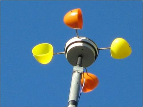

Downwind
Joined: 09/09/2009
Posts: 2333
Posted: 05:18am 22 Dec 2010

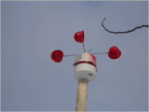

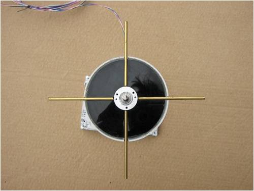

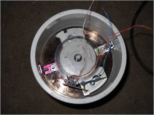

I did not take a lot of photos of the last anemometer i built but there is a few back in the thread i posted a link to earlier on page 1 for you.
The housing was made from a 75mm (3") pvc stormwater pipe cap, with a ring of 90mm stormwater pvc pipe lapping over the cap so as to make a rain proof seal.
I cut a disc of plastic (the black bit) and routed 4 cross grooves in it for my 1/8 brass spokes to fit into.
I used a little silicon to stick them in and sandwich them between another top plate (in this case it was one of the platters from a Hdd)
The cups were Easter egg molds ( a bag of 10 for a $1.00)
The bearing assembly was the motor from a computer hard disk drive (Hdd)with the iron core and coil windings removed from the motor.
The photo interrupter disc had the plastic centre mount drilled out and cut to shape to fit into the bottom of the Hdd motor where the coils were and it all glued in with silicon.
It is very important to get the disc level as if it touches the photo sensor as it spins through the narrow gap it will rub the black lines off the disc and then not work.
It is important to keep the weight down to a minimum as this will effect how the anemometer will accelerate and slow in the changing wind.
I would not use paddles as the weight will be to heavy out there, one i built earlier used on under arm deodorant caps that was dome shaped.
As mine has about a 12" diameter out where the cups are, i used 4 cups as 3 cups and a large dia. they become a little sparse between the cups (3 is ok on a small dia.)
Also i was lazy and to cut a cross to locate the spokes was easier than trying to get 3 equal sections.
As for old video parts there will be some good motor driver chips on the board too the Bub might find a good use for. I have ratted many over the years for driver chips.
As i said the hard part is building the actual anemometer, the electronics is not so hard.
The whole thing is build one and see how it goes as you will then have a good idea on what to do for the second one as it is likely you will end up making more than one as i did.
Mine works on a wireless transmitter for sending the data, but as you said there can be issues with using wireless and if you are not into electronics than a wired system if a lot more fool proof.
Pete.

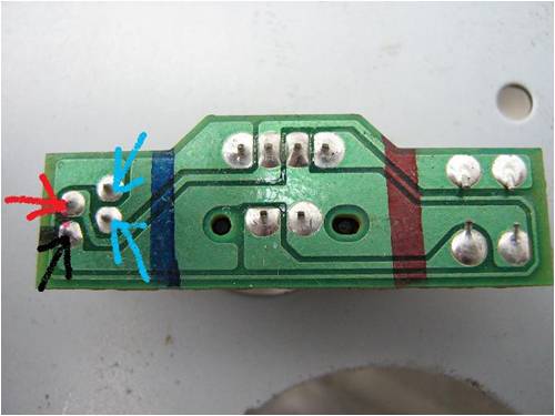

For the wiring of the sensor i think this should be correct from what i can work out.
You can use either "SIG" (signal output) as it wont matter in this case.
I would solder wires direct onto the spots where i have indicated and bypass any exsisting circuit.
Pete.Edited by Downwind 2010-12-23

Posted: 03:24am 27 Dec 2010
Well I went in to Home Depot today and a 4'' pvc cap is $7.35 ea.
The diameter of the opti disk and sensor I need about 4'' to get it in.
So I brought some home.I also got some 2 inch and 1 1/2 inch pvc caps to try for the wind cups if they aren't too heavy. Now I have to figure how to fasten this stuff inside the pipe cap. And We have to know where we can find a transmitter to make this wireless and a leanyer amplifier to make sure the signal get to the house!!
