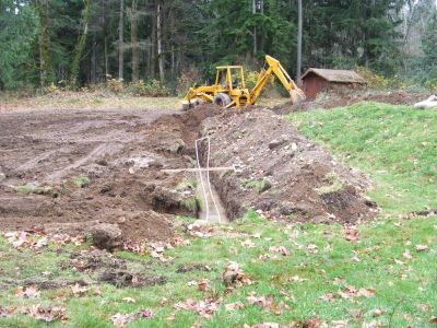

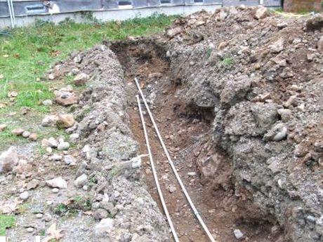

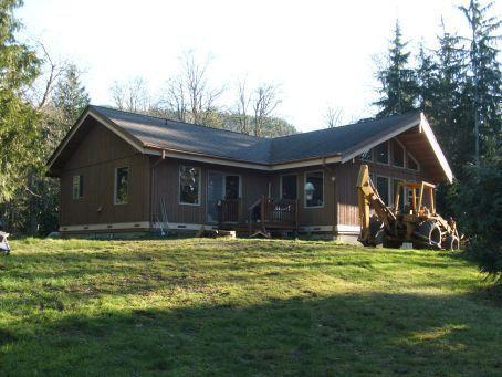

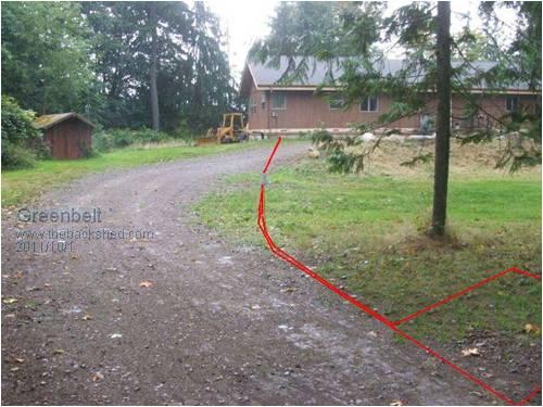

The First picture is my house from the pretty side,
Pic. # 2-0 is the opposite side of the house, The last ditch to be filled in, The Hoe is parked where the pipe will make a right turn and go up hill to the house. The Water in the ditch was 60 CM. deep (2 feet), I joined the pipes temporarily to keep the mud out. In this pic. the pipes are 30 feet short of reaching the end of the ditch. BTW, My House sits on a solid rock, I had to rent a backhoe with a hydraulic hammer to carve a rut for the footing concrete.

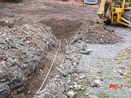

Pic. # 3-0 is taken from the end of the run, down the up hill ditch, this is where the pipes terminate until I connect the Tank for the water/antifreeze solution.

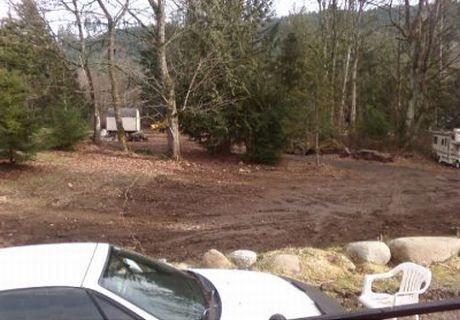

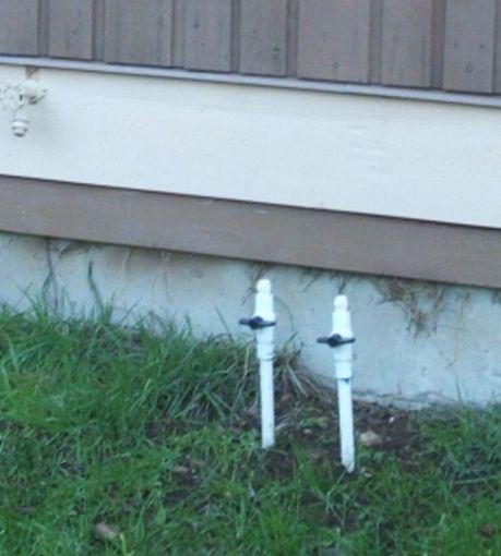

Pic. # 4-0 End of pipes.

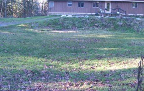

Pic. # 5-0 The area after covering the Ditches.
Pic. # 6-0 The grass has come back over the buried pipe area.

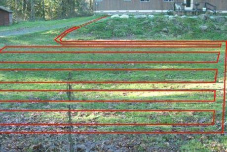

Pic. # 7-0 This is the general layout of the pvc. marked in red
Pic. # 8-0 As the pipes look now,

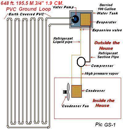

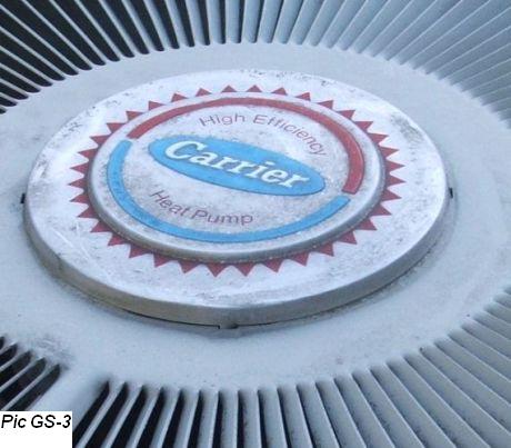

The GSHP,
The Pic. GS#1 is the layout plan for the Ground source heat pump.
Gs-2 and GS-3, a Carrier brand Heat pump outside unit rated at 2 ton (24000 btu.per hour.
I found this on (craigslist,)< Google, for $40.oo The compressor is OK and the Fan works, no signs of damage.
The person that sold it to me said it had been sitting in the garage for over two years. She did not know where the inside coil was. Now I will need a Condenser to make this system complete.
It is much to nice to strip down for parts so I will keep it as is, and do a standard air to air Installation.

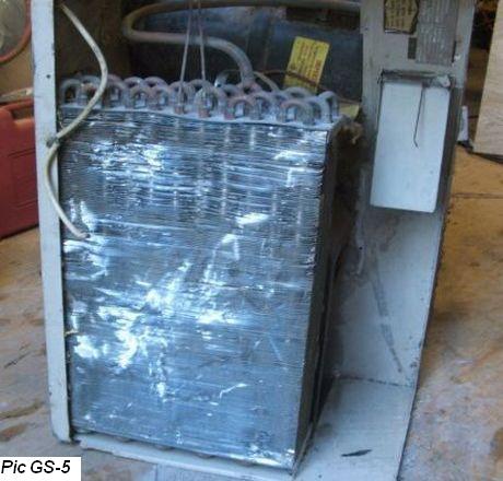

Pic# GS-4, shows the Condenser side of an old AC. that I have moved around for over ten years, the Compressor is stuffed But I can use this condenser for the "Carrier as they are both rated at Two Tons.

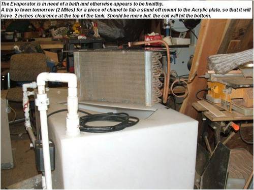

pic. GS-5, the Evaporator has suffered fin damage possibly more and I do not want to try and use it.

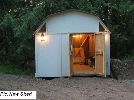

Pic New shed, is wired with 240 volt, 40 amp. 1 phase to power my welder and a back feed port for the Emergency generator, 5500 watt Chinese, Harbor freight model "Chicago", 13HP. petro engine with battery start. It has 10 hrs. on it at over 4000 watts draw, "So far So Good" only problem is hard to start. The choke is not effective, (Smog Laws) A small shot of ether cures that.

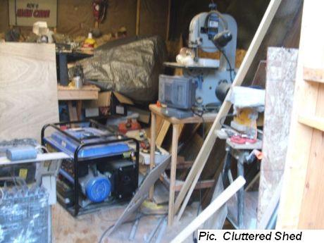

Pic. cluttered Shed, is a peek into a place no longer accessible.
I built this last year to house all my woodworking-House building tools that occupied the Master Bedroom for five years. it is 12 X 16 Feet(3-1/2 X 4.9 meters), It has an attic which is also full.
OK, The Plan", I have 6 ditches containing 2 pipes each for a total of 648 lineal feet. (195.5 Meters.) The pipe Diameter is 3/4" pvc.(1.9-CM.).
All pipes are connected in series for one long pipe.
When filled with circulating fluid (Water and Alcohol) will contain 3430 Cubic inches /231 = 14.85 US Gallons,(56 Liters).
The pipes are burried in a winter time wet area. Sometimes after hard rains there is a couple inches of standing water here. the area does perk well so I have constant change of water around my Loop Pipes which will keep the area from freezing when the loop takes heat away. This will enhance the efficiency of my shorter than standard Loop.
Water is used as the International Standard Base to measure specific heat, its Value is (1) This is (1 BTU, (British Thermal Unit), All you need to know is, one BTU will change the temperature of one pound of water, 1 degree F. either cooled or warmed. There may be one or two things on this earth that have a specific heat greater than one but I don't know of them. This does have a limit, 32 deg(0)Ice, or 212(100) Boiling, At either Temp. it requires less heat to change its temperature 1 deg.
What I'm getting to is, water can adsorb more heat at reasonable temps than any other medium
My pipe will hold 125 pounds of water. My Freon Refrigerant will chill the water/alcohol to 30 deg. F.(-1)C, The Earth will heat the pipe water to 45 deg. F. (Earth temperature here in Seattle is 52 F.) This means each pound of water will pick up 15 btu. while passing through the Ground Loop.(We Hope)
I plan to circulate 3 1/2 gallons per minute through the system, It will require 4 minutes for the Water to pass through giving some time to conduct Earth Heat through the plastic pipe.
3 1/2 Gallons weighs 30 pounds, Every minute 30x15 btu comes out the pipe to heat my house.
This is 450 btu minute x 60 = 27,000 = 2.25 ton, 1 watt is = to 3.41 btu. were I to heat my house with resistance Heat ( which I do), then 27000/3.41 = 7.9 kilowatts. This system will operate on 15 amps 220 volts including fans and pump = 3.3 Kilowatt.

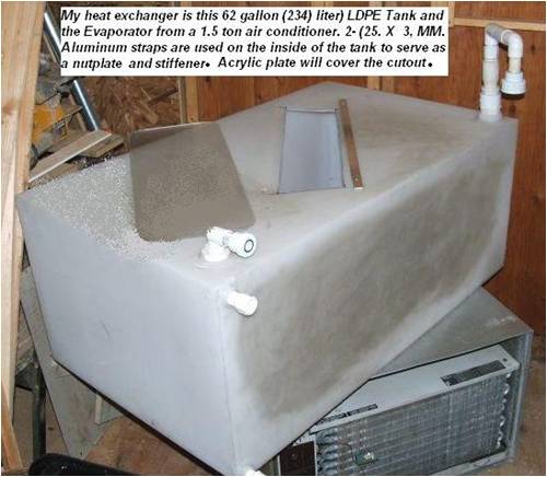

Yesterday I purchased 2 Poly Water Tanks 65 Gallon each and a mag pump< something new to me as I have never played with one but if the description I was given is accurate it should be trouble free for a long time. I bought both the tanks and the pump from a Fella who rebuilds pleasure boats. This was another Craigslist AD, Tanks $50.oo each, Pump also $50.oo,
I will bury the Tanks and pour some ready mix cement around them for support before back filling.
I will have to cut out a section of the tank to fit the evaporator inside and then make a suitable adapter patch to seal it against dirt and insects.(FUN)

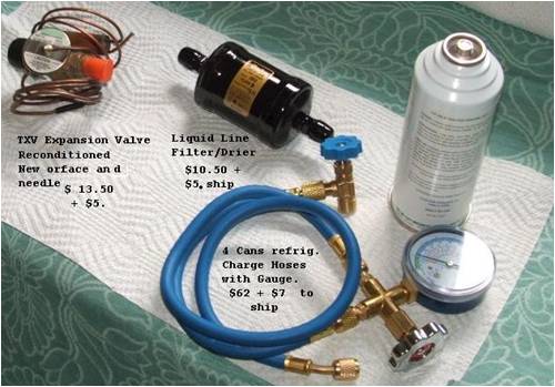

Here is an Update to the heat pump A few pic's really to show where I'm Going.
Just a Note;
My lavish use of fittings is due to stock on hand (lots of em,)
All for Now.

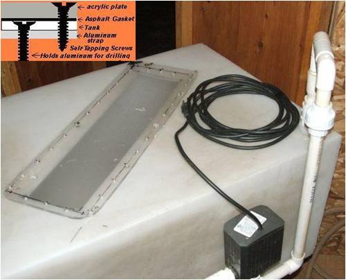

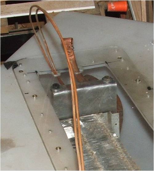

Posted: 06:52pm 07 Feb 2011

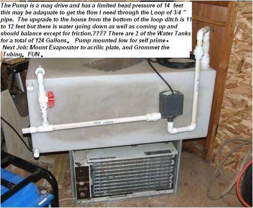

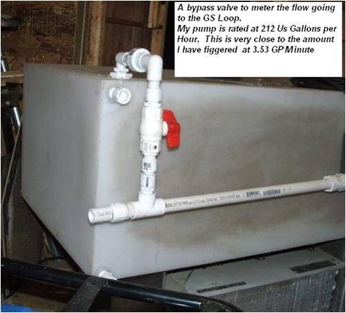

Hi
All;
Another update.

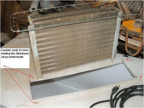

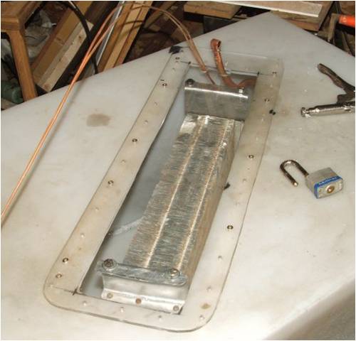

I cheaped out on buying a piece of Aluminum channel for the Evaporator Mounts.
I found a piece of sheet stock .04" 1,mm and formed my Mounts at 2-3/8"- 60mm wide.
this allows maximum depth into the fluid with 3/4"-19mm. clearance on the bottom.
The purpose of cutting the Tank opening at an angle is to reduce the turbulence when fluid flows within. The fluid return is through the 2 small side ports which will initiate a flow pattern toward the opposite side of the Tank, the pump being on the same side as the ports will pull the current back across. ( or in my imagination ?)
This is a temporary install to check fit and to find out what i have not made allowances for in my planning.

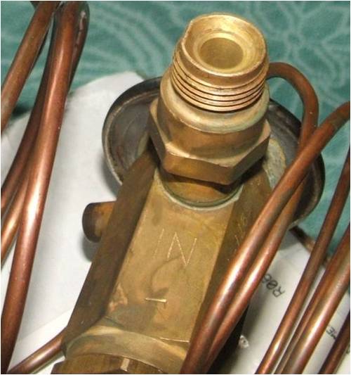

The 13mm Tubing has a oil trap where it connects to the evaporator, (just a carefully formed curve in the Tubing to help the oil return to the Compressor) It has been bent out of shape and I need to replace it. Time to brush up on my Soldering .

Hi Greenbelt
Coming along well the only thing I see as a problem is the friction loss in your piping it is a long way for your little pump to pump the water will be interested to see how that goes.
All the best
Bob

Hi Bob,
Yeah, There could be a problem here, I plan to test the flow rate before commiting to this one. It would be nice if I can use this pump it is rated at 110 Watts draw.
I have 124 US gallon plus 13 odd in the pipe. if heat draw requires 3.5 gallon per Minute then I have 137 Gallon / 3-1/2 = 39 minutes with no flow at all. Of course it does not work like that because of the loss of efficiency as the fluid cools.
Suppose the system operates for about 1/2 that time, 16 minutes Max. with a room thermostat in series with a timer, if the pump can manage 2.2 GPM. it will pump 35.2 gallon while the system operates, in the 10 minutes of power off it will pump 22 gal. for a total of 57.2 gallons,/ 3-1/2 = 16.34 min.
My house is insulated pretty well ,R 23 walls, R 30 floor R 38 Roof with double pane thermo gas filled windows.
Once warm, it holds heat a long time and I always have resistance heat as a back up.
Time will tell the story, Thanks for the comment, This is how we do it better and any suggestions are welcome, I will of course take credit for it anyway.

The house has 3,300m of pipe burried in the concrete slab that is the floor, and two 2000 litre hot-water tanks that are for cooling the generator and providing domestic hot water and hydronics water to heat the slab.
All I'm missing is the heat-pump to move heat from the GSHP loops into the tanks. One day I'll have the spare money to do it!
Also, not shown, I ran a series of temperature sensors (16) along some of the slinkies so I can do temperature profiles to optomise the flow-rate, one day.
VK4AYQ

Hi Ross
That is a major contract, have you monitored the soil temp in the mean time to get an idea of available geo energy?
Bob
Foolin Around
RossW
Joined: 25/02/2006
Posts: 495
Posted: 10:20am 09 Feb 2011
  VK4AYQ said   Hi Ross
Bob
The loops themselves were a reasonably modest investment - and probably 5% of the cost of doing it at the time than trying to do it 5 years after the event!
Measuring the ground temp is one of those things I've been meaning to do "forever" - but never got around to doing more than once or twice a year. I considered it more or less "irrelevant" as whatever temperature the ground is, it's bound to be more efficient than an air-sourced system. (We rarely get below about -7 deg C air temp here, and 3m down I'd be surprised if the ground gets below about 16C, based on the temperature of other walls burried 3 to 5m down)
VK4AYQ
Joined: 02/12/2009
Posts: 2539
Posted: 10:45am 09 Feb 2011
Hi Ross
I have been looking into a passive system my self and have bored test holes to rock unfortunately thats only 1 to 1.2 meters down, its a huge slab of sandstone.
Winter temp minimum over the three holes is 22 deg C. and summer it is 25 - 26 Deg C. unfortunately the recent flooding has ruined my temp senders, so I cant check this year which has been hotter.
I drilled into the rock another 500 mm, with the longest drill I had and only one sensor, the temperature at that level stayed at 23 deg C. all year.
At this level it would be a good proposition but the cost of around $3000.00 brought me to a stop.
Another option is to use the bore water 50 meter deep, 22Deg C. cheaper but means running a 1/2 HP submersible approx 700 watts.
For this reason I am very interested to see how yours go, and the cost effectiveness of operation.
All the best
Bob
Foolin Around
Greenbelt
Joined: 11/01/2009
Posts: 566
Posted: 06:03pm 09 Feb 2011
RossW---Impressive- !
I don't know what size your finished house will be but for sure it doesn't matter, you have enough system installed for a School House. great looking work also.
BTW your building site is not to shabby either. (Thinking out loud)
With 5250 ft. of pipe you have between 6.5 to 7.5 tons of heat exchanger here.
That's 72,600-84,600- BTU. 21.3 - 24.8 kilowatts Equivalent. I'm Gona be Sick!
Thank you for sharing this. Keep us up to date.
Regards, Roe
