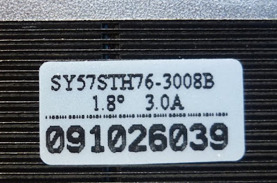

I'm acquiring materials from some time, for a desktop CNC Router first, then I will turn it in a bigger one, gantry type.
I have the steppers (which are very good for gantry type and inappropriate for desk router because are big) and the electronics for 3 axis router.
For the electronics, I have two variants. Using my FreeJALduino board (18F2550) to drive the steppers, or make three stepper drivers with 12F629 and receiving steps from FreeJALduino board. The mosfets are IRL530. The controller will be connected to USB.

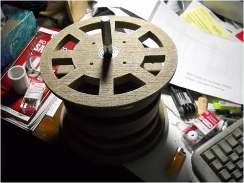

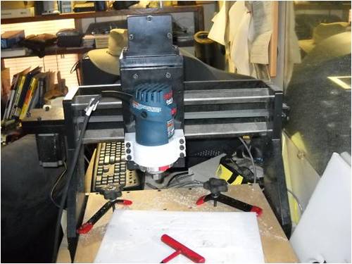

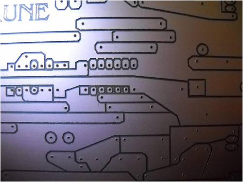

Greetings, your project looks very interesting. I purchased a Zenbot. CNC routers are great tools. I use my to cut parts for wind mills, PMA’s and circuit boards. The software I use is TurboCad to make .dxf files, LazyCam Pro to compile G-code, and Kcam to operate the controller. I use TinyCAD and FreePCB for PCB work. I recently purchased DeskCNC to hopefully make the entire processor easier, but I am still learning. I hope to see more photos as your project progresses.

Nice CNC and PCB result!

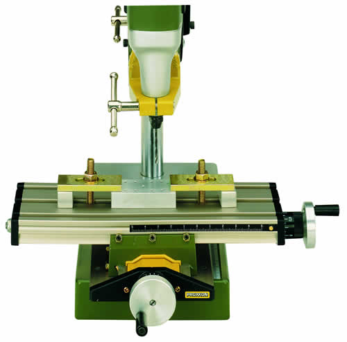

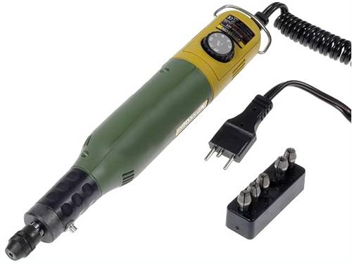

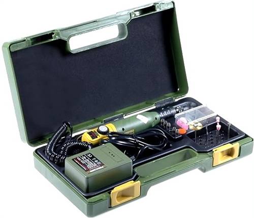

I got a cold - big one. My milling/drilling machine is a very small one, for delicate things. I hope it will last forever :) (Proxxon Micromot 40/E)

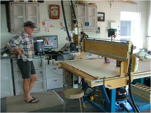

Yesterday I visited a friend who has built his own cnc table. Its timber construction, and has a 2.4m * 1.2m cutting bed! Used Mach3 for the PC software, and microsteppers from Ocean Controls. It uses chain drive for the X and Y axis, and I have to say I was very impressed with how well it ran, very fast and accurate. My next big CNC table will use chain to I think, it works very well.

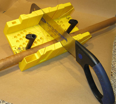

Hi @govertical, I am member of that forum but is hard to browse - I prefer this kind of online presentation: Get Ready to CNC! . Another big problem from my part is the absence of technical dictionary in my spoken english, required when you ask for help.
Regarding to the site above, I even got (asked a relative to send me) a mitter box (without pull-saw) but I don't know yet if I will use MDF. Everything is related to what I will find in stores around my living area. Anyway, tools are always good to have.

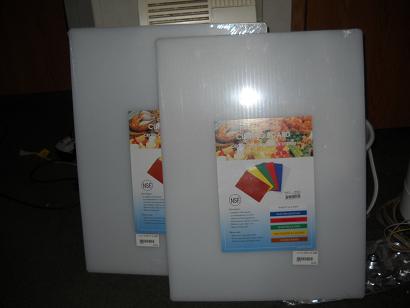

Greetings, High Density Polypropylene maybe a consideration for fabricating the frame. It is easy to work with and it holds together very well using machine screws and you do not have to tap the holes. If you make the holes smaller then the screws they are self tapping. I am able to purchase it locally at a kitchen supply store in the form of kitchen cutting boards. I am green with envy regarding your friends CNC table, great work.

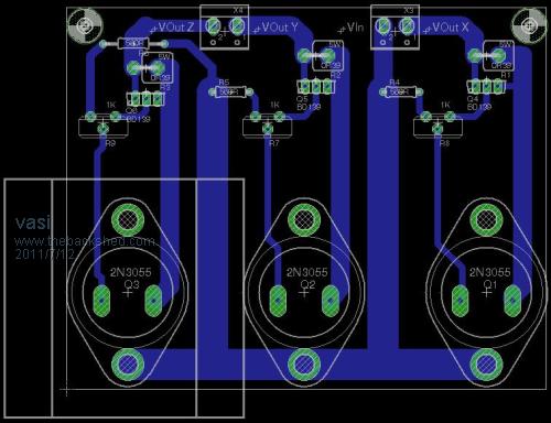

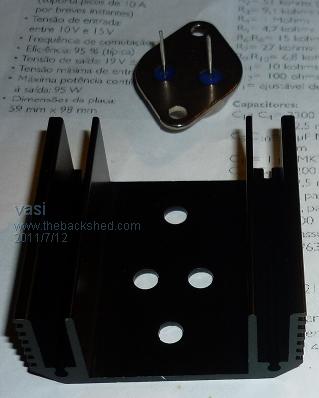

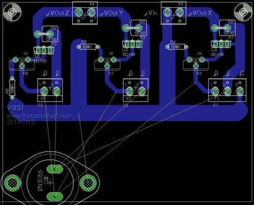

I started to build the simple chopper from here, the safe variant (see "Build info" link from that page for details). I like to draw my own pcb's so I used the free version of Eagle under Linux
Because of the three 2N3055 power transistors, entire available size of the pcb is used but, when I pictured (bottom-left corner of the first image) the cooling radiator I have, I saw that I have no chance to fit them on the board. So, the power transistors will be mounted on a piece of plastic or something, and connected with wires and pcb screw connectors. Dirty...
I parked the transistors in the bottom-left corner on the board (the free version of Eagle do not let me to put them outside of the board and I don't know a method to hide them unless erasing them from the schematic - which I don't want).
The files can be downloaded from here.

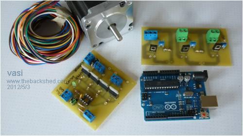

Chopper and one of the stepper drivers almost ready - just waiting for some drill bits to arrive. As for g-code interpreter, I received an Arduino UNO from FLorin as a present. Thank you Florin, this will be my g-code interpreter (with help from GRBL firmware) and the brain for my CNC.

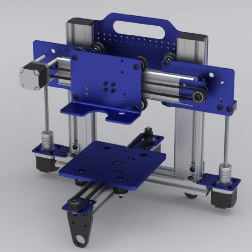

Vasi, that last video of the homebuild cnc is a inaccurate system. It will work great for cutting foam and soft woods with millimeter accuracy.
It will have way to much flexibility in its parts.
If you are looking for parts i suggest looking at makerslide and the ordbot for inspiration.
My own homebuild cnc, which still only exists in my head :) will use epoxy concrete.
This is a good way to supress vibrations, which in cnc together with flex is your biggest enemy. Material is also pretty cheap.

At first sight, indeed, an interesting (and very appealing) design:
I'm afraid that the aluminum will wear out quickly.Edited by vasi 2012-06-01

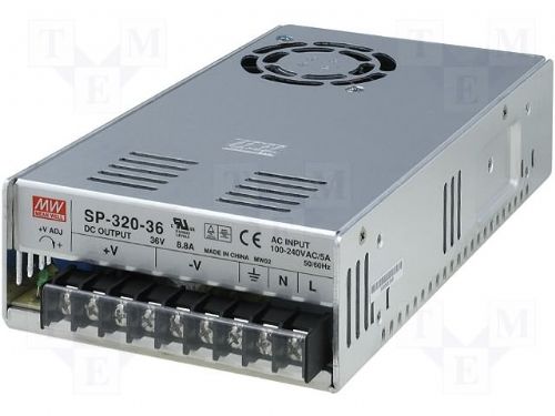

Finally, I have a power source for my steppers. My brother in law Pety sponsored me with this 36Vcc/8.8A industrial power source. Of course, made in China. Happy!
I know where AC is going, but I don't know what N (null?) and L (phase?) means. The pdf does not say much (to me at least)
2012-09-26_214054_sp-320.pdf.zip Edited by vasi 2012-09-27
Elvish name: Mablung Miriel
Beyound Arduino Lang
Posted: 12:32pm 26 Sep 2012
N is Neutral, and L is Line ( or Active, depending on your countries power standards ). If you wire this up with a power lead, then the L should be the brown or red wire, and N is blue or black. But this may vary from country to country.
Some will say its not important and you can swap the N and L around, but its best to stick with the standards.
Nice power supply!

Posted: 12:53pm 26 Sep 2012
Thanks Glenn, I will do as you say. I have a screwdriver who can show me the active wire.
