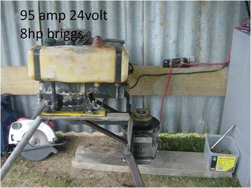

Hi i have one of these the alternator is a caterpillar 24 volt 95 amp it was on an old 8 hp briggs until it died of old age now its on a kola ten hp electric start motor and when my bank is down it needs all ten hp to run the alternator (works real hard) here is a picture of the old motor setup not tidy but it worked.

Posted: 01:51am 09 Mar 2011
Thanks for the idea here guys, much appreciated.
I decided to go with a 24v alternator + built in regulator for convenience.
My setup looks remarkably like yours Shawn, old B&S motor with alternator beside, will get a pic up soon I hope.
Would I be able to connect the new 50amp alternator directly to my 1660ah battery set, or do I need something else ???

Hi mick mine has a built in regulator to and dc comes out so i connected it straight up to my 1000 ah bank the motor works hard for a while then eases up holding bank at 27.5/28 volts.
If you are woried about what volts it will run up to first connect it to a couple of old car batteries and test the volts after a while with it running.
