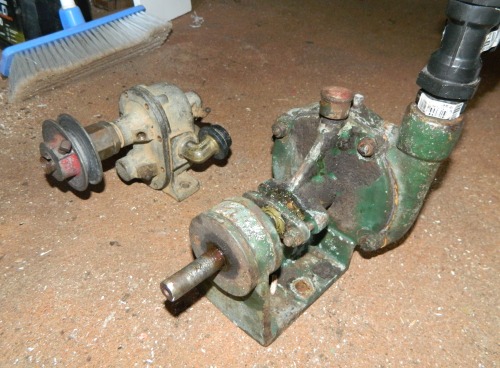

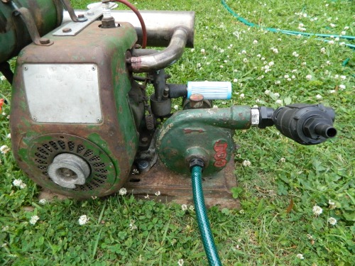

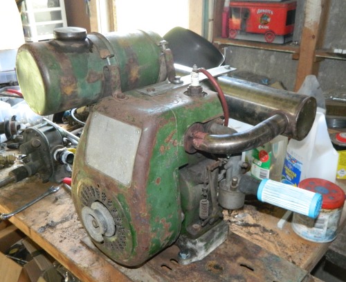

OK, another question for those in the know.
I want to put together a water pump using some bits I have lying around. It would need to pump water up about 10 meters max, about 20 psi outlet pressure, and suck up a couple of meters at most. I have a old Vickers 1hp motor. It works well, starts easily.
I rigged it up to a old centrifical pump, also in pretty good condition. Ratio was about 1:1.5, so the pump was running slightly faster than the motor. With the motor running I primed the pump with a garden hose connected to the water mains, and then put the hose into a bucket of water to see how well it pumped the water out. Results were dismal, no more than a trickle.
So I need to rethink it. I guess I could be doing two things wrong, not enough pump speed, and/or, pump outlet at side, leaving a air pocket in the top 1/3 of the pump. I did prime the pump, but it would still have the air pocket, and I guessed once the pump was running the air would be driven out, maybe not. I can fix that. Maybe I need much more RPM, I do have a bigger pulley I can machine to fit the motor, making it about 1:4 ratio.
I also have a little gear pump, which I've used to pump water before. Would it be a better option?

Well that was a waste of time. This pump must need a lot more RPM that the old Vickers can provide, even with a stepped up drive. The pump impeller is an odd shape, nothing like a car water pump impeller. It looks more like a disk brake, with only 4 internal slots.

Yeah well, I'm about to throw this pump over the back fence. Thought about Bryans suggestion, and adjusted the gland to make sure it wasnt leaking. I also blew some air into the system and checked for any leaks around the pump with soapy water. All good. Tried once more, still pathetic.
I've had the cover off, impella looks fine.
I figure, even if I get the thing working, its so sensitive to RPM/air/whatever, its going to let me down whenever I go to use it. Going to plan B, the gear pump.

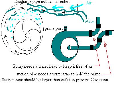

Looking at your picture I think the input hose is to small mine had a 1 inch suction pipe and a 3/4 inch discharge pipe, I think a small pipe on the inlet would cause it to go into gravitation.
Looks a good little unit so do not give up on it, if you need a hand with it bring it to my place and I will give you a hand with it.
All the best
Bob
Foolin Around
Posted: 11:20pm 05 Nov 2011
I think you may be right Bob.
One thing I noticed yesterday, but it didn't click at the time, was the water coming out was very warm. Reading on the internet last night, cavitation heats up water! And I also read a sudden change in diameter from small to large at the impeller inlet can casue cavitation, its a common mistake made my people ( like me ).
The inlet is 3/4, I'll grab some hose to suit and give it another go.

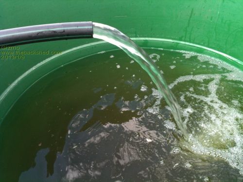

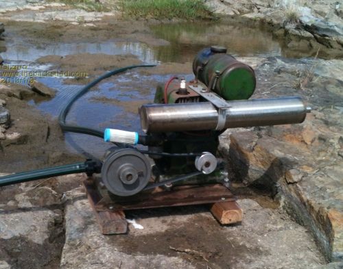

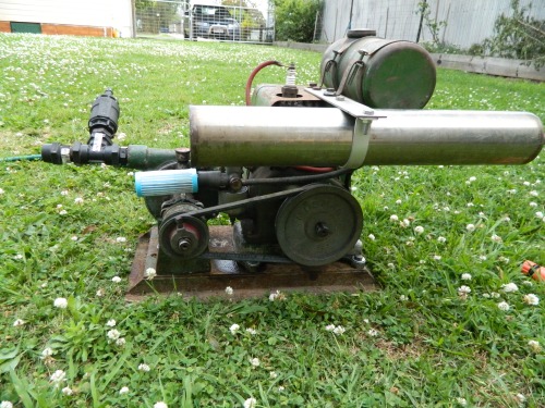

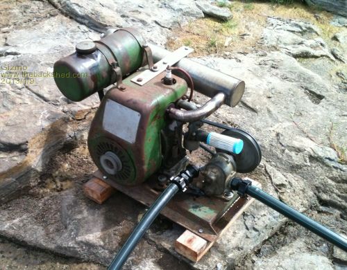

Posted: 03:45pm 08 Jan 2013
Well finally got the little pump sorted. Using the gear pump, and changed the pulley ratio's, its now pumping pretty good, about 250 meters through a 1 inch poly pipe. Filled a 500 litre tank in about 20 minutes.
