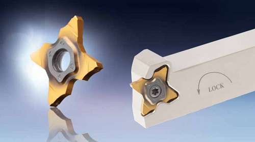

I tried to lathe an external circlip groove in some really tough shaft tonight and nearly stuffed it up. The HSS tool I made didn't hold an edge and started to work-harden the shaft, I am not really happy with the result as the walls of the groove are not square enough to hold the circlip properly.
It's good enough to get me out of trouble for a couple of weeks as I can press-fit the bearings and loctite them in.
I need to have another go and get it right. Anyone know of a tool I can buy that will handle this? It needs to be 0.7mm or 1mm wide and 5100 to 9030 grade.
anyone use something like this?
thanks yahooEdited by yahoo2 2011-11-22

Think I might buy a few of the inserts pictured in my first post. I do a lot of grooving for o-rings and circlips and stuff. they have 17 sizes between 0.5 mm and 2.0 mm and a selection of corner radius options. I am still going to have a practice with the grinder on the off-cut in case the one on the machine doesn't hold.

Hi Yahoo
I like the tool pictured but wonder if the cost would be justified in the home playroom, certainly would be for an active workshop. With the cost of carbide tooling going through the roof I find myself using more old HSS and stellite tools again for hobby turning. Its a bugger being on a pension and trying to keep up with tooling and playing solar and windmills. Fortunately I still have lots of tooling left for heavy jobs from more active times, and I make up tooling by silver soldering bits of worn out indexable tooling to mild steel shanks. Another project on the list is a Fool and Cutter grinder, if I live long enough to get through what I already have.
