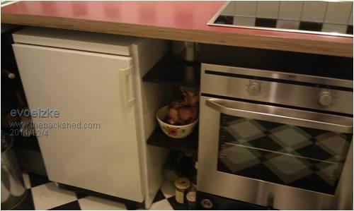

Reducing energy consumption down to the half by insulating my old fridge with polystyrene foam (styrofoam).
I did insulate my old Siemens fridge bought in 1993. It did cost me 25 Euros in material. After one year i will get that money back because of saving costs for power. After that I save 27 Euros per year. Baseline power consumption was 247kWh. I did reduce it down to 128kWh.
My essential steps:
Insulating all possible walls with foamed polysterene at least 2cm thick except the door with 1cm. I put the insulation either on the outside or inside wall depending on what seemed more reasonable.
Decorating the outer polysterene with self-adhesive films
Adjusting the thermostat, cause it did cool too much for that new efficient insulation even when it was turned down as much as possible. I had to open the thermostat and adjust it with a screw inside.
Here more details and pics: coolfrige
