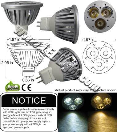

Hi Folks
I have been running a MR16 Ledlight out on the patio for around 2 years now as a trial for when I build down south & am really impressed with the output of the 3X1 watt unit; it's only roughly done but it runs off a Panasonic sealed lead/acid 12V 7A/hr battery that hasn't been charged since I connected it up, gotta be happy with that.
Barry

Disco Stu
Joined: 13/12/2009
Location:
Posts: 16
Posted: 10:27am 02 Feb 2012
barry those are great little lights i have one as a reading lamp and 2 on either end of porch illuminating the entrance gate. i got mine of ebay for next to nothing, also if you have a look through ikea if you ever get dragged there they got some go have a look at there led lights good bang for buck, and can be easily adapted for 12v use as they usually have external power supplys
