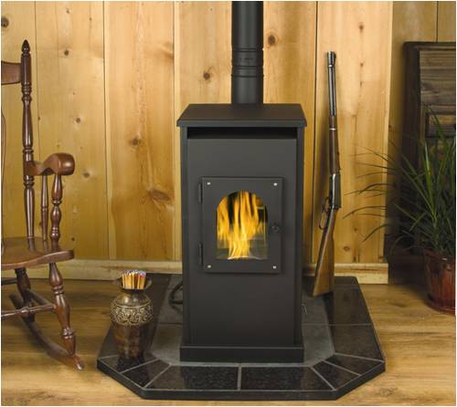

What's that thing to the right of the fireplace ???

Dunno, might be some sort of fancy stick for adjusting the flue maybe? it's not mentioned in the owners manual, so perhaps its an optional extra.
I have seen a shiny bent stick like that at a couple of weddings, so it may be nothing to do with the stove at all! decoration? like frilly curtains?

It may be an igniter
keeping a safe distance from the flames during ignition cycle.

I believe that the thing to the right of the fire box is called a "fire stick" and therefore is perfectly fine to be next to the fire box.

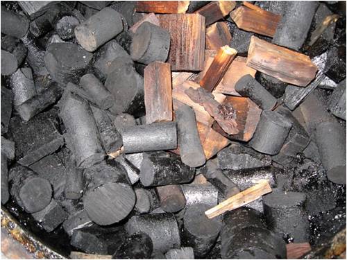

Has anyone here thought of building a gas producer something similar to that used during the war to run automobiles. The priciple is quite simple. You have two chambers the bottom one being the fire box the top one (sealed with strong door) is the oven. Also you will need a 44 gallon drum and copper tubing to make cooling condenser. The gas is fed into an amphometer constucted using extra large Tractor inner tube weighed down with rocks or concrete lid. The idea is to heat wood or even dry weeds in the top chamber while sealed releasing the gas through a coil in drumm filled with water to the amphometer. Once the wood or weeds turn to charcoal the the charcoal is burnt in bottom fire box to start the process all over again.
There has to be a non return valve fitted in gas supply line from gas producer to prevent gas from flowing back when door is opened to remove charcoal and replenish wood or weeds. (anything combustable such as cardboard, paper, cotton rags etc can be used but not plastics).
The gas can be used for heating, cooking, drive engines etc the gas pressure is only as high as the weight used on the inner tube and will remain constant while it is inflated with gas.
