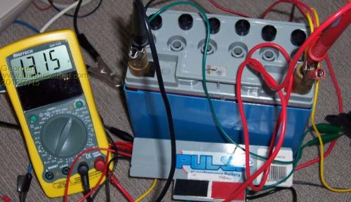

Got distilled water and started slowly with 2 cube cm in each cell.
Did it 3 times with no fluid showing above what looked like blotting paper.
Suppose not good sign.
Yesterday I put it on charger 2A from the mains, but then I used 40W solar battery since it also gives about 2A maximum and it was a sunny day.
Today I added again 2 cube cm in each cell 3 times and after last one
I noticed fluid above blotting paper.
Probably not ideal, but only because it diluted original acid concentration.
Battery is used as stationary one so I don't have to worry about spilling acid.
In total every cell took 10 cube cm of water before water showed up.
Does it mean that battery was severely dehydrated?
Plate above says 17Ah for C20 - I understand that brand new battery provides 850mA for 20 hours
( did I get it right ? )
George
Posted: 06:35pm 14 Jul 2012
If it can be charged at 2A at only 13.15 volts, that is a very good sign.
Usually when they completely dry out or sulphate up, they just will not charge with any current at all.

the reasons for adding little bits at a time are to make sure that the water wicks into the dry patches, if you just fill the cell it may sit on top and not soak in and secondly it needs to mix in with all the concentrated bits to restart the chemical reactions and form the sulphuric acid and not stay in watery pockets and layers.
from what you have said it looks like the battery was not completely dry so you may have some luck. keep an eye on the fluid levels.
Would be nice if you could measure the amps and volts at the same time, you cant really SEE what is happening without both.
has your solar thing got a regulator? if it hasn't then don't use it unless you are standing there and watching it.
Get the damn thing away from your house and sheds and charge it in the open.

Got a 10A solar regulator and I am there all the time watching like a hawk.
Might have to employ my analogue meter to see both Amps and Volts
I noticed that it only takes few minutes to get from 13V to 14V someting for regulator to kick in.
Suppose 17Ah battery few years old doesn't take as much charge as it would when brand new.
Inspected all the cells and only second cell from the right side (on my picture above) did not absorb all the water and is slightly shining.
Other 5 cells took all the water.
(In few days I'll be tempted to put in 2cm cube more)
In the morning battery reads between 12.62 to 12.65V
George
