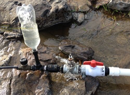

This is one of those little projects I've wanted to do for many years, but until now I didn't have the natural resource needed, a flowing stream.
My little creek has a pretty consistant flow of about, at a guess, 1 litre per second or two. Not a lot of drop, about 2 meters across the entire length of 200 meters. Most of the drop, about 1.2 meters, is over a distance of 25 meters and this is where I installed the ram.
I built the ram using these free plans as a guide, its a design that uses common hardware parts and can be put together in a few minutes. As this was a test build, I substituted the pressure chamber with a plastic coke bottle.

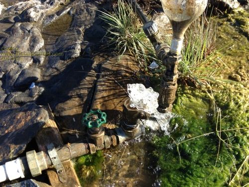

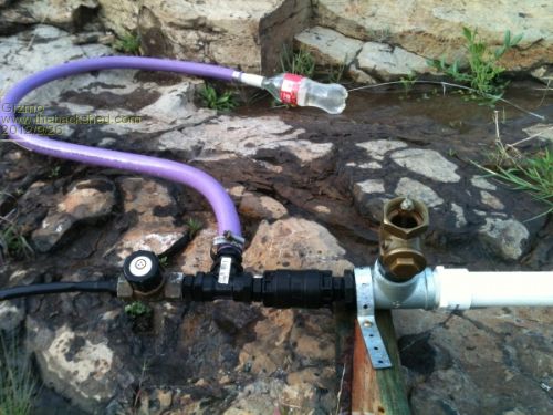

The inlet pipe and standing tube are 40mm light PVC, and the drive pipe is 40mm heavy wall PVC. This pic shows the general layout, sorry its not a good picture.

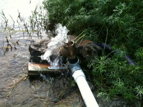

A is the inlet, B is the standing pipe, and C is the ram. The drive pipe, between B and C is 9 meters long.

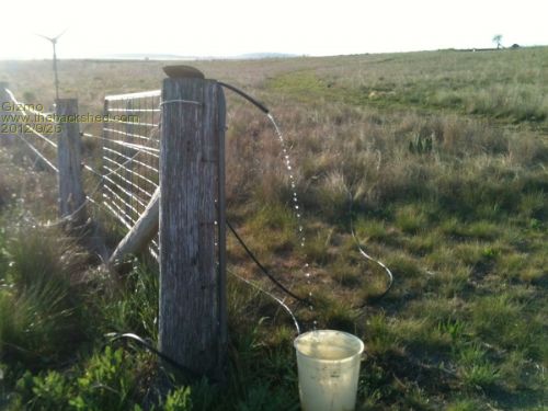

Outlet was about 7 meters above the ram when this picture was taken, but its now pumping water all the way to a tank on a mound behind my shed, a lift of 10 to 15 meters at a guess.
I have to say, I'm pretty impressed with these rams, and had a lot of fun experimenting and learning how they work. My pump has about 1.2 meters of head, and is pumping water to a tank thats 200 meters away and over 10 meters above the creek. The tank has depth markings so I can tell how much water is been fed into it, about 50 liters per hour. Its a 500 liter tank so will be overflowing by the morning, and I can expect 1000 liters each day, which will be used to water the yard and plants.
These are some of the tips I picked up building my pump. Hydraulic rams like back pressure. In fact, this design wont work without it. Any sudden changes in back pressure can put the pump out of rhythm and it will probably stop, so its best to have the outlet drippling into a tank and leave it alone. There is a lot of vibration in the pump, and mine fell apart a few times until I had secured it with lots of large rocks. The inlet pipe and drive pipe need to be downhill all the way, any rises will fill with air and restrict flow. A stand pipe helped purge any air bubbles sucked into the inlet pipe and improved the performance of my pump. If the pump stops over night, blueclaw yabbies will move in and call it home, then get mangled in the clapper when you restart it.
Next I'll build a proper pressure chamber and find a way to secure the ram to the rocks before the next heavy rain. I'm only using a tiny portion of the creeks flow, so I could build a much larger pump, but maybe later. This has been fun.
If your interested in hydraulic rams, youtube is a great place to start, lots of ram videos.

Great to see some proper country technology in action.
I can think of a couple of tweaks you might consider if this is going to be a permanent fixture.
Definitely need a barrel union in the inlet pipe just after a gate valve at the pump, this means it is a 2 minute job to rip the pump out and chuck it on the bench to repair or clean it.
switch to more flexible poly pipe upstream of the stand-pipe this gives you the option of repositioning the inlet easily or adding floats and using wires to the bank to hold it.
Buy or build a foot-valve strainer for the suction inlet. I find slotted holes are the best and removable so that algae can be scrubbed off the inside .

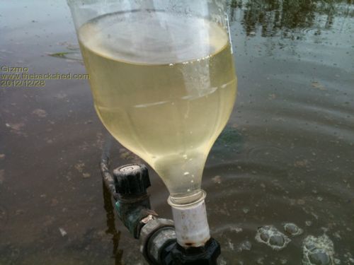

Pressure accumulators without bladders are a pain, they constantly fill up with water and need draining. There are perfectly good household pump pressure tanks thrown away when a new pump is installed, might be worth a scrounge around.
edit: I have to say I am genuinely surprised it is working with the spring-loaded poly non return valve.Edited by yahoo2 2012-09-28

Last night the pump stopped before filling the tank, just. About an inch from the top, so it pumped 500 liters overnight. The reason it stopped was the 600ml coke bottle developed a little hole where it was sitting on the rocks, the vibration must have worn down the plastic. So I fitted a 1.25 litre bottle ( working up to a 2 litre Phill ), and its mounted on the pump so it sits upright. Back in action.
Yeah the water filling the pressure tank is a problem. One tip I've heard of is filling the pressute tank with a slightly inflated bike tube.

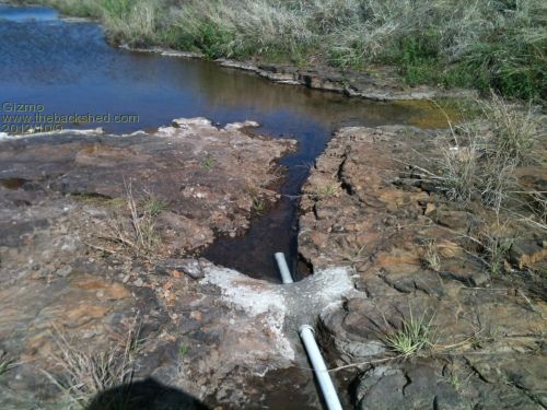

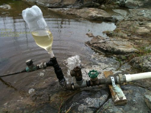

Made some improvements to the ram. Chipped away at a natural fault line in the creek bed to make a little inlet pond thats separate from the main creek flow. Concreted in a dam with a length of 50mm PVC pipe at the bottom. The 40mm pvc fits up this, and fitted a slotted strainer, the slots are facing down so it cant suck air.
This gave an extra 200mm of head. Next I bought a 50m length of 1.5inch poly pipe, and moved the ram below the next natural dam, gaining a further 400mm head approx. So now it has about 1.8m of head, but a very long feed pipe. At first I ran the poly pipe along the bank, where it followed the high and low points. Even though these high points were below the level of the pipe entry, they still had air pockets large enough to restrict the flow to little more than a trickle. So I ended up dropping the poly pipe into the creek, where it sat reasonably level, except for a rise at the beginning where it was fed from the inlet pond, and a rise the end towards the standing pipe. This worked, but its not the ideal solution for me, I would rather the pipe was up on the bank so I dont need to worry about storm water draging the poly pipe down the creek.
I was thinking of lifting the poly pipe back onto the bank and drilling a small 1mm holes into the top of the pipe at the high points? This in theory would let the air escape and then bleed water, but I'm not sure.
Anyway, the pump is now pumping about twice the water as it was before.

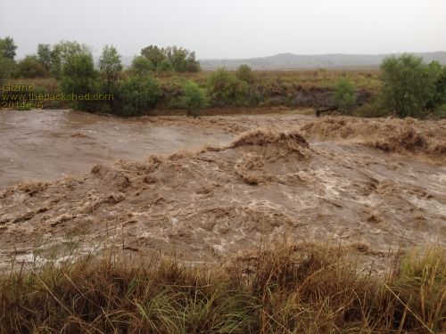

The long pipe became a nuisance. We had heavy rain predicted a couple of weeks ago so I lifted the pipe out of the creek and moved the pump to higher ground for a couple of days. Putting it back in and it took about 30 minutes to get the air out of the system!
So I've gone back to the short run. It means less flow, but I can move and replace the pump easily.
