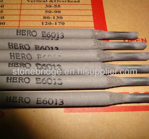

Descriptions on packets of welding rods are a bit like labels on wine bottles, lot of hype not much plain language. first place to look is for the E number on the packet.
Even the cheap yum-cha rods should have the American classification, you will see the letters AWS then E6013. It Stands for Electrode, 60,000 pounds per Sq inch tensile strength and 13 is the rod type and flux class.
A 13 is a general purpose rod, all positions (except vertical down) runny fluid sl*g, mild penetration, AC or DC+ or DC-. This is the rod that gets sold to 90% of home hobby welders and it works for most stuff.(size to use 2.5mm, 3.2mm and 4.0mm) eg CIG satincraft, WIA austarc 13S
If you are going to try welding a few different bits and pieces then keep an eye out for some more specialist rod classes.
12 (size to use 2.0mm 2.5mm) eg lincoln easyarc E6012, WIA Austarc 12P
Same as the 13 but has a fast freezing sl*g. you will need to have above average technique to keep the sl*g out of your welds but they are great for bridging gaps and welding sheetmetal using the vertical down weld. its a fast weld that keeps the work cool and stops the rod from blowing holes in the work.
10 or 11 (size to use 2.5mm or 3.2mm)
cellulose flux deep penetrating rods, used to get right into a join for the first pass weld when you cant get at the back to weld the other side (pipe or RHS) or you cant Vee the joint out.
16 (size to use 2.0mm 2.5mm 3.2mm) eg WIA Austarc 16TC
Low hydrogen rod, used for welding everything stronger than mild steel. Best to use a smaller diameter rod and do multiple passes, Grab as many as you need for a days welding and dry them in the oven, stick them in an airtight container while you work.
18 (smaller sizes if you can get em)
It's a hydrogen controlled low iron powder rod. this is the rod that professional welders burn the most of, same as the 16 but the iron powder gives more weld per rod. Need a welder with some grunt to burn these in the larger sizes. Should be some cheap no name rods around, the fancy ones have graphite tips for easy arc striking. Sometimes you need to gently bang the tip of the rod on the floor, to chip away some flux to make it easier to re-strike the arc, when you are starting a weld with a half used rod.
24 (3.2mm 4.0mm and maybe 5.0mm)
High iron powder.only good for horizontal flat and fillet welds but produces big smooth clean pretty welds with the welder cranked right up, great for showing off!

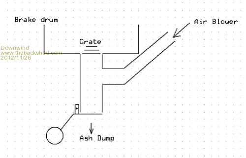

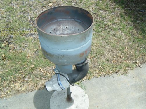

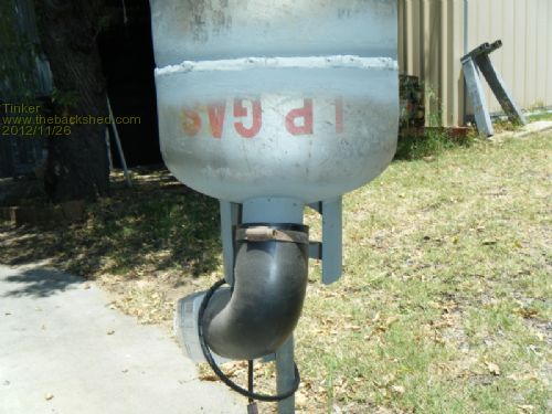

[quote]The traditional Aussie blacksmith's setup is mostly outdoors, not great for stopping thieves pinching the tools.[/quote]
That was mainly because they did not have sheds back then.
I made one some years back for my nephew as he was a cash strapped kid (14yo)that wanted to try blacksmithing.
All i used was a cast brake drum (select a size suitable to your needs)for the coke fire to burn in and used and old hair drier for the fan/air flow, some 3" exhast tube for the air feed and thats about it.
Now some 10 years on he (nephew hes an engineer now) still enjoys firing his forge up and beating some red hot metal into shape.
All was mounted on some legs with wheels on one end so he can wheel it in or out of the shed as required.

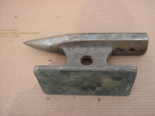

Also made him a anvil from some heavy gauge railway track, which works a treat to, he was given a big anvil later from a local person who thought it was great to see a young fellow interested in blacksmithing.

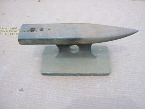

No photos of the forge but a couple of a small anvil i made for myself years ago.
Sometimes it just works
