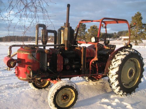

I have had my interest sparked by this little beauty.
It's a david brown tractor running on producer gas.
About now you are probably thinking the same as I did, ...you know..like..ummm..wot eva!
It was a originally a diesel
I didn't realise a diesel conversion was possible
Built by Johan Linell there is some details on his interesting website "Around Sweden with wood in the tank" listed under Wood gas tractor

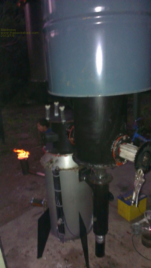

Posted: 12:23pm 08 Jul 2013

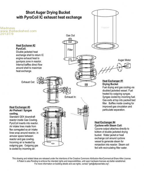

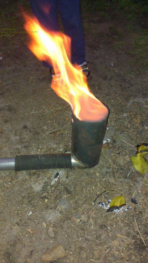

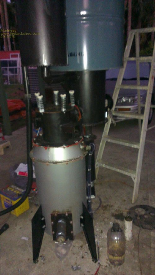

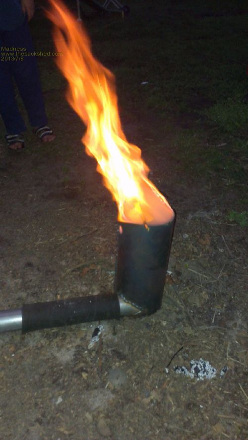

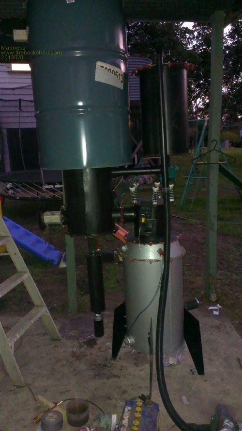

I have decided to go a different way with this project. I have built a Gasifier using the All Power Labs GEK design. You can download cad drawings and have all the parts cut on a CNC Plasma cutter as I have done. Although I had to make some modifications due to not being able to get the flexible gas lines they use for preheating the air.
I am connecting the gasifier to a 5 KW petrol marine generator that I picked up on Ebay for $105, it would not turn over. The generator has a 1240 CC Nissan engine that runs at 1500 RPM, the same engine is used on a 7.5 KW version of the same generator set, so I have extra capacity in the engine to allow for the power drop due to running on woodgas. Turned out water had got into the cylinders. a hone, new rings and head gasket fixed it.
All going well I will have the Generator running off the woodgas in the next few days. It should run for around 8 hours at full power off the 200 Litre drum full of chips.
