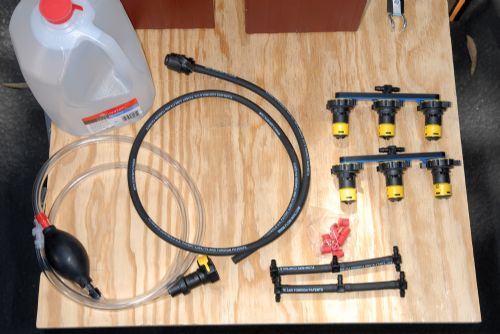

Anyone know how the commercial watering systems work (yahoo might know this)
I pondered the idea a few times, and other than 12 x 1 litre coke bottles upside down with tubes to each cell, i have not found an answer.
Any ideas??
Pete.

Its all done with a single hose with a T piece running to each battery. remove the vent cap and replace it with the new one that has a float and a tricky valve. It uses the water pressure in the line to hold it closed once the float triggers the valve(similar idea to the solenoid in a garden watering system).
The simplest manual ones use a squeeze bulb(like on an outboard motor fuel line) just pump the bulb till you feel the pressure come tight, all the little floats have switched the valve off in each cell.
very popular in golf carts.
photo attrib: no idea! taken with a nikonD200 but that's not helping ,is it.

Mobi, the valves in the photo would be specifically for a 6 volt Trojan.
The three valves are clipped to the manifold, usually there is fittings and hose in the kit to make a flexible top section with a longer spacing. You just twist them off the manifold.
There are versions for larger batteries where the float is changed to suit the specific fluid level of each particular brand of battery.
