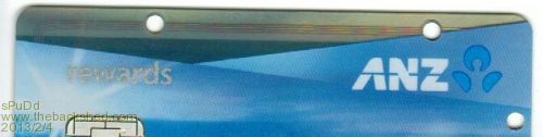

Problem solved.
Gold looking lines between holes are the RFID coils. Hold the card
up to a bright light if you don't have a transperent edge. Mark it
and drill through the wires. They pick up power & comms in the RFID
field, just works as a normal card without it.
You can blow holes in anything except the magnesium swipe and the
smart chip.
sPuDd..
It should work ...in theory

I know that I won't be using any card like that, and I will disable it with the drill holes through the aerial coils as indicated in an earlier post, if I am ever sent one of these cards.
