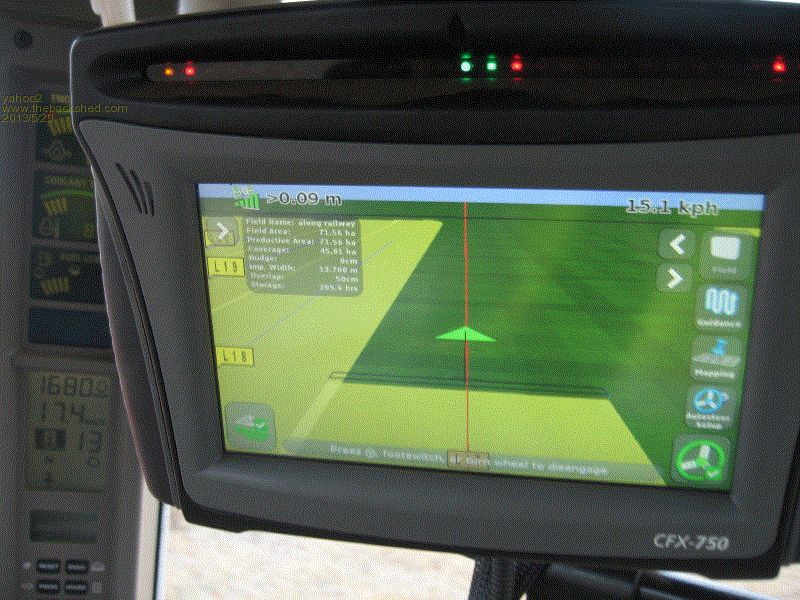

Thought the members might like to see this.
It's called AUTOSTEER.
I have had these units for 3 years now. They are a tenth of the price they were seven years ago and they work a treat. Basically I map the first pass with the tractor and implement along the fence and show the machine the line, then hit the touchscreen icon in the right hand corner and the machine drives the line for me for the rest of the field. With the modern no soil disturbance methods of cropping, it is very hard, if not impossible to see where I have already been. This takes all the guesswork and mental fatigue out of the day (and the sore neck from continually looking behind).
Data on the screen says we are doing 15.1 kph and the machine is just about to correct the position 9cm to the right. just coming to the end of this run with 16 passes and 25.65 hectares to go to finish the field.
Looking at the gauges in the background I can see the tractors ground-following radar
says the speed is 17.4 Kph. The heavy crop residue on the ground is affecting its accuracy very badly. Hooray for Global Positioning.

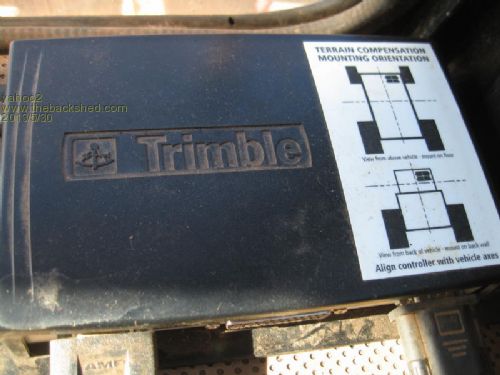

This box has electronic circuit board mounted gyroscopes in it, similar to what is in a smart phone, the software uses the movement of the machine to correct any satellite data that is low accuracy. It is possible for the machine to carry on for a little while with not GPS signal at all.
The other thing that has really improved in the last 10 years is the algorithms in the positional prediction software, all GPS units do this to a certain extent but its pretty basic, throwing some extra processing power at it makes a huge difference.
What you are left with is a small wander of the signal that looks like a small figure eight over a 12 hour period. There is a function in the software to simply nudge the signal back on track if you see it starts to move around too much.

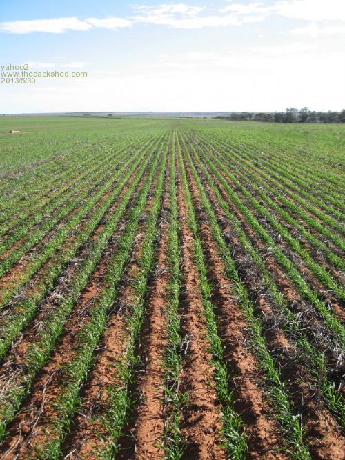

So here is the result. No missed strips, no overlaps, slightly less obscene language while tractor driving.

Bloody Hell!!!
I want to know what fertilizer you used to get the crop up and growing like that in 2 days from your post of the GPS sowing to the above photo of the crop.
Sometimes it just works
