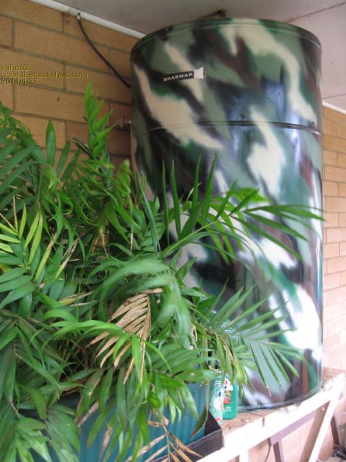

Mine was installed in 1963.
Took it to pieces sometime in the eighties and soldered a seam that had split and while we had it apart I filled the cavity with batt insulation. There is a lot of room in the old ones.
Apart from some mice pulling the glass out it has been a trouble free upgrade.

I can only guess you got your 60's and 90's mixed up, because it dont look to be a 60's model to me.
63 makes it as old as myself, and i doubt that is its correct date.
As you say a solder repair, would deem it a low pressure unit, and not a mains pressure system, as here i often see above 80psi supply and would doubt a copper soldered cylinder would withstand that pressure.
Nice paint job all the same.

Yeah Pete it is gravity fed low pressure, I have never had mains water. It pre-dates the mains power here by 7 years. I have been tempted to hook the old wetback lines up to a solar system a number of times but the amount of hot water I use doesn't justify the cost (or effort, I'm lazy). I should insulate some of the exposed pipework around the tank I suppose.
I had a problem with the thermostat a while back and the plumber would not even look for a replacement (too old) so I gritted the teeth and went looking myself. Turns out, it is a standard industrial fitment and very cheap. That was a win!
I purchased a roll of very heavy bubble wrap to transport some vintage TV's and radiograms a few years ago, the bubbles were about 20mm wide and thick plastic. I thought that might last a bit longer than the thinner stuff as insulation before it broke down, sadly no. I assume it is the UV that causes it, I got about 9 winters from some window inserts I made to winterize the house and keep some extra heat in, before they crumbled.
It is a great idea Pete, perhaps an outer skin of corroflute and some of that plastic banding would give a heater a slick looking finish. I would not recommend the camouflage paintjob without practicing on something else first, this took me about six attempts and a lot of paint.
