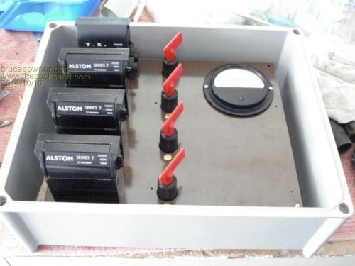

I made this up for the load side ,I have 4X battery banks also..
For the charging I feed the solar through the same switch that i select on the day for the load . All banks are slightly different in size and type of battery ,so it's charge one bank at a time ,along with using it at the same time . Works well, but I'm thinking,actually have allmost installed it, of a seperate rotary switch to charge ANY of the 4 banks, completly independant of that big load switching panel.
Those switches are about , $18 on fleabay.
A bit tricky mounting them , I wanted to parallel their output side ,but the little red handle in the "on" position is vertical --sort of confusing,you think this is the "off" position. But only I am allowed in this workshop.

They are supposed to handle 500A, the connector studs at the back certainly look up to it. But I would not turn it off if 500A pass the terminals.
Before connecting anything make sure the terminal stud does not wiggle, the lower brass nuts might need to be tightened a little. Then use two spanners to tighten your cable lug.

DO NOT SWITCH OFF IF YOU HAVE A BIG LOAD IN THE CIRCUIT -SWITCH OFF POWER CONSUMING EQUIPTMENT FIRST --
MY STUFF IS ALL 48 VOLTS ,SO I GET AWAY WITH MEDIUM LOADS , BUT YOU GUYS WITH 24 AND 12 VOLT BATTERY BANKS , SWITCH YOUR BIG LOADS OFF BEFORE OPERATING THESE SWITCHES.
