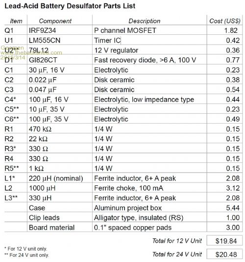

I try to make this one:
Desulphator information and circuit 12 and 24 volt.
http://www.thebackshed.com/forum/uploads/VK4AYQ/2015-03-11_142512_desulfator.pdf
JayCar had some components.
Not all parts were available and got couple substitutes too, hope close enough:
Ferrite Choke 220 UH 5A (6A max not available)
C1 instead of 30 uF 16V got 33 uF 16V
C2 instead of 0.22 uF got 33,000 pF 50V - is it close enough?
Checked on the net if missing components are on hand in another JayCar store or it will have to be eBay
Mosfet IRF9Z34 is not available, (closest one at JayCar is IRF540N CAT NO ZT2466 so not good)
Fast recovery diode D1 GI826CT closest can have 6A but 1000V - higher voltage will be probably OK
1000uH choke is a problem too
I can get:
JayCar has 470 uH Prewound Ferrite Choke CAT.NO LF1278
or High Frequency Choke - 470uH, 0.855ohms, 0.52A

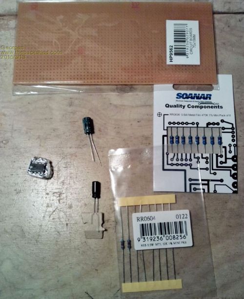

Made 2 pictures of parts

From this page, copy of the parts' list:

RS Components has your FET $4-95. There is no such thing as a 30uF capacitor. Well, you could have one custom made :-) But it's just a de-coupling cap. Electro' caps typically have a tolerance of about 20% 33uF will be fine. In fact you could use anything above that value (within reason, 220uf, 470uf) all will work fine. The article you link at the beginning shows an error in the value of C2. .0022uF is the same as 2.2nF which is also the same as 2200pF (Yep, just move the dot) Might want to get that one close as it's part of the timing cycle. Also check RS Components for the choke. 1000uH is the same as 1mH. Soanarplus is also a good components supplier. I use both and are both well worth a look.

Forgot to mention that C2 is 0.0022uF
and checked, JayCar has them, not sure why I was given 3300pF instead of 2200 (?)
(in post above I wrote by mistake 33,000pF , sorry , cannot change it now)

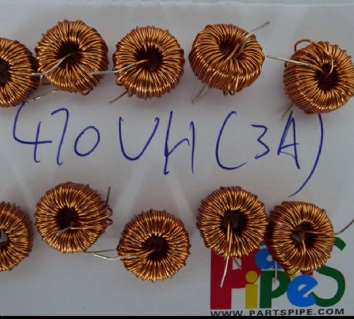

Picture taken from this site:
http://www.ebay.com.au/itm/140991936000?_trksid=p2060353.m2749.l2649&ssPageName=STRK%3AMEBIDX%3AIT
Thanks Bob for reply.
Looks that there is hardly any room for couple of metres of fairly thick wire to wind into this one.
How should I do it?
The way I would do it:
1. measure wire thickness
2. get say 2 metres of coated wire
3. scrape off bit of insulation and solder new wire with one of the ends
4. paint or somehow insulate the soldered section
5. wind up in the same direction going around the core
\ Job done Right?

Are we talking about part L2 1000uH 100mA ?

20pcs Inductor 1000uH Choke Approximately AU $6.54

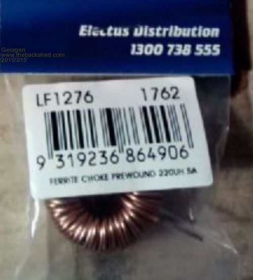

Jacar Cat No…LF1267…220uF 6amp Ferrite Choke……$4.95
What fast diode did you get?
PS I used 2 by 470 uH Jacar chokes in series in my first units and 1 of the above in the other. Audio output is very similar.

Rustyrod,
Ive got 'LF1276 already from JayCar
