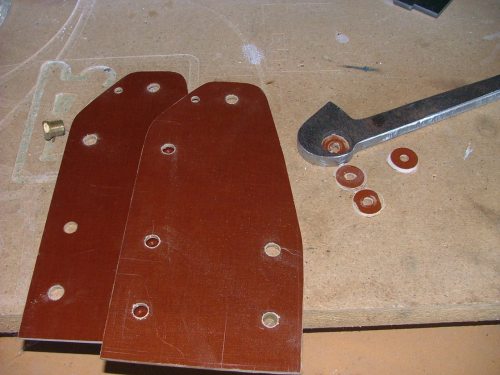

Posted: 10:13am 03 Jan 2008

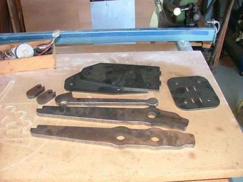

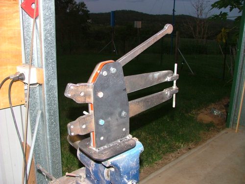

I drew up and lasercut parts for the spot welder "pincher" today. The parts were cut from 12mm and 5mm steel plate.
Once I got the parts home, I used the side plates as templates to cut some 3mm fibreboard. The laser can cut this stuff, but its messy and leaves a carbon rich burnt edge. As this fibreboard was to be used as a insulator, I didn't want any carbon edges, so it was easier to cut the fibreboard manually. I also used a hole saw to make up some washers.
A bit of welding, and I put the bits together as a mock up to make sure it will work. Looks good.
The lever at the top is to clamp the tips together, I need to add a sping at the back to pull the tips apart.

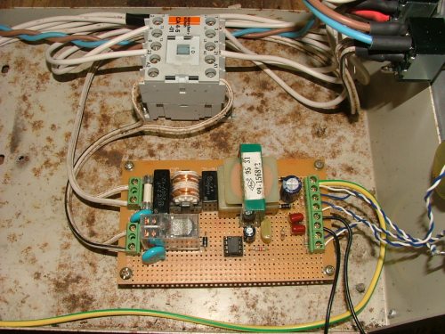

The circuit for mine will just consist of a one shot NE555 timer with a duration adjustment on the front case. This will switch a contactor in series with the transformer. The transformer itself has two primary windings ( actually they were the secondary windings when it was a UPS ), If I connect them in series I get just over 2.1 volts on the secondary, in parallel I get 4.2. I'll use a Hi Low switch so I can change between the two combinations. I figure with the Hi Low switch and timer I should be able to adjust the machine for any thickness up to say 1mm plate.

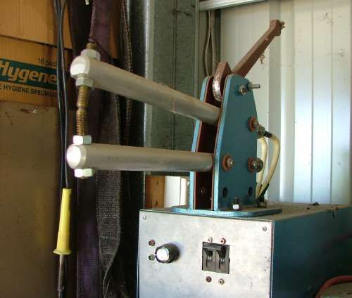

Posted: 09:46am 08 Jan 2008
Thanks for the links Peter.

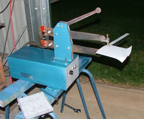

Finished the welder today. Made a foot switch from some 1mm zinc plate and a couple of DSE switches.
Below is the circuit, I need to draw it up. It uses a NE555 as the timer. I had to add a lot of spike protection, the back emf from the contactor and transformer was causing false triggering. I still need to tidy up the wires with cable ties.
The finished machine.

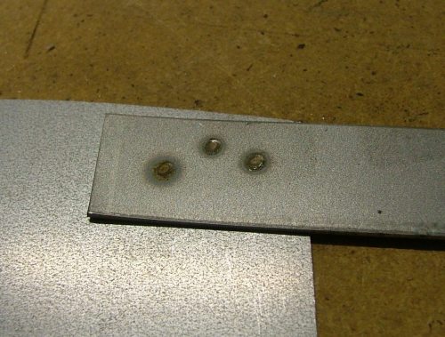

And some test welds, 1mm zinc plate.
I do need to replace the steel arms with aluminium, the steel gets very warm after a couple of welds, and this means I'm loosing a lot of the available energy in the arms.

Great job as usual. How strong is the "connection" between plates? Maybe the schematic will have his page on info/projects ?

Posted: 03:18pm 12 Jan 2008
May I suggest not to bother with alu arms as your results will even then still lack 'ummph'.
Try to get some suitable size flat braid copper and connect it directly to the back of the tip electrodes.
As was mentioned elsewhere in this thread, resistance in the wrong places kills a spot welder.
Ideally, you want 99.99% of the resistance at what's clamped between the electrodes.
Commercial small spot welders I used (years ago) had about 25mm dia copper rod for the pincer arms, one even had the arms water cooled.

Posted: 12:20pm 14 Jan 2008
Thanks for the input guys. Tinker I already converted it over to aluminum arms before I read your post, bugger. I used two lengths of 25mm dia aluminum, big improvement.
But the project is on hold for a week or two, got a few jobs needing my attention. I had to change the air conditioner evaporator in my car, what a job, took all weekend to remove the entire dash and climate control unit. Would have been easier to change the engine spark plugs via the exhaust tail pipe.
Back to the welder, I was having problems with the 555 timer circuit, false triggering and unreliable duration, I think a lot of its from the back emf and slow response of the contactor, so I'm replacing the contactor with a couple of Triacs. Also kept blowing 10 amp fuses, I need to get some slow blow types.
Will let you know when I get back to it.

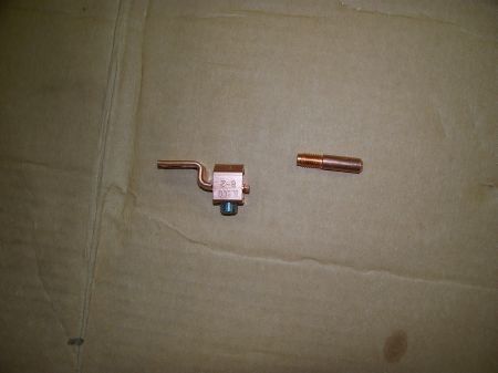

Posted: 05:02am 28 Jan 2008
Hi All, First post here
I took this today:
The poster ate my first two post attempts, so I'll just put this up and go for more content later...
(edit)
Ah, figured it out. Anyways, yeah - my spot welder will emphasise a short low-resistance path to the electrodes, and as much copper as possible in the secondary winding.
I couldn't get that blue beast in there for even a second turn, so the plan is so strip out the multicore bundles (of which there are 19) comprising the cable core, select about half of the bundles, wrap that in vinyl tape / shrinkwrap, then stick that in the transformer.
I suppose I could try to make the new cable flat instead of round to aid in winding... not sure, these are early days.
Edited by maestro19 2008-01-29

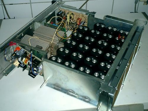

After procrastinating for a few years I got inspired by this thread to finally build a capacitor-discharge spotwelder. My previous spotwelder, built around a microwave transformer, wasn't a big succes, but the CD welder is !
http://www.anotherpower.com/gallery/album92
It basically consists of a large bank (1.564 F) of capacitors that gets discharged through the workpiece via a large thyristor (SCR). The sudden flow of high current heats up the joints enough to make a weld.
It was originally only intended to weld thin (0.003-0.005") nickel strips to batteries, to make and rebuild my own batterypacks for powertools. But to my surprise I find I can weld stainless steel up to a thickness of 3 mm too...
Full schematics, construction pictures, etc. can be found in the above link. Please notice that it's not entirely finished, I still need to make a decent front plate for it. But it's technically 100% functional as it is. Also, I'm at the moment building some extras to make it more userfriendly, such as handtweezer-electrodes. A footpedal (old one from a sewing machine) makes a very handy trigger (removes the need for a 3rd hand).
Next project will be another transformer-based spotwelder, but this time much more beefier.
Maybe it has given someone on this forum an idea on what to do with that box of capacitors sitting in the corner of the shop... :)
Peter.
