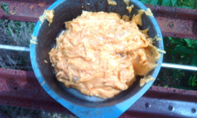

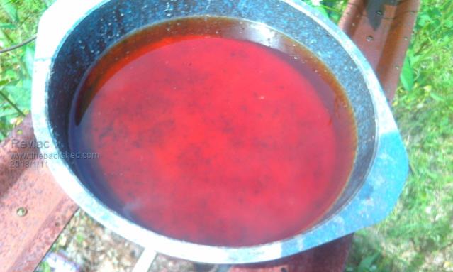

Posted: 12:14pm 11 Jan 2018
NOPE ITS NOT A LARGE CAT CRAP!
Its some of the worst looking greasy used oil I have.
Left it in the sun all day and it cleared up at around 30 degrees C.
Cheers Aaron

Posted: 01:47pm 11 Jan 2018
After many years of Doing this, I can tell you that's not all that bad. Cleared up pretty nice from my POV.
The problem here is most likely not fat in the oil, it's water.
To test, put it on the stove and heat. It will bubble and when the bubbles stop it starts to smoke. It will be dry enough by then. Let it cool and it will stay liquid. Filter it and you will have something entirely different to what you are seeing now.
You can clean any oil up. It's just a matter of getting the water and particles out. Everything after that is just oil.
Don't really matter what colour it is, any darkening is just microscopic particles that you cannot remove same as engine oil.
If the oil has a lot of fat in it, let it settle a month or so in a cool place and the oil will be on top and the fat on the bottom. In reality though the overall percentage of fat is very low unless lard was specifically mixed in. Cooking still only puts a relatively small fat percentage in the oil.
As you are in Oz and it's summer, the fat don't matter anyway. As long as it's liquid it's good fuel with a high energy content.
I have put melted fat in my car in summer and driven it and had no problems and I did not have any fuel heaters. The oil is warm returning from the engine and the heat of a summers day is way more than enough to keep DRY fat liquid.
You don't have to get pedantic with purging etc at the end of the day, just throw in a good amount of oil to dilute any remaining fats and that's all you need to do.
If there is plenty of liquid oil, time the fats start to block the filter on restart the engine and underbonnet temps will have warmed up enough to melt it out again. Ran my car for years like that while everyone else was in a panic about purging and fuel heating.
