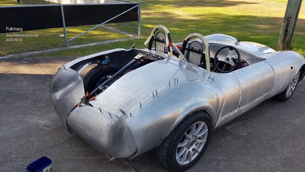

Hi all, I have previously had two unregistered EVs for grass roots motorsport. But now Motor Sport Australia is having a hissy fit about EVs so I can't use one there. So I decided to start again and this time make a road registered EV. It is to be themed off the Porsche 550 Spyder made famous as the car James Dean died in. Here is the target: ![]() This is where mine is up to: ![]() ![]() Obviously I am forced to make some changes partly to satisfy the legal requirements and partly to make it achievable. I started in March 2021 so I am fairly pleased with my progress so far. I am targeting March 2023 to have it on the road. |

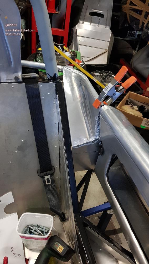

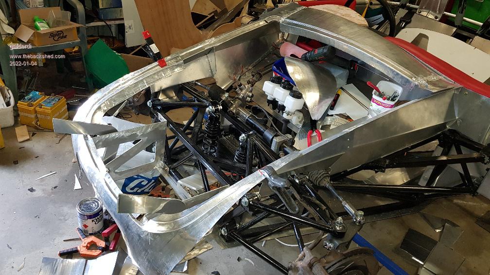

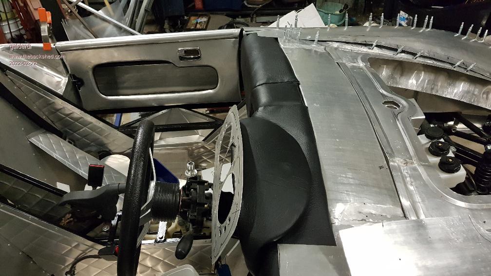

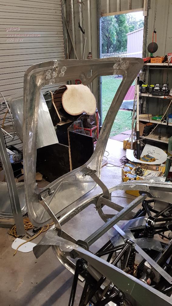

| galderdi Regular Member Joined: 12/08/2016 Location: AustraliaPosts: 99 |

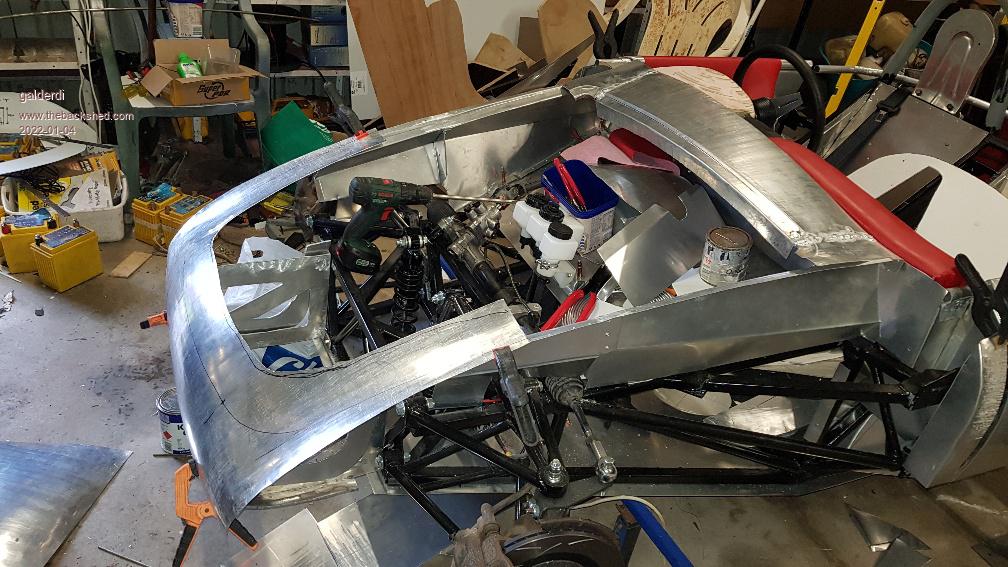

Here is the latest on my door. It isn't attached just yet but you get the idea. ![]() |
| Davo99 Guru Joined: 03/06/2019 Location: AustraliaPosts: 1586 |
You made/ modified that yourself? DAMN impressive! You clearly haven't done your trade as a panel beater in the last 10 Years. All they know how to do is unbolt something and replace it now. When they ring wreckers, not only want the suitable Panels, they want them in the right colour with a perfect paint job. None of the Johhny come latelys would have the skill or patience for real and quality work like this. Hard enough finding a Painter that can actually paint. Brilliant Job! |
